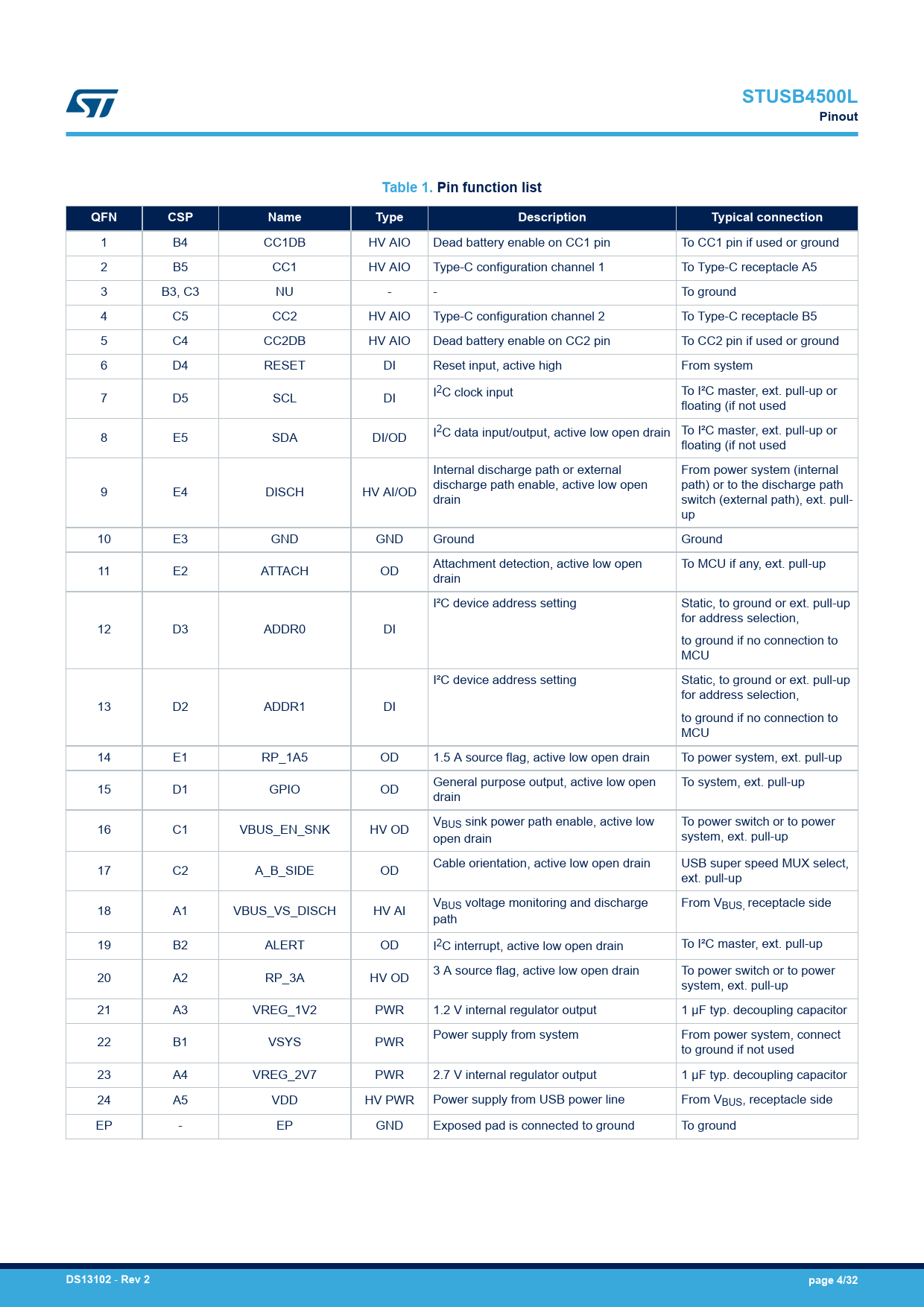

Pages / Page32 / 4 — STUSB4500L. Pinout. Table 1. Pin function list. QFN. CSP. Name. Type. …
STUSB4500L. Pinout. Table 1. Pin function list. QFN. CSP. Name. Type. Description. Typical connection. DS13102. Rev 2. page 4/32
STUSB4500L Pinout Table 1 Pin function list QFN CSP Name Type Description Typical connection DS13102 Rev 2 page 4/32
STUSB4500L Pinout Table 1. Pin function list QFN CSP Name Type Description Typical connection
1 B4 CC1DB HV AIO Dead battery enable on CC1 pin To CC1 pin if used or ground 2 B5 CC1 HV AIO Type-C configuration channel 1 To Type-C receptacle A5 3 B3, C3 NU - - To ground 4 C5 CC2 HV AIO Type-C configuration channel 2 To Type-C receptacle B5 5 C4 CC2DB HV AIO Dead battery enable on CC2 pin To CC2 pin if used or ground 6 D4 RESET DI Reset input, active high From system 7 D5 SCL DI I2C clock input To I²C master, ext. pull-up or floating (if not used 8 E5 SDA DI/OD I2C data input/output, active low open drain To I²C master, ext. pull-up or floating (if not used Internal discharge path or external From power system (internal discharge path enable, active low open path) or to the discharge path 9 E4 DISCH HV AI/OD drain switch (external path), ext. pull- up 10 E3 GND GND Ground Ground Attachment detection, active low open To MCU if any, ext. pull-up 11 E2 ATTACH OD drain I²C device address setting Static, to ground or ext. pull-up for address selection, 12 D3 ADDR0 DI to ground if no connection to MCU I²C device address setting Static, to ground or ext. pull-up for address selection, 13 D2 ADDR1 DI to ground if no connection to MCU 14 E1 RP_1A5 OD 1.5 A source flag, active low open drain To power system, ext. pull-up General purpose output, active low open To system, ext. pull-up 15 D1 GPIO OD drain V To power switch or to power 16 C1 VBUS_EN_SNK HV OD BUS sink power path enable, active low open drain system, ext. pull-up Cable orientation, active low open drain USB super speed MUX select, 17 C2 A_B_SIDE OD ext. pull-up V From V 18 A1 VBUS_VS_DISCH HV AI BUS voltage monitoring and discharge BUS, receptacle side path 19 B2 ALERT OD I2C interrupt, active low open drain To I²C master, ext. pull-up 3 A source flag, active low open drain To power switch or to power 20 A2 RP_3A HV OD system, ext. pull-up 21 A3 VREG_1V2 PWR 1.2 V internal regulator output 1 µF typ. decoupling capacitor Power supply from system From power system, connect 22 B1 VSYS PWR to ground if not used 23 A4 VREG_2V7 PWR 2.7 V internal regulator output 1 µF typ. decoupling capacitor 24 A5 VDD HV PWR Power supply from USB power line From VBUS, receptacle side EP - EP GND Exposed pad is connected to ground To ground
