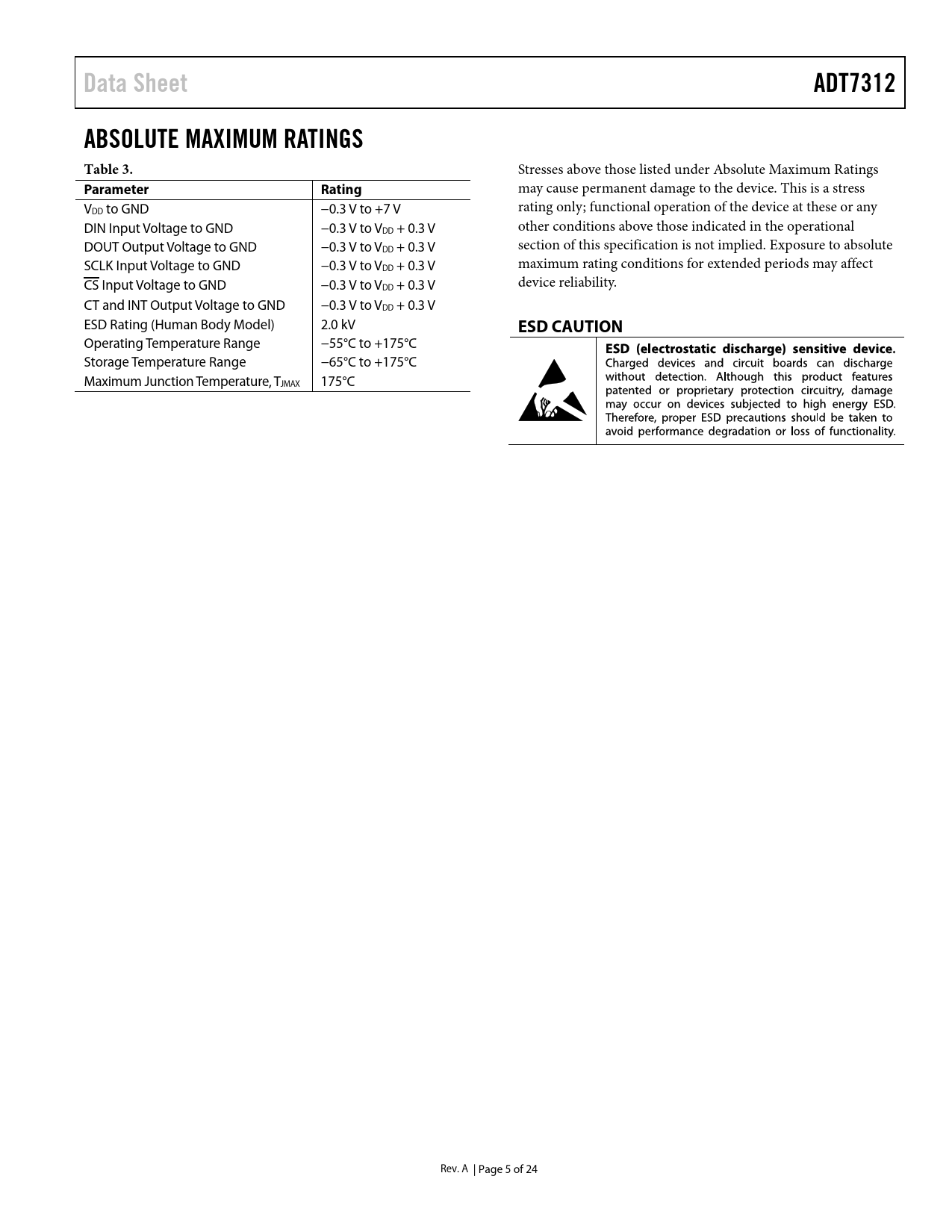

Data Sheet. ADT7312. ABSOLUTE MAXIMUM RATINGS Table 3. Parameter. Rating. ESD CAUTION
Data Sheet ADT7312 ABSOLUTE MAXIMUM RATINGS Table 3 Parameter Rating ESD CAUTION
Data Sheet ADT7312 ABSOLUTE MAXIMUM RATINGS Table 3.
Stresses above those listed under Absolute Maximum Ratings
Parameter Rating
may cause permanent damage to the device. This is a stress VDD to GND −0.3 V to +7 V rating only; functional operation of the device at these or any DIN Input Voltage to GND −0.3 V to VDD + 0.3 V other conditions above those indicated in the operational DOUT Output Voltage to GND −0.3 V to VDD + 0.3 V section of this specification is not implied. Exposure to absolute SCLK Input Voltage to GND −0.3 V to VDD + 0.3 V maximum rating conditions for extended periods may affect CS Input Voltage to GND −0.3 V to VDD + 0.3 V device reliability. CT and INT Output Voltage to GND −0.3 V to VDD + 0.3 V ESD Rating (Human Body Model) 2.0 kV
ESD CAUTION
Operating Temperature Range −55°C to +175°C Storage Temperature Range −65°C to +175°C Maximum Junction Temperature, TJMAX 175°C Rev. A | Page 5 of 24 Document Outline Features Applications General Description Product Highlights Functional Block Diagram Table of Contents Revision History Specifications SPI Timing Specifications Absolute Maximum Ratings ESD Caution Pad Configuration and Function Descriptions Die Bond Pad Coordinates Typical Performance Characteristics Theory of Operation Circuit Description Converter Architecture Normal Mode (Continuous Conversion Mode) One-Shot Mode CT and INT Operation in One-Shot Mode 1 SPS Mode Shutdown Mode Fault Queue Temperature Data Format Temperature Conversion Formulas 16-Bit Temperature Data Format 13-Bit Temperature Data Format 10-Bit Temperature Data Format 9-Bit Temperature Data Format Registers Status Register Configuration Register Temperature Value Register ID Register TCRIT Setpoint Register THYST Setpoint Register THIGH Setpoint Register TLOW Setpoint Register Serial Interface SPI Command Byte Writing Data Reading Data Interfacing to DSPs or Microcontrollers Resetting the Serial Interface INT and CT Outputs Undertemperature and Overtemperature Detection Comparator Mode Interrupt Mode Redundant Critical Generator Applications Information Thermal Response Time Supply Decoupling Powering from a Switching Regulator Temperature Monitoring Quick Guide to Measuring Temperature Outline Dimensions Ordering Guide Automotive Products
