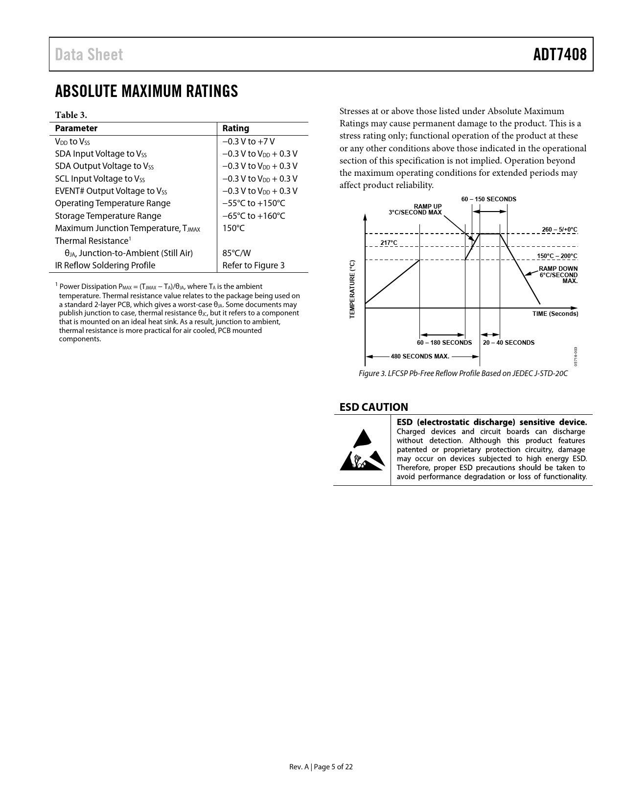

Data Sheet ADT7408 ABSOLUTE MAXIMUM RATINGS Table 3.
Stresses at or above those listed under Absolute Maximum Ratings may cause permanent damage to the product. This is a
Parameter Rating
stress rating only; functional operation of the product at these VDD to VSS −0.3 V to +7 V or any other conditions above those indicated in the operational SDA Input Voltage to VSS −0.3 V to VDD + 0.3 V section of this specification is not implied. Operation beyond SDA Output Voltage to VSS −0.3 V to VDD + 0.3 V the maximum operating conditions for extended periods may SCL Input Voltage to VSS −0.3 V to VDD + 0.3 V affect product reliability. EVENT# Output Voltage to VSS −0.3 V to VDD + 0.3 V
60 – 150 SECONDS
Operating Temperature Range −55°C to +150°C
RAMP UP
Storage Temperature Range −65°C to +160°C
3°C/SECOND MAX
Maximum Junction Temperature, TJMAX 150°C
260 – 5/+0°C
Thermal Resistance1
217°C
θJA, Junction-to-Ambient (Still Air) 85°C/W
150°C – 200°C
IR Reflow Soldering Profile Refer to Figure 3
C) RAMP DOWN E (° 6°C/SECOND R MAX.
1
U
Power Dissipation PMAX = (TJMAX − TA)/θJA, where TA is the ambient
T
temperature. Thermal resistance value relates to the package being used on a standard 2-layer PCB, which gives a worst-case θ
PERA
JA. Some documents may
M
publish junction to case, thermal resistance θJC, but it refers to a component
E T TIME (Seconds)
that is mounted on an ideal heat sink. As a result, junction to ambient, thermal resistance is more practical for air cooled, PCB mounted components.
60 – 180 SECONDS 20 – 40 SECONDS
3 00
480 SECONDS MAX.
716- 05 Figure 3. LFCSP Pb-Free Reflow Profile Based on JEDEC J-STD-20C
