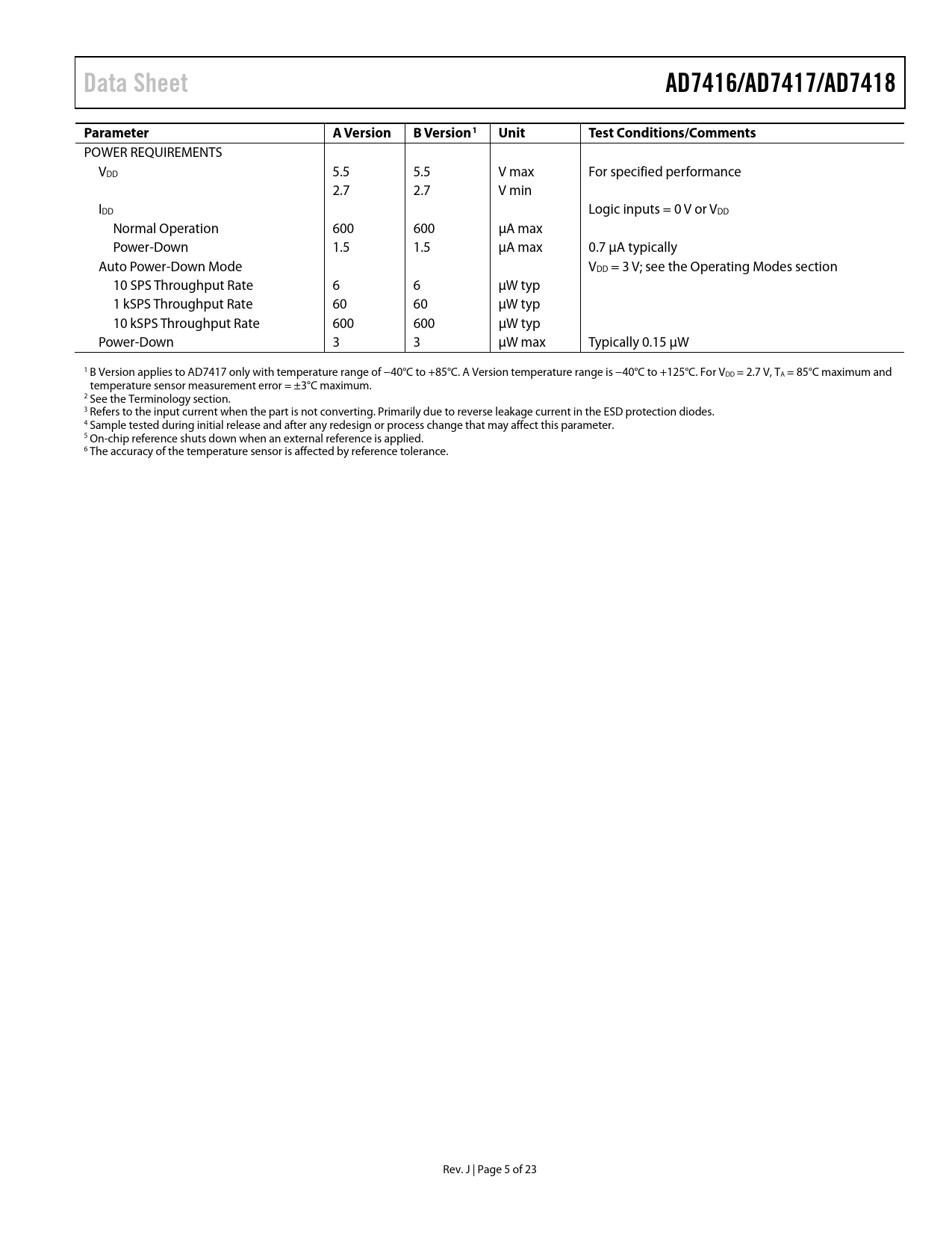

Data Sheet. AD7416/AD7417/AD7418. Parameter. A Version. B Version1. Unit. Test Conditions/Comments
Data Sheet AD7416/AD7417/AD7418 Parameter A Version B Version1 Unit Test Conditions/Comments
link to page 17 link to page 10 link to page 6
POWER REQUIREMENTS VDD 5.5 5.5 V max For specified performance 2.7 2.7 V min IDD Logic inputs = 0 V or VDD Normal Operation 600 600 μA max Power-Down 1.5 1.5 μA max 0.7 µA typically Auto Power-Down Mode VDD = 3 V; see the Operating Modes section 10 SPS Throughput Rate 6 6 μW typ 1 kSPS Throughput Rate 60 60 μW typ 10 kSPS Throughput Rate 600 600 μW typ Power-Down 3 3 μW max Typically 0.15 μW 1 B Version applies to AD7417 only with temperature range of −40°C to +85°C. A Version temperature range is −40°C to +125°C. For VDD = 2.7 V, TA = 85°C maximum and temperature sensor measurement error = ±3°C maximum. 2 See the Terminology section. 3 Refers to the input current when the part is not converting. Primarily due to reverse leakage current in the ESD protection diodes. 4 Sample tested during initial release and after any redesign or process change that may affect this parameter. 5 On-chip reference shuts down when an external reference is applied. 6 The accuracy of the temperature sensor is affected by reference tolerance. Rev. J | Page 5 of 23 Document Outline FEATURES APPLICATIONS GENERAL DESCRIPTION FUNCTIONAL BLOCK DIAGRAMS TABLE OF CONTENTS REVISION HISTORY PRODUCT HIGHLIGHTS SPECIFICATIONS AD7417/AD7418 SPECIFICATIONS AD7416 SPECIFICATIONS ABSOLUTE MAXIMUM RATINGS ESD CAUTION PIN CONFIGURATIONS AND FUNCTION DESCRIPTIONS TERMINOLOGY THEORY OF OPERATION CIRCUIT INFORMATION CONVERTER DETAILS TYPICAL CONNECTION DIAGRAM ANALOG INPUTS ON-CHIP REFERENCE TEMPERATURE MEASUREMENT INTERNAL REGISTER STRUCTURE Address Pointer Register Temperature Value Register (Address 0x00) Configuration Register (Address 0x01) THYST Setpoint Register (Address 0x02) TOTI Setpoint Register (Address 0x03) ADC Value Register (Address 0x04) ADC Transfer Function Config2 Register (Address 0x05) SERIAL BUS INTERFACE Serial Bus Address Writing to the AD7416/AD7417/AD7418 Reading Data From the AD7416/AD7417/AD7418 OTI OUTPUT FAULT QUEUE POWER-ON DEFAULTS OPERATING MODES Mode 1 Mode 2 CONVSTB START MODE CONVSTB Pin Mode APPLICATIONS INFORMATION SUPPLY DECOUPLING POWER-ON RESET MOUNTING THE AD7416/AD7417/AD7418 FAN CONTROLLER THERMOSTAT SYSTEM WITH MULTIPLE AD7416 DEVICES OUTLINE DIMENSIONS ORDERING GUIDE
