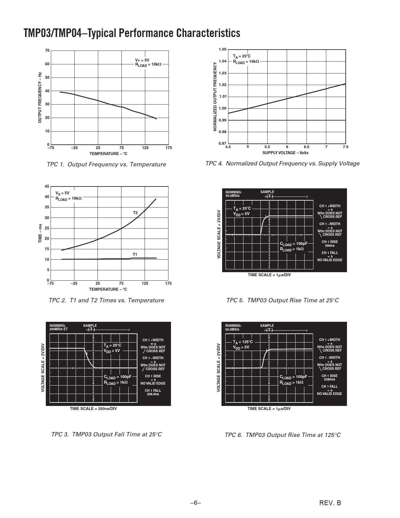

TMP03/TMP04–Typical Performance Characteristics. 1.05. TA = 25. V+ = 5V. 1.04. LOAD = 10k. UENCY 1.03. 1.02. UENCY – Hz. 1.01. 1.00
TMP03/TMP04–Typical Performance Characteristics 1.05 TA = 25 V+ = 5V 1.04 LOAD = 10k UENCY 1.03 1.02 UENCY – Hz 1.01 1.00
TMP03/TMP04–Typical Performance Characteristics 70 1.05 TA = 25 C V+ = 5V 1.04 R 60 R LOAD = 10k LOAD = 10k UENCY 1.03 50 1.02 40 UENCY – Hz 1.01 30 1.00 20 OUTPUT FREQ 0.99 10 NORMALIZED OUTPUT FREQ 0.98 0 0.97 –75 –25 25 75 125 175 4.5 5 5.5 6 6.5 7 7.5 TEMPERATURE – C SUPPLY VOLTAGE – Volts
TPC 1. Output Frequency vs. Temperature TPC 4. Normalized Output Frequency vs. Supply Voltage
45 V RUNNING: SAMPLE S = 5V 40 50.0MS/s ( T ) RLOAD = 10k 35 CH 1 +WIDTH TA = 25 C s T2 V Wfm DOES NOT DD = 5V 30 CROSS REF CH 1 –WIDTH ms 25 s Wfm DOES NOT CROSS REF 20 TIME C CH 1 RISE GE SCALE = 2V/DIV LOAD = 100pF 500ns 15 A T RLOAD = 1k CH 1 FALL T1 OL V s 10 NO VALID EDGE 5 TIME SCALE = 1 s/DIV 0 –75 –25 25 75 125 175 TEMPERATURE – C
TPC 2. T1 and T2 Times vs. Temperature TPC 5. TMP03 Output Rise Time at 25°C
RUNNING: SAMPLE RUNNING: SAMPLE 200MS/s ET ( T ) 50.0MS/s ( T ) CH 1 +WIDTH CH 1 +WIDTH TA = 125 C s T s A = 25 C Wfm DOES NOT V Wfm DOES NOT DD = 5V V CROSS REF DD = 5V CROSS REF CH 1 –WIDTH CH 1 –WIDTH s s Wfm DOES NOT Wfm DOES NOT CROSS REF CROSS REF C CH 1 RISE C CH 1 RISE GE SCALE = 2V/DIV LOAD = 100pF s GE SCALE = 2V/DIV LOAD = 100pF 5380ns A A T RLOAD = 1k NO VALID EDGE T RLOAD = 1k CH 1 FALL OL OL V CH 1 FALL V s 209.6ns NO VALID EDGE TIME SCALE = 250ns/DIV TIME SCALE = 1 s/DIV
TPC 3. TMP03 Output Fall Time at 25°C TPC 6. TMP03 Output Rise Time at 125 °C –6– REV. B REV. B REV. B Document Outline RevHistory_TMP03_04.pdf REVISION HISTORY
