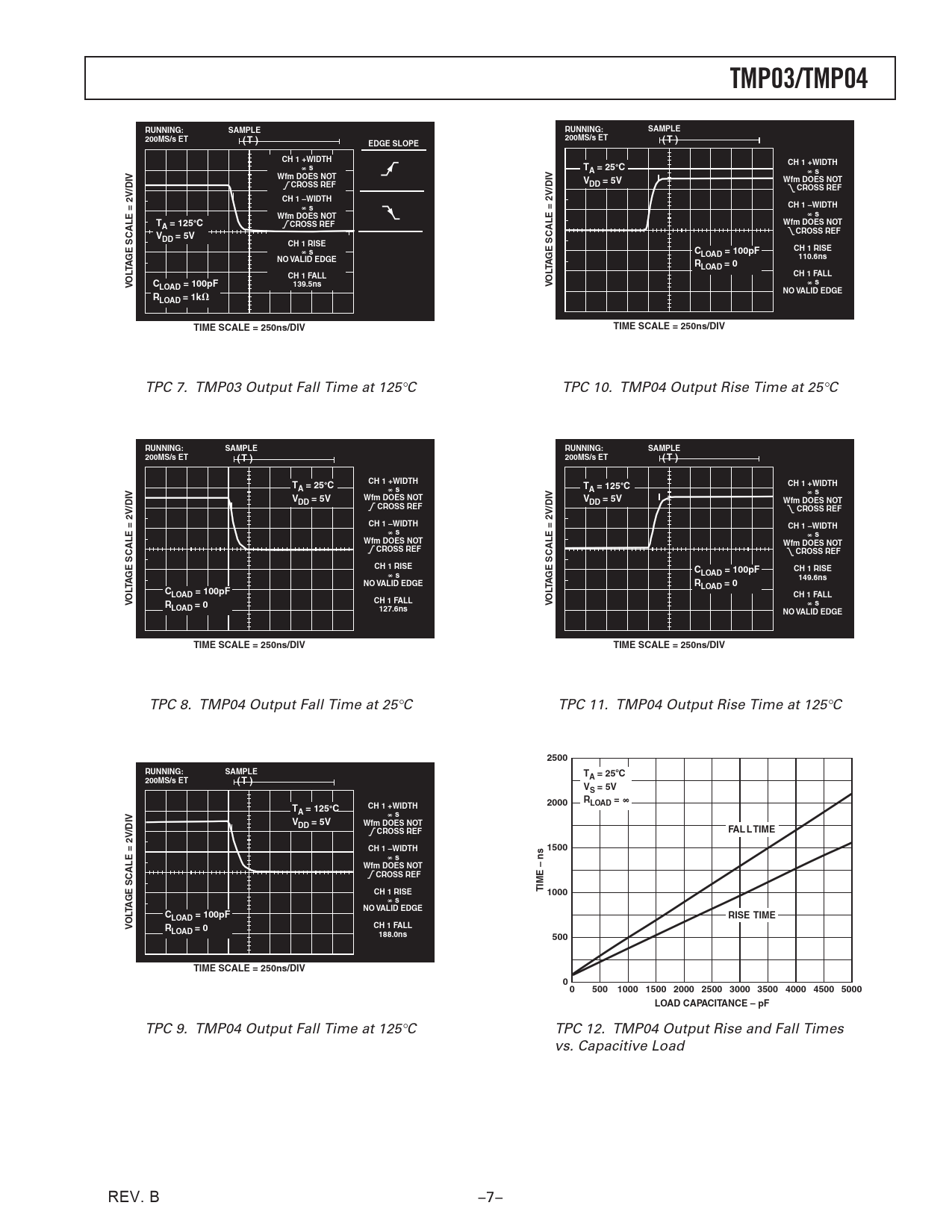

TMP03/TMP04. RUNNING:. SAMPLE. 200MS/s ET. ( T ). EDGE SLOPE. CH 1 +WIDTH. TA = 25 C. Wfm DOES NOT. CROSS REF. DD = 5V. CH 1 –WIDTH. A = 125 C
TMP03/TMP04 RUNNING: SAMPLE 200MS/s ET ( T ) EDGE SLOPE CH 1 +WIDTH TA = 25 C Wfm DOES NOT CROSS REF DD = 5V CH 1 –WIDTH A = 125 C
TMP03/TMP04 RUNNING: SAMPLE RUNNING: SAMPLE 200MS/s ET ( T ) 200MS/s ET ( T ) EDGE SLOPE CH 1 +WIDTH CH 1 +WIDTH s TA = 25 C s Wfm DOES NOT V Wfm DOES NOT CROSS REF DD = 5V CROSS REF CH 1 –WIDTH s CH 1 –WIDTH Wfm DOES NOT s T CROSS REF Wfm DOES NOT A = 125 C CROSS REF VDD = 5V CH 1 RISE CH 1 RISE s C GE SCALE = 2V/DIV LOAD = 100pF NO VALID EDGE GE SCALE = 2V/DIV 110.6ns A A T T RLOAD = 0 CH 1 FALL CH 1 FALL OL OL C 139.5ns V s LOAD = 100pF V NO VALID EDGE RLOAD = 1k TIME SCALE = 250ns/DIV TIME SCALE = 250ns/DIV
TPC 7. TMP03 Output Fall Time at 125°C TPC 10. TMP04 Output Rise Time at 25 °C
RUNNING: SAMPLE RUNNING: SAMPLE 200MS/s ET ( T ) 200MS/s ET ( T ) CH 1 +WIDTH T CH 1 +WIDTH A = 25 C T s A = 125 C s V Wfm DOES NOT DD = 5V VDD = 5V Wfm DOES NOT CROSS REF CROSS REF CH 1 –WIDTH CH 1 –WIDTH s s Wfm DOES NOT Wfm DOES NOT CROSS REF CROSS REF CH 1 RISE C CH 1 RISE GE SCALE = 2V/DIV s GE SCALE = 2V/DIV LOAD = 100pF A A 149.6ns T NO VALID EDGE T RLOAD = 0 C OL LOAD = 100pF OL CH 1 FALL V R CH 1 FALL V s LOAD = 0 127.6ns NO VALID EDGE TIME SCALE = 250ns/DIV TIME SCALE = 250ns/DIV
TPC 8. TMP04 Output Fall Time at 25°C TPC 11. TMP04 Output Rise Time at 125°C
2500 RUNNING: SAMPLE T 200MS/s ET ( T ) A = 25 C VS = 5V R 2000 LOAD = T CH 1 +WIDTH A = 125 C s VDD = 5V Wfm DOES NOT CROSS REF FAL L TIME CH 1 –WIDTH 1500 s ns Wfm DOES NOT CROSS REF CH 1 RISE TIME 1000 GE SCALE = 2V/DIV s A T NO VALID EDGE C RISE TIME OL LOAD = 100pF V R CH 1 FALL LOAD = 0 188.0ns 500 TIME SCALE = 250ns/DIV 0 0 500 1000 1500 2000 2500 3000 3500 4000 4500 5000 LOAD CAPACITANCE – pF
TPC 9. TMP04 Output Fall Time at 125°C TPC 12. TMP04 Output Rise and Fall Times vs. Capacitive Load REV. B –7– REV. B Document Outline RevHistory_TMP03_04.pdf REVISION HISTORY
