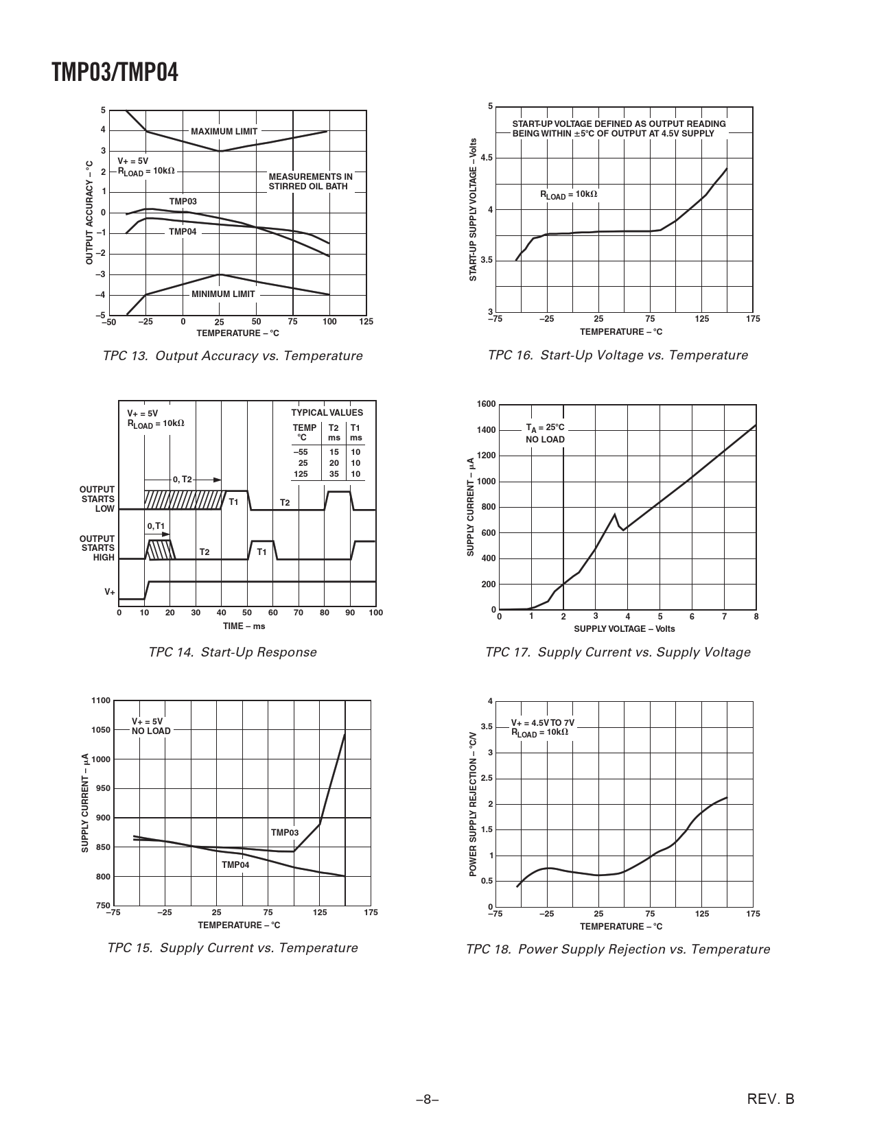

TMP03/TMP04. START-UP VOLTAGE DEFINED AS OUTPUT READING. MAXIMUM LIMIT. BEING WITHIN. C OF OUTPUT AT 4.5V SUPPLY. olts V. V+ = 5V
TMP03/TMP04 START-UP VOLTAGE DEFINED AS OUTPUT READING MAXIMUM LIMIT BEING WITHIN C OF OUTPUT AT 4.5V SUPPLY olts V V+ = 5V
TMP03/TMP04 5 5 START-UP VOLTAGE DEFINED AS OUTPUT READING 4 MAXIMUM LIMIT BEING WITHIN 5 C OF OUTPUT AT 4.5V SUPPLY 3 olts V V+ = 5V – 4.5 C – 2 RLOAD = 10k MEASUREMENTS IN GE A CY STIRRED OIL BATH T 1 OL RLOAD = 10k TMP03 V Y 0 4 CCURA –1 TMP04 –2 T-UP SUPPL OUTPUT A 3.5 AR –3 ST –4 MINIMUM LIMIT –5 3 –50 –25 0 25 50 75 100 125 –75 –25 25 75 125 175 TEMPERATURE – C TEMPERATURE – C
TPC 13. Output Accuracy vs. Temperature TPC 16. Start-Up Voltage vs. Temperature
1600 V+ = 5V TYPICAL VALUES RLOAD = 10k TEMP T2 T1 T 1400 A = 25 C C ms ms NO LOAD –55 15 10 1200 25 20 10 A 125 35 10 0, T2 1000 OUTPUT STARTS T1 T2 LOW 800 0, T1 Y CURRENT 600 OUTPUT STARTS T2 T1 HIGH SUPPL 400 200 V+ 0 10 20 30 40 50 60 70 80 90 100 0 0 1 2 3 4 5 6 7 8 TIME – ms SUPPLY VOLTAGE – Volts
TPC 14. Start-Up Response TPC 17. Supply Current vs. Supply Voltage
1100 4 V+ = 5V V+ = 4.5V TO 7V 1050 3.5 NO LOAD RLOAD = 10k C/V 3 A 1000 2.5 950 2 Y REJECTION 900 Y CURRENT TMP03 1.5 SUPPL 850 1 TMP04 WER SUPPL 800 PO 0.5 750 0 –75 –25 25 75 125 175 –75 –25 25 75 125 175 TEMPERATURE – C TEMPERATURE – C
TPC 15. Supply Current vs. Temperature TPC 18. Power Supply Rejection vs. Temperature –8– REV. B REV. B Document Outline RevHistory_TMP03_04.pdf REVISION HISTORY
