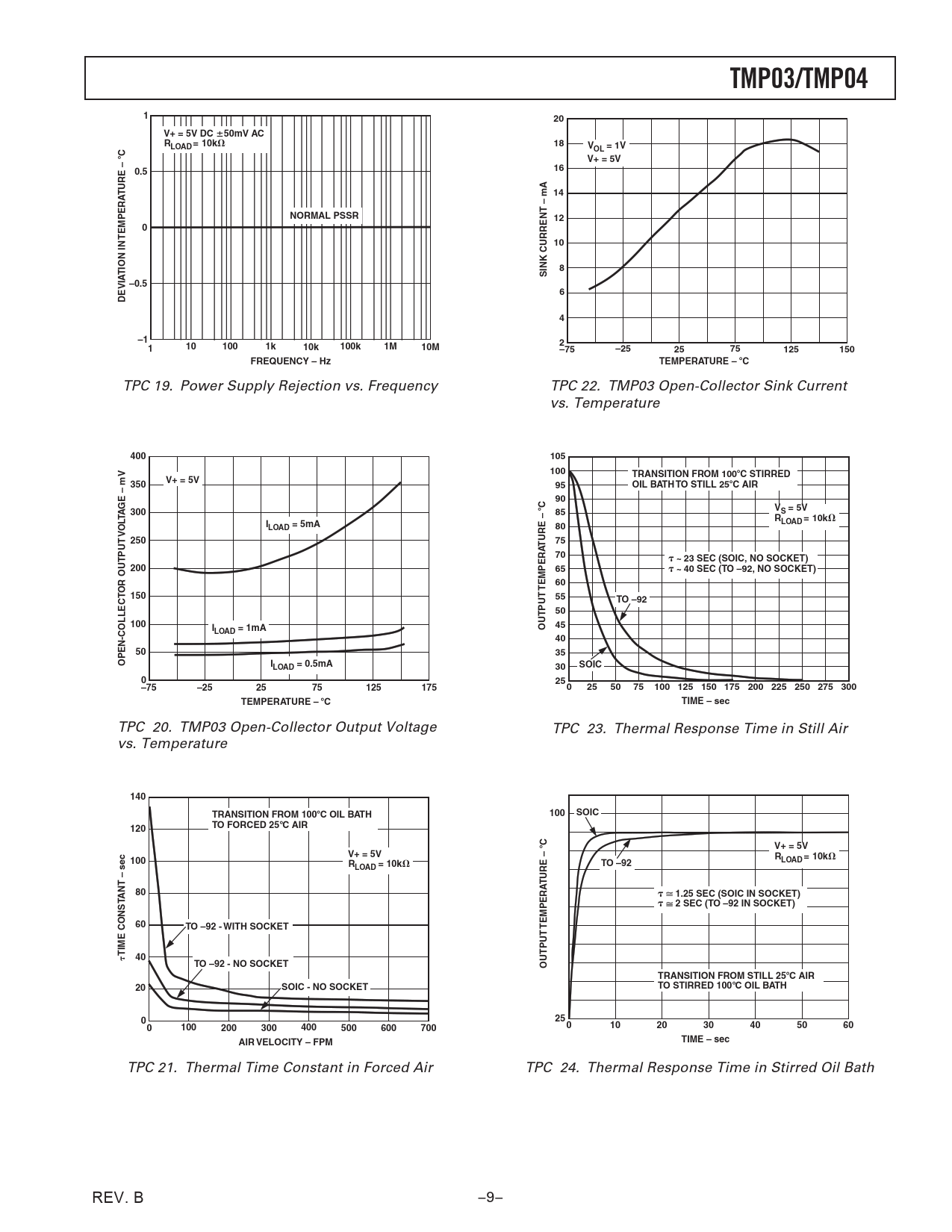

TMP03/TMP04. V+ = 5V DC. 50mV AC R. LOAD = 10k. VOL = 1V. V+ = 5V. 0.5. TURE. mA 14. NORMAL PSSR. TEMPERA. TION IN. SINK CURRENT. –0.5. DEVIA. 100. 10k
TMP03/TMP04 V+ = 5V DC 50mV AC R LOAD = 10k VOL = 1V V+ = 5V 0.5 TURE mA 14 NORMAL PSSR TEMPERA TION IN SINK CURRENT –0.5 DEVIA 100 10k
TMP03/TMP04 1 20 V+ = 5V DC 50mV AC R 18 LOAD = 10k VOL = 1V C V+ = 5V 0.5 16 TURE mA 14 NORMAL PSSR 12 0 TEMPERA 10 TION IN 8 SINK CURRENT –0.5 6 DEVIA 4 –1 2 1 10 100 1k 10k 100k 1M 10M –75 –25 25 75 125 150 FREQUENCY – Hz TEMPERATURE – C
TPC 19. Power Supply Rejection vs. Frequency TPC 22. TMP03 Open-Collector Sink Current vs. Temperature
400 105 100 TRANSITION FROM 100 C STIRRED V+ = 5V mV 350 95 OIL BATH TO STILL 25 C AIR 90 GE C A V 85 S = 5V T 300 RLOAD = 10k OL ILOAD = 5mA 80 V 250 TURE 75 70 ~ 23 SEC (SOIC, NO SOCKET) 200 65 ~ 40 SEC (TO –92, NO SOCKET) 60 OR OUTPUT TEMPERA 150 55 TO –92 50 100 I 45 LOAD = 1mA OUTPUT 40 50 35 OPEN-COLLECT ILOAD = 0.5mA 30 SOIC 0 25 –75 –25 25 75 125 175 0 25 50 75 100 125 150 175 200 225 250 275 300 TEMPERATURE – C TIME – sec
TPC 20. TMP03 Open-Collector Output Voltage TPC 23. Thermal Response Time in Still Air vs. Temperature
140 TRANSITION FROM 100 C OIL BATH 100 SOIC 120 TO FORCED 25 C AIR C V+ = 5V V+ = 5V R 100 LOAD = 10k R TO –92 sec LOAD = 10k TURE ANT 80 1.25 SEC (SOIC IN SOCKET) 2 SEC (TO –92 IN SOCKET) CONST 60 TO –92 - WITH SOCKET TEMPERA TIME 40 TO –92 - NO SOCKET OUTPUT TRANSITION FROM STILL 25 C AIR 20 SOIC - NO SOCKET TO STIRRED 100 C OIL BATH 0 25 0 100 200 300 400 500 600 700 0 10 20 30 40 50 60 AIR VELOCITY – FPM TIME – sec
TPC 21. Thermal Time Constant in Forced Air TPC 24. Thermal Response Time in Stirred Oil Bath REV. B –9– REV. B REV. B Document Outline RevHistory_TMP03_04.pdf REVISION HISTORY
