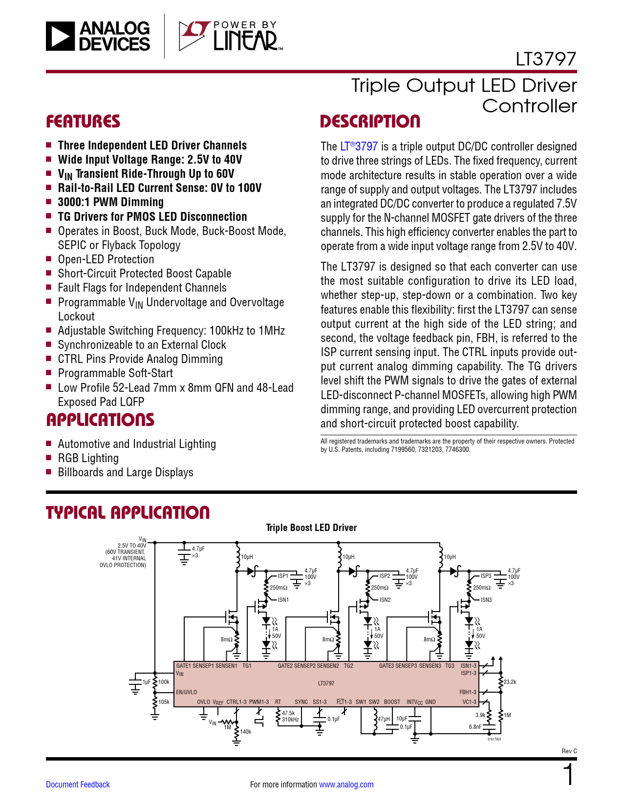

TYPICAL APPLICATION Triple Boost LED Driver
VIN 2.5V TO 40V 4.7µF (60V TRANSIENT, ×3 41V INTERNAL 10µH 10µH 10µH OVLO PROTECTION) 4.7µF 4.7µF 4.7µF ISP1 100V ISP2 100V ISP3 100V ×3 ×3 ×3 250mΩ 250mΩ 250mΩ ISN1 ISN2 ISN3 1A 1A 1A 50V 50V 50V 8mΩ 8mΩ 8mΩ GATE1 SENSEP1 SENSEN1 TG1 GATE2 SENSEP2 SENSEN2 TG2 GATE3 SENSEP3 SENSEN3 TG3 ISN1-3 VIN ISP1-3 1µF 100k 23.2k LT3797 EN/UVLO FBH1-3 105k OVLO VREF CTRL1-3 PWM1-3 RT SYNC SS1-3 FLT1-3 SW1 SW2 BOOST INTVCC GND VC1-3 47.5k 3.9k 1M V 310kHz 0.1µF 47µH 10µF IN 1M 0.1µF 6.8nF 140k 3797 TA01 Rev C Document Feedback For more information www.analog.com 1 Document Outline Features Applications Description Typical Application Absolute Maximum Ratings Pin Configuration Electrical Characteristics Typical Performance Characteristics Pin Functions Block Diagram Operation Applications Information Revision History Typical Application Related Parts Features Applications Typical Application Description Absolute Maximum Ratings Pin Configuration Order Information Electrical Characteristics Typical Performance Characteristics Pin Functions Block Diagram Operation Applications Information Typical Applications Package Description Revision History Typical Application Related Parts
