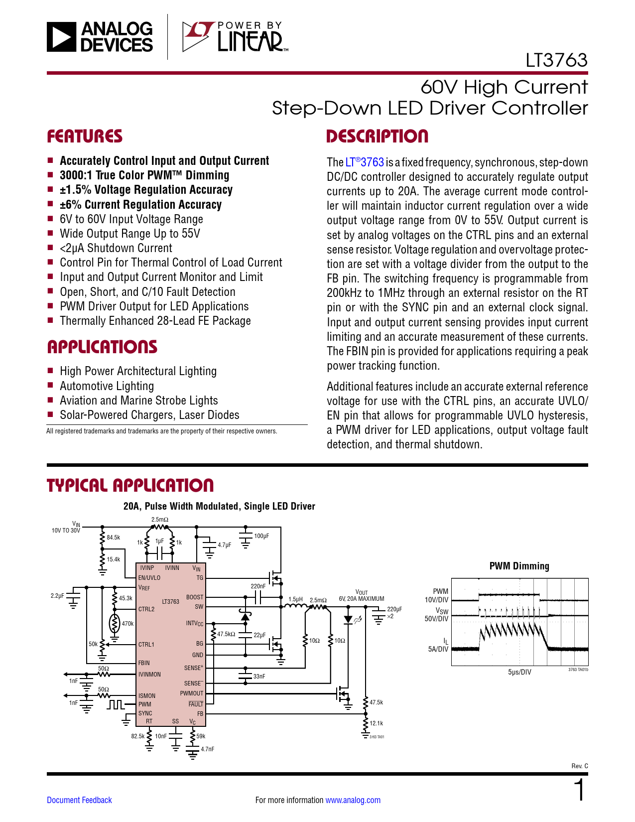

FEATURES. DESCRIPTION. Accurately Control Input and Output Current. 3000:1 True Color PWM™ Dimming
Datasheet LT3763 Analog Devices, Revision: C
LT3763 60V High Current Step-Down LED Driver Controller
FEATURES DESCRIPTION
n
The LT®3763 is a fixed frequency, synchronous, step-down n
DC/DC controller designed to accurately regulate output n
±1.5% Voltage Regulation Accuracy
currents up to 20A. The average current mode control- n
±6% Current Regulation Accuracy
ler will maintain inductor current regulation over a wide n 6V to 60V Input Voltage Range output voltage range from 0V to 55V. Output current is n Wide Output Range Up to 55V set by analog voltages on the CTRL pins and an external n <2µA Shutdown Current sense resistor. Voltage regulation and overvoltage protec- n Control Pin for Thermal Control of Load Current tion are set with a voltage divider from the output to the n Input and Output Current Monitor and Limit FB pin. The switching frequency is programmable from n Open, Short, and C/10 Fault Detection 200kHz to 1MHz through an external resistor on the RT n PWM Driver Output for LED Applications pin or with the SYNC pin and an external clock signal. n Thermally Enhanced 28-Lead FE Package Input and output current sensing provides input current limiting and an accurate measurement of these currents.
APPLICATIONS
The FBIN pin is provided for applications requiring a peak n power tracking function. High Power Architectural Lighting n Automotive Lighting Additional features include an accurate external reference n Aviation and Marine Strobe Lights voltage for use with the CTRL pins, an accurate UVLO/ n Solar-Powered Chargers, Laser Diodes EN pin that allows for programmable UVLO hysteresis, All registered trademarks and trademarks are the property of their respective owners. a PWM driver for LED applications, output voltage fault detection, and thermal shutdown.
TYPICAL APPLICATION 20A, Pulse Width Modulated, Single LED Driver
2.5mΩ VIN 10V TO 30V 100µF 84.5k 1k 1µF 1k 4.7µF 15.4k IVINP IVINN VIN
