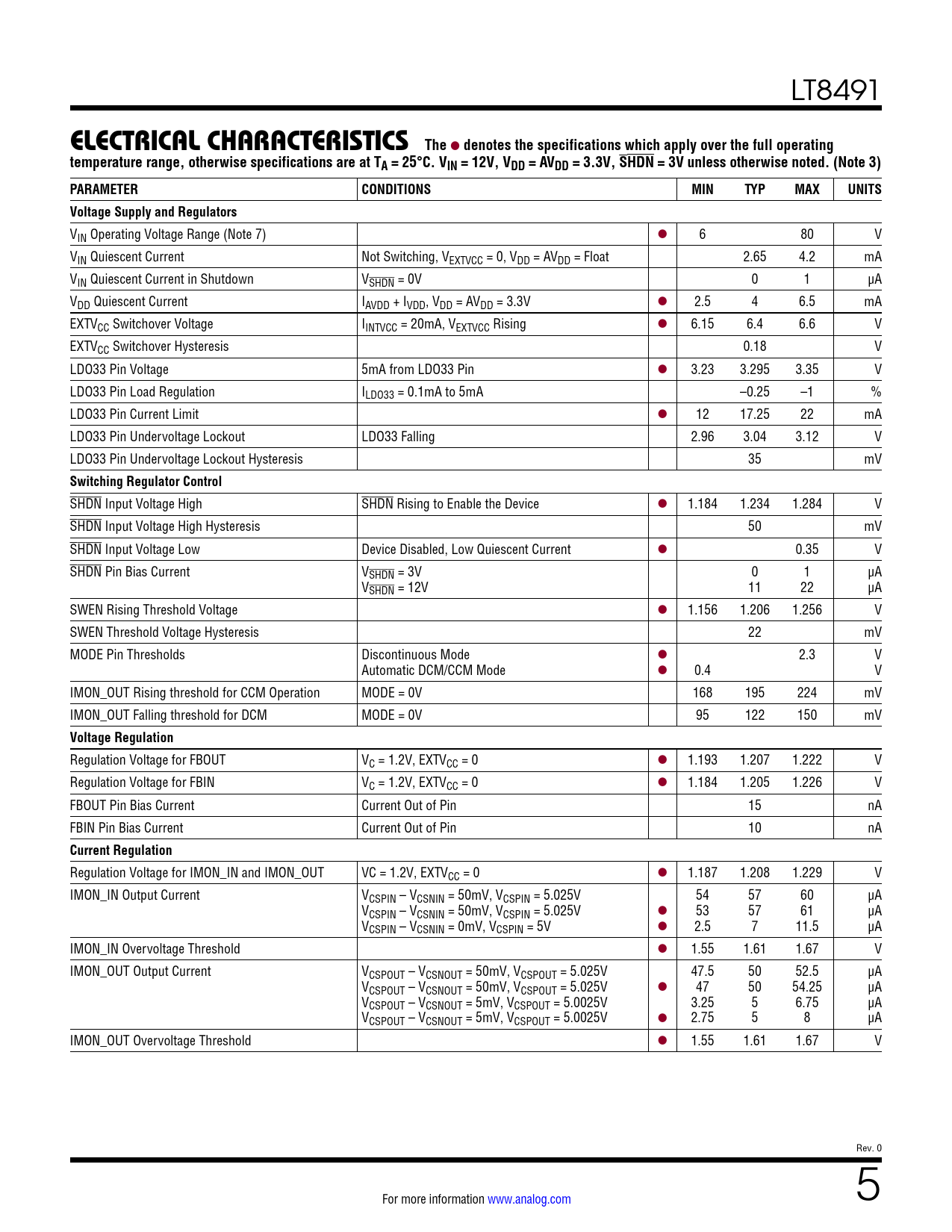

DescriptionHigh Voltage Buck-Boost Battery Charge Controller with Maximum Power Point Tracking (MPPT) and I2C
Pages / Page82 / 5 — ELECTRICAL CHARACTERISTICS. The. denotes the specifications which apply …
LT8491
l
denotes the specifications which apply over the full operating temperature range, otherwise specifications are at TA = 25°C. VIN = 12V, VDD = AVDD = 3.3V, SHDN = 3V unless otherwise noted. (Note 3) PARAMETER CONDITIONS MIN TYP MAX UNITS Voltage Supply and Regulators
VIN Operating Voltage Range (Note 7) l 6 80 V VIN Quiescent Current Not Switching, VEXTVCC = 0, VDD = AVDD = Float 2.65 4.2 mA VIN Quiescent Current in Shutdown VSHDN = 0V 0 1 µA VDD Quiescent Current IAVDD + IVDD, VDD = AVDD = 3.3V l 2.5 4 6.5 mA EXTVCC Switchover Voltage IINTVCC = 20mA, VEXTVCC Rising l 6.15 6.4 6.6 V EXTVCC Switchover Hysteresis 0.18 V LDO33 Pin Voltage 5mA from LDO33 Pin l 3.23 3.295 3.35 V LDO33 Pin Load Regulation ILDO33 = 0.1mA to 5mA –0.25 –1 % LDO33 Pin Current Limit l 12 17.25 22 mA LDO33 Pin Undervoltage Lockout LDO33 Falling 2.96 3.04 3.12 V LDO33 Pin Undervoltage Lockout Hysteresis 35 mV
Switching Regulator Control
SHDN Input Voltage High SHDN Rising to Enable the Device l 1.184 1.234 1.284 V SHDN Input Voltage High Hysteresis 50 mV SHDN Input Voltage Low Device Disabled, Low Quiescent Current l 0.35 V SHDN Pin Bias Current VSHDN = 3V 0 1 µA VSHDN = 12V 11 22 µA SWEN Rising Threshold Voltage l 1.156 1.206 1.256 V SWEN Threshold Voltage Hysteresis 22 mV MODE Pin Thresholds Discontinuous Mode l 2.3 V Automatic DCM/CCM Mode l 0.4 V IMON_OUT Rising threshold for CCM Operation MODE = 0V 168 195 224 mV IMON_OUT Falling threshold for DCM MODE = 0V 95 122 150 mV
Voltage Regulation
Regulation Voltage for FBOUT VC = 1.2V, EXTVCC = 0 l 1.193 1.207 1.222 V Regulation Voltage for FBIN VC = 1.2V, EXTVCC = 0 l 1.184 1.205 1.226 V FBOUT Pin Bias Current Current Out of Pin 15 nA FBIN Pin Bias Current Current Out of Pin 10 nA
