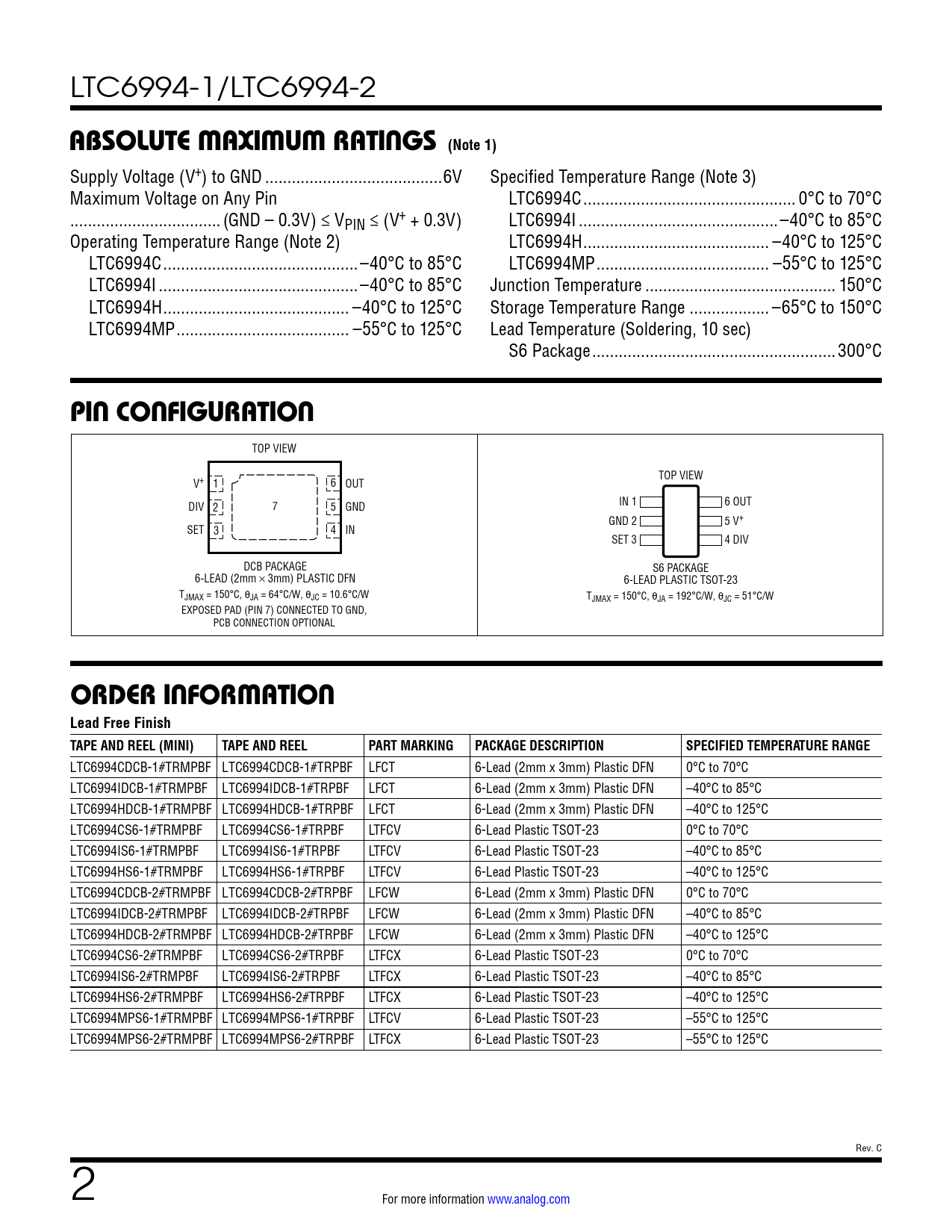

ABSOLUTE MAXIMUM RATINGS (Note 1). PIN CONFIGURATION. ORDER INFORMATION Lead Free Finish TAPE AND REEL (MINI). TAPE AND REEL
ABSOLUTE MAXIMUM RATINGS (Note 1) PIN CONFIGURATION ORDER INFORMATION Lead Free Finish TAPE AND REEL (MINI) TAPE AND REEL
LTC6994-1/LTC6994-2
Supply Voltage (V+) to GND ..6V Specified Temperature Range (Note 3) Maximum Voltage on Any Pin LTC6994C .. 0°C to 70°C .. (GND – 0.3V) ≤ VPIN ≤ (V+ + 0.3V) LTC6994I ...–40°C to 85°C Operating Temperature Range (Note 2) LTC6994H .. –40°C to 125°C LTC6994C ..–40°C to 85°C LTC6994MP ... –55°C to 125°C LTC6994I ...–40°C to 85°C Junction Temperature ... 150°C LTC6994H .. –40°C to 125°C Storage Temperature Range .. –65°C to 150°C LTC6994MP ... –55°C to 125°C Lead Temperature (Soldering, 10 sec) S6 Package ...300°C
PIN CONFIGURATION
TOP VIEW TOP VIEW V+ 1 6 OUT DIV 2 7 5 GND IN 1 6 OUT GND 2 5 V+ SET 3 4 IN SET 3 4 DIV DCB PACKAGE S6 PACKAGE 6-LEAD (2mm × 3mm) PLASTIC DFN 6-LEAD PLASTIC TSOT-23 TJMAX = 150°C, θJA = 64°C/W, θJC = 10.6°C/W TJMAX = 150°C, θJA = 192°C/W, θJC = 51°C/W EXPOSED PAD (PIN 7) CONNECTED TO GND, PCB CONNECTION OPTIONAL
ORDER INFORMATION Lead Free Finish TAPE AND REEL (MINI) TAPE AND REEL PART MARKING PACKAGE DESCRIPTION SPECIFIED TEMPERATURE RANGE
LTC6994CDCB-1#TRMPBF LTC6994CDCB-1#TRPBF LFCT 6-Lead (2mm x 3mm) Plastic DFN 0°C to 70°C LTC6994IDCB-1#TRMPBF LTC6994IDCB-1#TRPBF LFCT 6-Lead (2mm x 3mm) Plastic DFN –40°C to 85°C LTC6994HDCB-1#TRMPBF LTC6994HDCB-1#TRPBF LFCT 6-Lead (2mm x 3mm) Plastic DFN –40°C to 125°C LTC6994CS6-1#TRMPBF LTC6994CS6-1#TRPBF LTFCV 6-Lead Plastic TSOT-23 0°C to 70°C LTC6994IS6-1#TRMPBF LTC6994IS6-1#TRPBF LTFCV 6-Lead Plastic TSOT-23 –40°C to 85°C LTC6994HS6-1#TRMPBF LTC6994HS6-1#TRPBF LTFCV 6-Lead Plastic TSOT-23 –40°C to 125°C LTC6994CDCB-2#TRMPBF LTC6994CDCB-2#TRPBF LFCW 6-Lead (2mm x 3mm) Plastic DFN 0°C to 70°C LTC6994IDCB-2#TRMPBF LTC6994IDCB-2#TRPBF LFCW 6-Lead (2mm x 3mm) Plastic DFN –40°C to 85°C LTC6994HDCB-2#TRMPBF LTC6994HDCB-2#TRPBF LFCW 6-Lead (2mm x 3mm) Plastic DFN –40°C to 125°C LTC6994CS6-2#TRMPBF LTC6994CS6-2#TRPBF LTFCX 6-Lead Plastic TSOT-23 0°C to 70°C LTC6994IS6-2#TRMPBF LTC6994IS6-2#TRPBF LTFCX 6-Lead Plastic TSOT-23 –40°C to 85°C LTC6994HS6-2#TRMPBF LTC6994HS6-2#TRPBF LTFCX 6-Lead Plastic TSOT-23 –40°C to 125°C LTC6994MPS6-1#TRMPBF LTC6994MPS6-1#TRPBF LTFCV 6-Lead Plastic TSOT-23 –55°C to 125°C LTC6994MPS6-2#TRMPBF LTC6994MPS6-2#TRPBF LTFCX 6-Lead Plastic TSOT-23 –55°C to 125°C Rev. C 2 For more information www.analog.com Document Outline Features Applications Typical Application Description Absolute Maximum Ratings Pin Configuration Order Information Electrical Characteristics Typical Performance Characteristics Pin Functions Block Diagram Operation Applications Information Typical Applications Package Description Revision History Typical Application Related Parts
