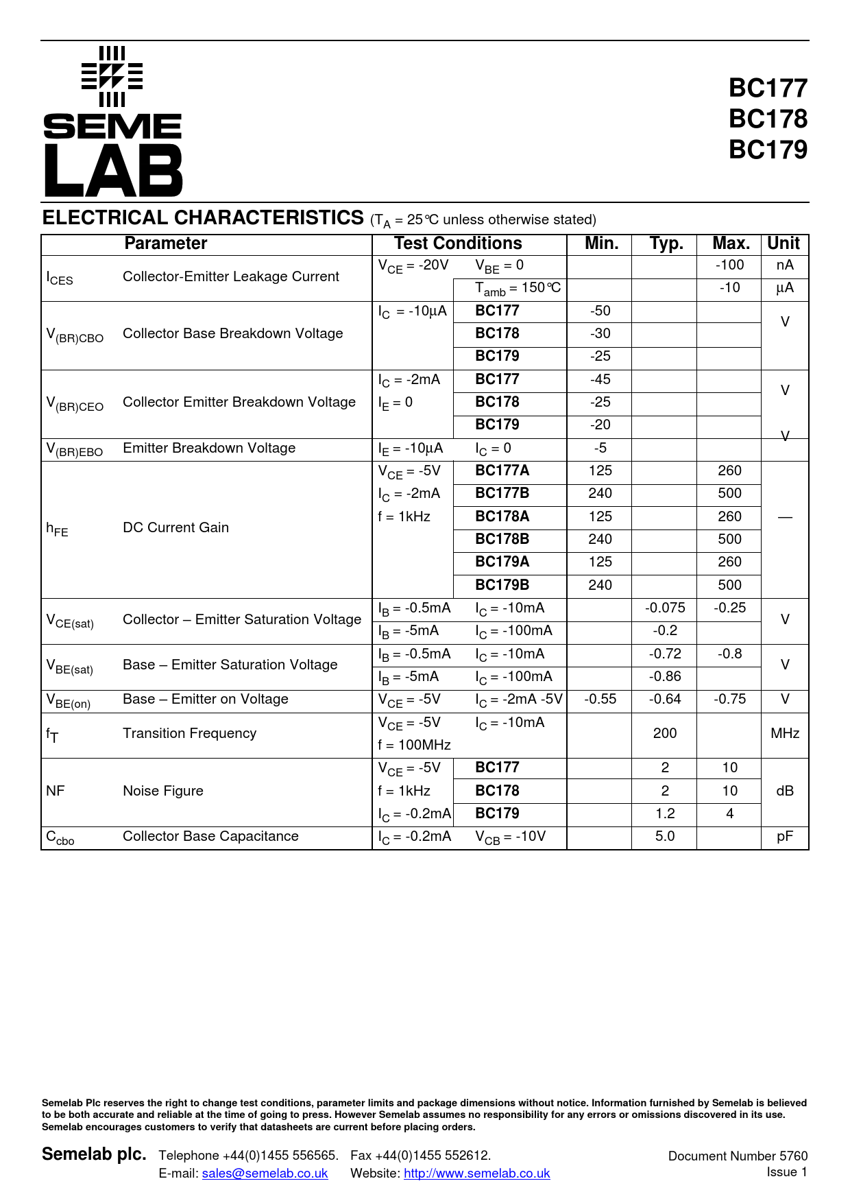

BC177 BC178 BC179. ELECTRICAL CHARACTERISTICS. Parameter. Test Conditions. Min. Typ. Max. Unit. BC177. BC178. BC179. BC177A. BC177B. BC178A. BC178B
BC177 BC178 BC179 ELECTRICAL CHARACTERISTICS Parameter Test Conditions Min Typ Max Unit BC177 BC178 BC179 BC177A BC177B BC178A BC178B
(TA = 25°C unless otherwise stated)
Parameter Test Conditions Min. Typ. Max. Unit
VCE = -20V VBE = 0 -100 nA ICES Collector-Emitter Leakage Current T µ amb = 150°C -10 A IC = -10µA
BC177
-50 V V
BC178
(BR)CBO Collector Base Breakdown Voltage -30
BC179
-25 IC = -2mA
BC177
-45 V V I (BR)CEO Collector Emitter Breakdown Voltage E = 0
BC178
-25
BC179
-20 V V I (BR)EBO Emitter Breakdown Voltage E = -10µA IC = 0 -5 VCE = -5V
BC177A
125 260 IC = -2mA
BC177B
240 500 f = 1kHz
BC178A
125 260 — hFE DC Current Gain
BC178B
240 500
BC179A
125 260
BC179B
240 500 IB = -0.5mA IC = -10mA -0.075 -0.25 VCE(sat) Collector – Emitter Saturation Voltage V IB = -5mA IC = -100mA -0.2 IB = -0.5mA IC = -10mA -0.72 -0.8 VBE(sat) Base – Emitter Saturation Voltage V IB = -5mA IC = -100mA -0.86 V V BE(on) Base – Emitter on Voltage CE = -5V IC = -2mA -5V -0.55 -0.64 -0.75 V VCE = -5V IC = -10mA fT Transition Frequency 200 MHz f = 100MHz VCE = -5V
BC177
2 10 NF Noise Figure f = 1kHz
BC178
2 10 dB IC = -0.2mA
BC179
1.2 4 C I cbo Collector Base Capacitance C = -0.2mA VCB = -10V 5.0 pF
