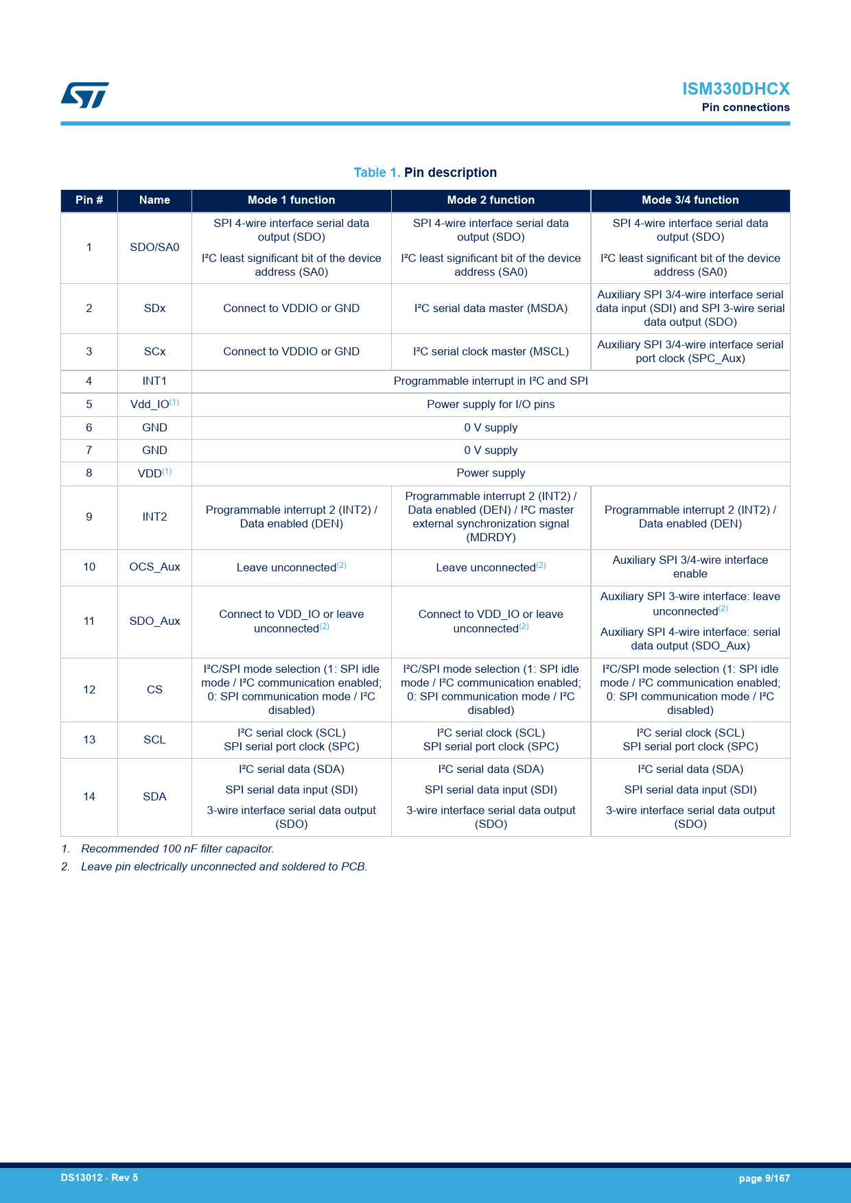

ISM330DHCX. Pin connections. Table 1. Pin description. Pin #. Name. Mode 1 function. Mode 2 function. Mode 3/4 function. DS13012. Rev 5
link to page 9 link to page 9 link to page 9 link to page 9 link to page 9 link to page 9 link to page 9
ISM330DHCX Pin connections Table 1. Pin description Pin # Name Mode 1 function Mode 2 function Mode 3/4 function
SPI 4-wire interface serial data SPI 4-wire interface serial data SPI 4-wire interface serial data output (SDO) output (SDO) output (SDO) 1 SDO/SA0 I²C least significant bit of the device I²C least significant bit of the device I²C least significant bit of the device address (SA0) address (SA0) address (SA0) Auxiliary SPI 3/4-wire interface serial 2 SDx Connect to VDDIO or GND I²C serial data master (MSDA) data input (SDI) and SPI 3-wire serial data output (SDO) Auxiliary SPI 3/4-wire interface serial 3 SCx Connect to VDDIO or GND I²C serial clock master (MSCL) port clock (SPC_Aux) 4 INT1 Programmable interrupt in I²C and SPI 5 Vdd_IO(1) Power supply for I/O pins 6 GND 0 V supply 7 GND 0 V supply 8 VDD(1) Power supply Programmable interrupt 2 (INT2) / Programmable interrupt 2 (INT2) / Data enabled (DEN) / I²C master Programmable interrupt 2 (INT2) / 9 INT2 Data enabled (DEN) external synchronization signal Data enabled (DEN) (MDRDY) Auxiliary SPI 3/4-wire interface 10 OCS_Aux Leave unconnected(2) Leave unconnected(2) enable Auxiliary SPI 3-wire interface: leave Connect to VDD_IO or leave Connect to VDD_IO or leave unconnected(2) 11 SDO_Aux unconnected(2) unconnected(2) Auxiliary SPI 4-wire interface: serial data output (SDO_Aux) I²C/SPI mode selection (1: SPI idle I²C/SPI mode selection (1: SPI idle I²C/SPI mode selection (1: SPI idle mode / I²C communication enabled; mode / I²C communication enabled; mode / I²C communication enabled; 12 CS 0: SPI communication mode / I²C 0: SPI communication mode / I²C 0: SPI communication mode / I²C disabled) disabled) disabled) I²C serial clock (SCL) I²C serial clock (SCL) I²C serial clock (SCL) 13 SCL SPI serial port clock (SPC) SPI serial port clock (SPC) SPI serial port clock (SPC) I²C serial data (SDA) I²C serial data (SDA) I²C serial data (SDA) SPI serial data input (SDI) SPI serial data input (SDI) SPI serial data input (SDI) 14 SDA 3-wire interface serial data output 3-wire interface serial data output 3-wire interface serial data output (SDO) (SDO) (SDO) 1. Recommended 100 nF filter capacitor. 2. Leave pin electrically unconnected and soldered to PCB.
DS13012
Rev 5 page 9/167
