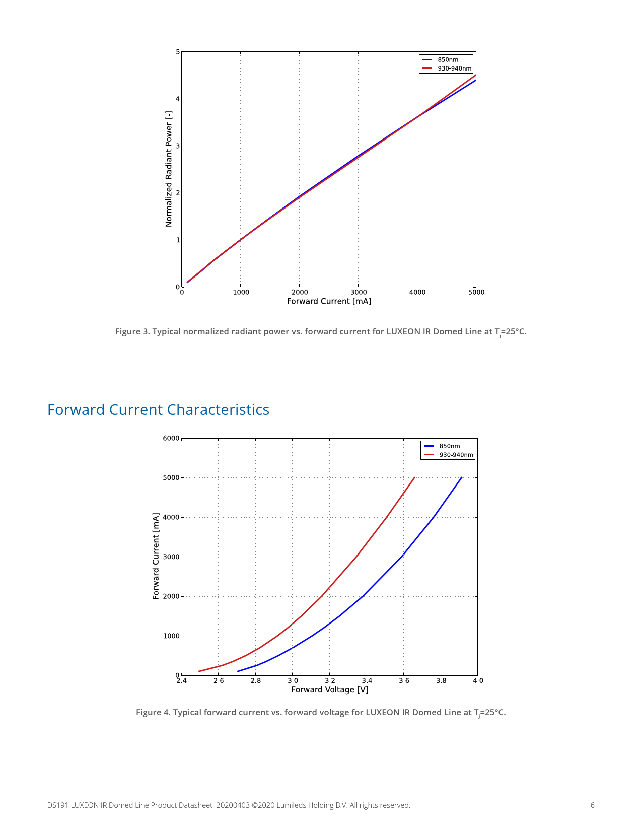

Figure 3. Typical normalized radiant power vs. forward current for LUXEON IR Domed Line at T =25°C
Figure 3. Typical normalized radiant power vs. forward current for LUXEON IR Domed Line at T =25°C . j
Forward Current Characteristics
Figure 4. Typical forward current vs. forward voltage for LUXEON IR Domed Line at T =25°C . j
