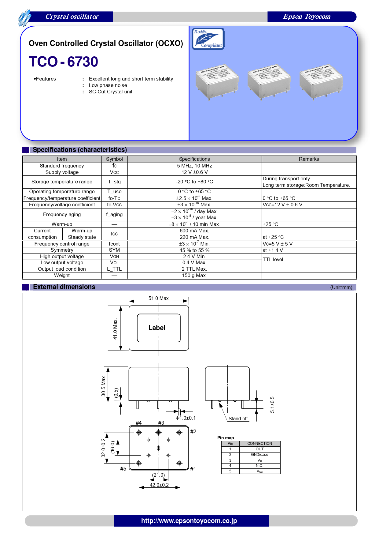

Crystal oscillator Epson Toyocom Oven Controlled Crystal Oscillator (OCXO) TCO -6730. •Features :
Datasheet TCO-6730 Toycom
•Features :
: Excellent long and short term stability
Low phase noise
SC-Cut Crystal unit Specifications (characteristics)
Item
Standard frequency
Supply voltage Symbol
VCC Specifications
5 MHz, 10 MHz
12 V ±0.6 V Storage temperature range T_stg -20 °C to +80 °C Operating temperature range
Frequency/temperature coefficient
Frequency/voltage coefficient T_use
fo-TC
fo-VCC Frequency aging f_aging Warm-up
Current
Warm-up
consumption
Steady state
Frequency control range
Symmetry
High output voltage
Low output voltage
Output load condition
Weight -0 °C to +65 °C
-9
±2.5 × 10 Max.
-10
±3 × 10 Max.
-10
±2 × 10 / day Max.
-8
±3 × 10 / year Max.
-8
±8 × 10 / 10 min Max.
600 mA Max.
220 mA Max.
-7
±3 × 10 Min.
45 % to 55 %
2.4 V Min.
0.4 V Max.
2 TTL Max.
150 g Max. f0 ICC
fcont
SYM
VOH
VOL
L_TTL
-Remarks During transport only.
Long term storage:Room Temperature.
0 °C to +65 °C
VCC=12 V ± 0.6 V +25 °C
at +25 °C
VC=5 V ± 5 V
at +1.4 V
TTL level External dimensions (Unit:mm) Label 5.1±0.5 (0.5) 30.5 Max. 41.0 Max. 51.0 Max. #4 #3 Φ1.0±0.1 Stand off Pin map (16.0) 32.0±0.2 #2 #5
(21.0) #1 Pin
1 CONNECTION
OUT 2 GND/case 3
4
5 VC
N.C.
VCC 42.0±0.2 http://www.epsontoyocom.co.jp
