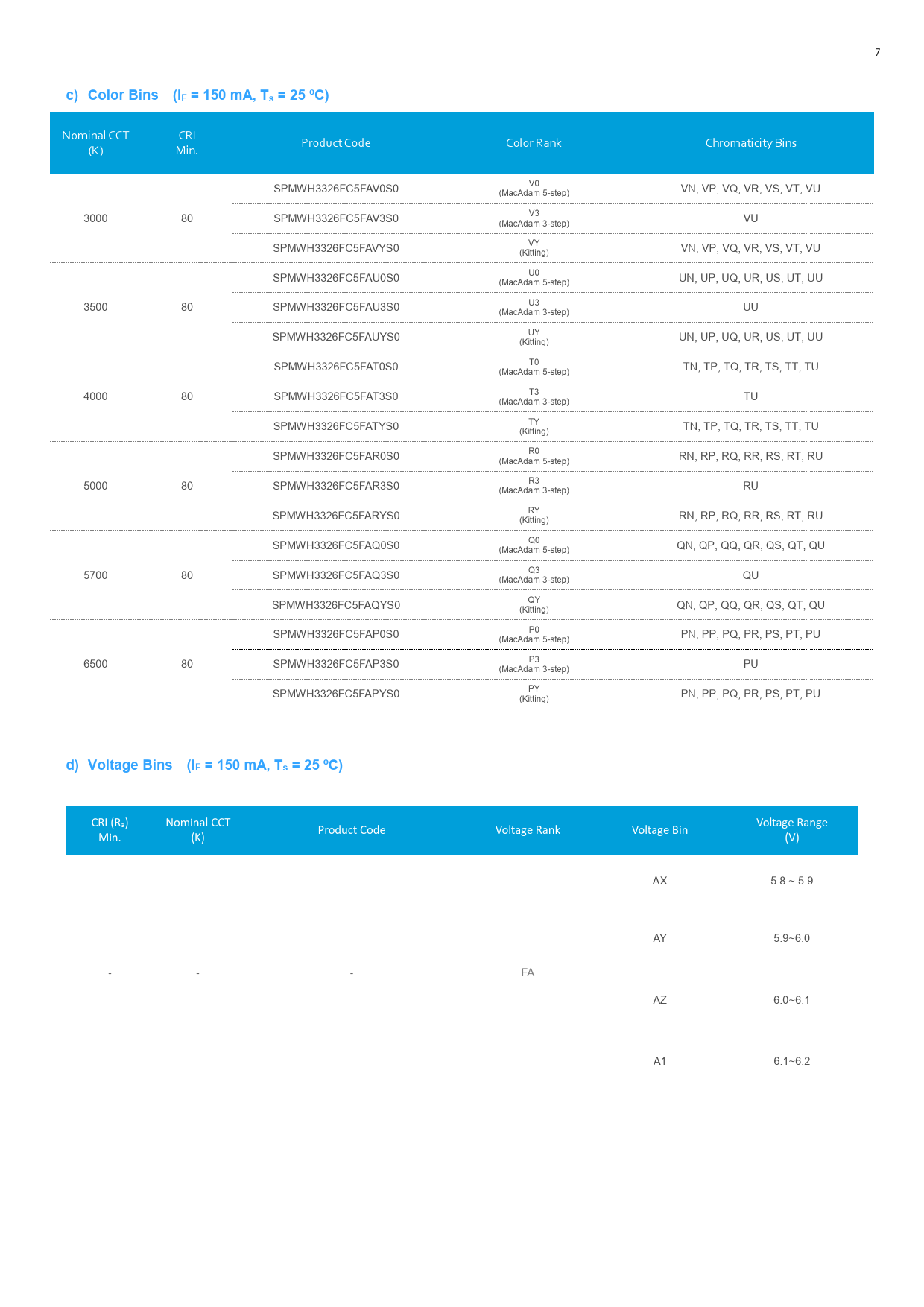

c) Color Bins (IF = 150 mA, Ts = 25 ºC). d) Voltage Bins (IF = 150 mA, Ts = 25 ºC)
7
Nominal CCT CRI Product Code Color Rank Chromaticity Bins (K) Min. SPMWH3326FC5FAV0S0 V0 (MacAdam 5-step) VN, VP, VQ, VR, VS, VT, VU 3000 80 SPMWH3326FC5FAV3S0 V3 (MacAdam 3-step) VU SPMWH3326FC5FAVYS0 VY (Kitting) VN, VP, VQ, VR, VS, VT, VU SPMWH3326FC5FAU0S0 U0 (MacAdam 5-step) UN, UP, UQ, UR, US, UT, UU 3500 80 SPMWH3326FC5FAU3S0 U3 (MacAdam 3-step) UU SPMWH3326FC5FAUYS0 UY (Kitting) UN, UP, UQ, UR, US, UT, UU SPMWH3326FC5FAT0S0 T0 (MacAdam 5-step) TN, TP, TQ, TR, TS, TT, TU 4000 80 SPMWH3326FC5FAT3S0 T3 (MacAdam 3-step) TU SPMWH3326FC5FATYS0 TY (Kitting) TN, TP, TQ, TR, TS, TT, TU SPMWH3326FC5FAR0S0 R0 (MacAdam 5-step) RN, RP, RQ, RR, RS, RT, RU 5000 80 SPMWH3326FC5FAR3S0 R3 (MacAdam 3-step) RU SPMWH3326FC5FARYS0 RY (Kitting) RN, RP, RQ, RR, RS, RT, RU SPMWH3326FC5FAQ0S0 Q0 (MacAdam 5-step) QN, QP, QQ, QR, QS, QT, QU 5700 80 SPMWH3326FC5FAQ3S0 Q3 (MacAdam 3-step) QU SPMWH3326FC5FAQYS0 QY (Kitting) QN, QP, QQ, QR, QS, QT, QU SPMWH3326FC5FAP0S0 P0 (MacAdam 5-step) PN, PP, PQ, PR, PS, PT, PU 6500 80 SPMWH3326FC5FAP3S0 P3 (MacAdam 3-step) PU SPMWH3326FC5FAPYS0 PY (Kitting) PN, PP, PQ, PR, PS, PT, PU
CRI (Ra) Nominal CCT Min. (K) Product Code Voltage Rank Voltage Bin Voltage Range (V) AX 5.8 ~ 5.9 AY 5.9~6.0 - - - FA AZ 6.0~6.1 A1 6.1~6.2
