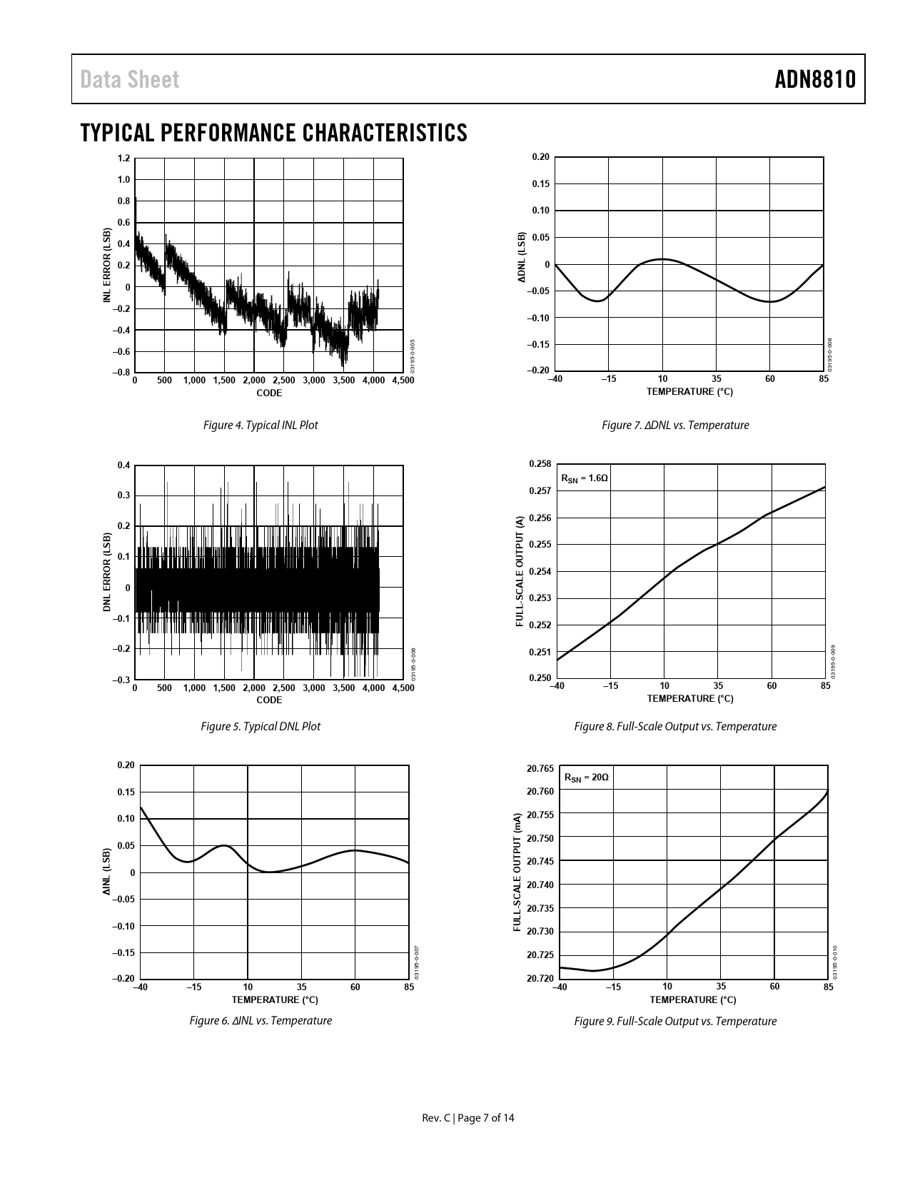

Data Sheet. ADN8810. TYPICAL PERFORMANCE CHARACTERISTICS. 1.2. 0.20. 1.0. 0.15. 0.8. 0.10. ) 0.6. B) 0.05. 0.4. S L (. 0.2. RROR (LS. DNL ∆. L E. –0.05
Data Sheet ADN8810 TYPICAL PERFORMANCE CHARACTERISTICS 1.2 0.20 1.0 0.15 0.8 0.10 ) 0.6 B) 0.05 0.4 S L ( 0.2 RROR (LS DNL ∆ L E –0.05
Data Sheet ADN8810 TYPICAL PERFORMANCE CHARACTERISTICS 1.2 0.20 1.0 0.15 0.8 0.10 ) 0.6 B B) 0.05 0.4 S L ( 0.2 0 RROR (LS DNL ∆ L E 0 –0.05 IN –0.2 –0.10 –0.4 –0.15

0 500 1,000 1,500 2,000 2,500 3,000 3,500 4,000 4,500 –40 –15 10 35 60 85 CODE TEMPERATURE (°C)
Figure 4. Typical INL Plot Figure 7. ∆DNL vs. Temperature
0.4 0.258 RSN = 1.6Ω 0.3 0.257 ) 0.256 0.2 A ) ( T B U 0.255 TP 0.1 OU E 0.254 RROR (LS L 0 A C -S 0.253 DNL E LL –0.1 FU 0.252 –0.2 0.251
Figure 5. Typical DNL Plot Figure 8. Full-Scale Output vs. Temperature
0.20 20.765 RSN = 20Ω 0.15 20.760 0.10 20.755 A) m ( 20.750 ) 0.05 UT B P S L UT 20.745 L ( 0 O E IN 20.740 ∆ –0.05 CAL -S L 20.735 –0.10 UL F 20.730

–40 –15 10 35 60 85 –40 –15 10 35 60 85 TEMPERATURE (°C) TEMPERATURE (°C)
Figure 6. ∆INL vs. Temperature Figure 9. Full-Scale Output vs. Temperature Rev. C | Page 7 of 14 Document Outline FEATURES APPLICATIONS FUNCTIONAL BLOCK DIAGRAM GENERAL DESCRIPTION TABLE OF CONTENTS REVISION HISTORY SPECIFICATIONS TIMING CHARACTERISTICS ABSOLUTE MAXIMUM RATINGS ESD CAUTION PIN CONFIGURATION AND FUNCTION DESCRIPTIONS TYPICAL PERFORMANCE CHARACTERISTICS TERMINOLOGY FUNCTIONAL DESCRIPTION SETTING FULL-SCALE OUTPUT CURRENT POWER SUPPLIES SERIAL DATA INTERFACE STANDBY AND RESET MODES POWER DISSIPATION USING MULTIPLE ADN8810 DEVICES FOR ADDITIONAL OUTPUT CURRENT ADDING DITHER TO THE OUTPUT CURRENT DRIVING COMMON-ANODE LASER DIODES PCB LAYOUT RECOMMENDATIONS SUGGESTED PAD LAYOUT FOR CP-24 PACKAGE OUTLINE DIMENSIONS ORDERING GUIDE
