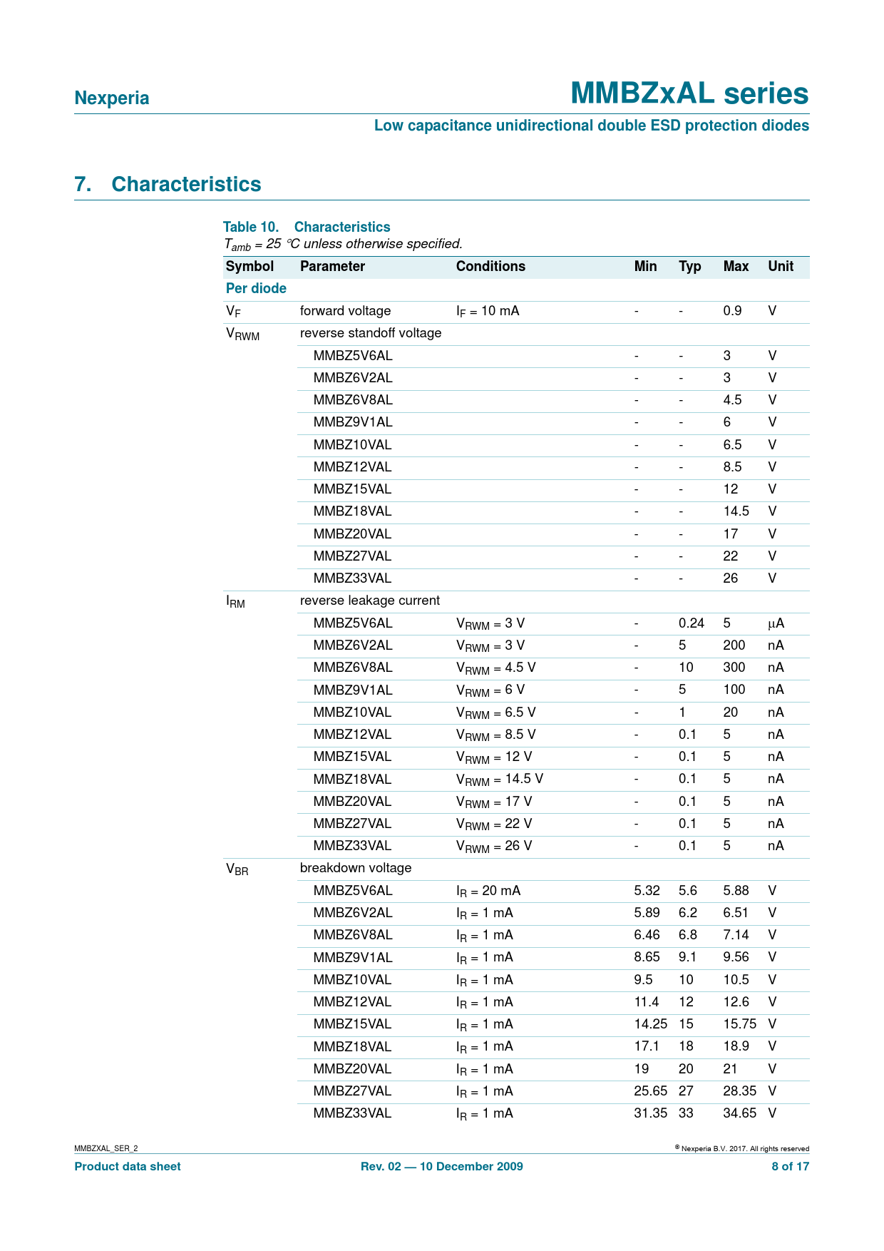

Nexperia. MMBZxAL series. Low capacitance unidirectional double ESD protection diodes. Characteristics. Table 10. Symbol. Parameter
Nexperia MMBZxAL series Low capacitance unidirectional double ESD protection diodes 7. Characteristics Table 10. Characteristics
Tamb = 25 °C unless otherwise specified.
Symbol Parameter Conditions Min Typ Max Unit Per diode
VF forward voltage IF = 10 mA - - 0.9 V VRWM reverse standoff voltage MMBZ5V6AL - - 3 V MMBZ6V2AL - - 3 V MMBZ6V8AL - - 4.5 V MMBZ9V1AL - - 6 V MMBZ10VAL - - 6.5 V MMBZ12VAL - - 8.5 V MMBZ15VAL - - 12 V MMBZ18VAL - - 14.5 V MMBZ20VAL - - 17 V MMBZ27VAL - - 22 V MMBZ33VAL - - 26 V IRM reverse leakage current MMBZ5V6AL VRWM = 3 V - 0.24 5 μA MMBZ6V2AL VRWM = 3 V - 5 200 nA MMBZ6V8AL VRWM = 4.5 V - 10 300 nA MMBZ9V1AL VRWM = 6 V - 5 100 nA MMBZ10VAL VRWM = 6.5 V - 1 20 nA MMBZ12VAL VRWM = 8.5 V - 0.1 5 nA MMBZ15VAL VRWM = 12 V - 0.1 5 nA MMBZ18VAL VRWM = 14.5 V - 0.1 5 nA MMBZ20VAL VRWM = 17 V - 0.1 5 nA MMBZ27VAL VRWM = 22 V - 0.1 5 nA MMBZ33VAL VRWM = 26 V - 0.1 5 nA VBR breakdown voltage MMBZ5V6AL IR = 20 mA 5.32 5.6 5.88 V MMBZ6V2AL IR = 1 mA 5.89 6.2 6.51 V MMBZ6V8AL IR = 1 mA 6.46 6.8 7.14 V MMBZ9V1AL IR = 1 mA 8.65 9.1 9.56 V MMBZ10VAL IR = 1 mA 9.5 10 10.5 V MMBZ12VAL IR = 1 mA 11.4 12 12.6 V MMBZ15VAL IR = 1 mA 14.25 15 15.75 V MMBZ18VAL IR = 1 mA 17.1 18 18.9 V MMBZ20VAL IR = 1 mA 19 20 21 V MMBZ27VAL IR = 1 mA 25.65 27 28.35 V MMBZ33VAL IR = 1 mA 31.35 33 34.65 V MMBZXAL_SER_2 © Nexperia B.V. 2017. All rights reserved
