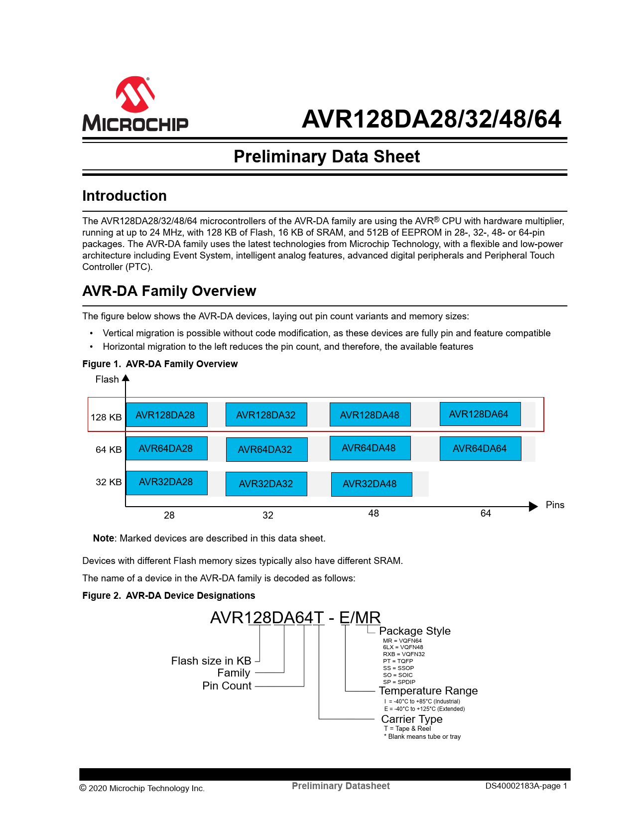

AVR128DA28/32/48/64 Preliminary Data Sheet Introduction
The AVR128DA28/32/48/64 microcontrollers of the AVR-DA family are using the AVR® CPU with hardware multiplier, running at up to 24 MHz, with 128 KB of Flash, 16 KB of SRAM, and 512B of EEPROM in 28-, 32-, 48- or 64-pin packages. The AVR-DA family uses the latest technologies from Microchip Technology, with a flexible and low-power architecture including Event System, intelligent analog features, advanced digital peripherals and Peripheral Touch Controller (PTC).
AVR-DA Family Overview
The figure below shows the AVR-DA devices, laying out pin count variants and memory sizes: • Vertical migration is possible without code modification, as these devices are fully pin and feature compatible • Horizontal migration to the left reduces the pin count, and therefore, the available features
Figure 1. AVR-DA Family Overview
Flash 128 KB AVR128DA28 AVR128DA32 AVR128DA48 AVR128DA64 64 KB AVR64DA28 AVR64DA32 AVR64DA48 AVR64DA64 32 KB AVR32DA28 AVR32DA32 AVR32DA48 Pins 28 32 48 64
Note
: Marked devices are described in this data sheet. Devices with different Flash memory sizes typically also have different SRAM. The name of a device in the AVR-DA family is decoded as follows:
Figure 2. AVR-DA Device Designations
AVR128DA64T - E/MRPackage Style MR = VQFN64 6LX = VQFN48 RXB = VQFN32 Flash size in KB PT = TQFP Family SS = SSOP SO = SOIC Pin Count SP = SPDIP Temperature Range I = -40°C to +85°C (Industrial) E = -40°C to +125°C (Extended) Carrier Type T = Tape & Reel * Blank means tube or tray © 2020 Microchip Technology Inc.
