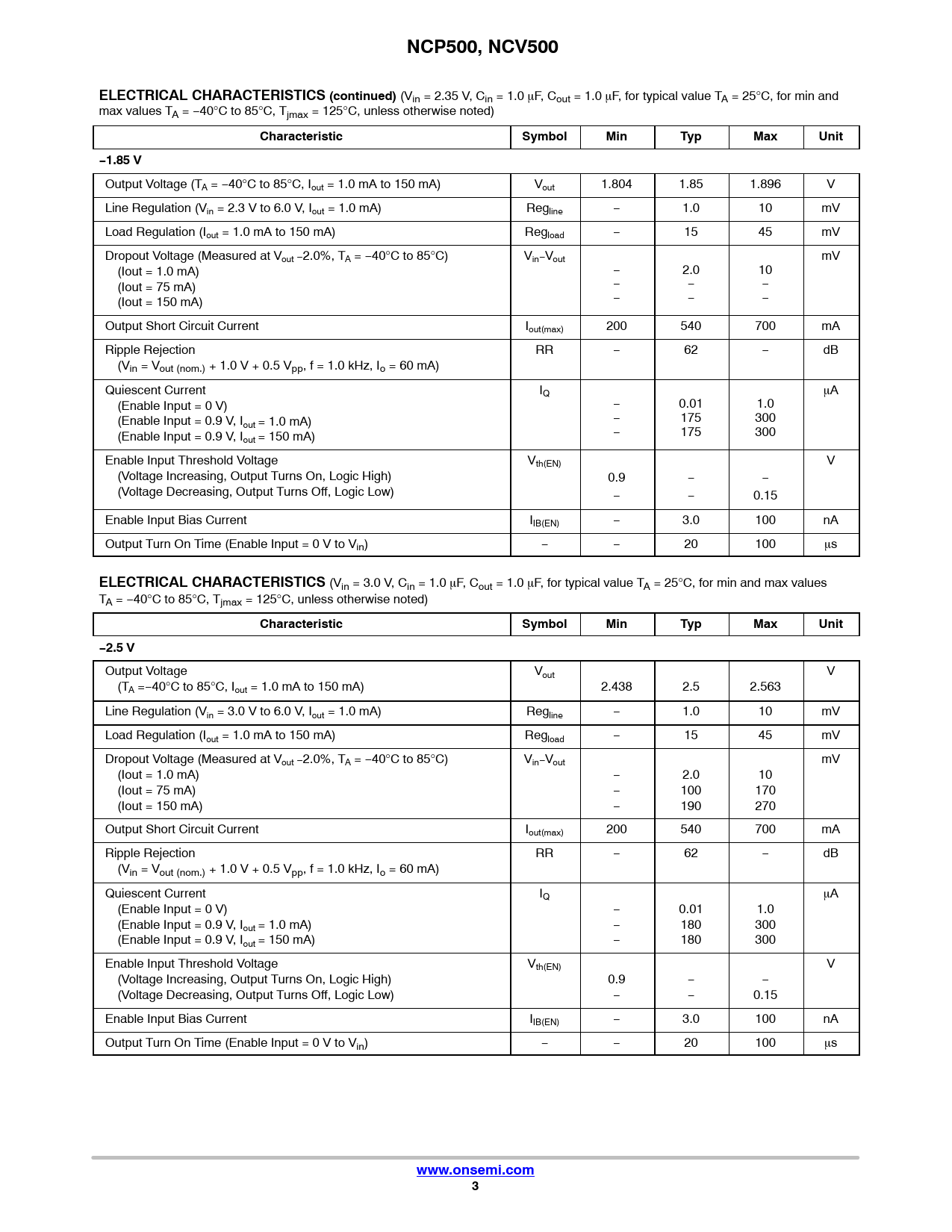

NCP500, NCV500. ELECTRICAL CHARACTERISTICS (continued). Characteristic. Symbol. Min. Typ. Max. Unit. −1.85 V. ELECTRICAL CHARACTERISTICS
NCP500, NCV500 ELECTRICAL CHARACTERISTICS (continued) Characteristic Symbol Min Typ Max Unit −1.85 V ELECTRICAL CHARACTERISTICS
(Vin = 2.35 V, Cin = 1.0 mF, Cout = 1.0 mF, for typical value TA = 25°C, for min and max values TA = −40°C to 85°C, Tjmax = 125°C, unless otherwise noted)
Output Voltage (TA = −40°C to 85°C, Iout = 1.0 mA to 150 mA) Vout 1.804 1.85 1.896 V Line Regulation (Vin = 2.3 V to 6.0 V, Iout = 1.0 mA) Regline − 1.0 10 mV Load Regulation (Iout = 1.0 mA to 150 mA) Regload − 15 45 mV Dropout Voltage (Measured at Vout −2.0%, TA = −40°C to 85°C) Vin−Vout mV (Iout = 1.0 mA) − 2.0 10 (Iout = 75 mA) − − − (Iout = 150 mA) − − − Output Short Circuit Current Iout(max) 200 540 700 mA Ripple Rejection RR − 62 − dB (Vin = Vout (nom.) + 1.0 V + 0.5 Vpp, f = 1.0 kHz, Io = 60 mA) Quiescent Current IQ mA (Enable Input = 0 V) − 0.01 1.0 (Enable Input = 0.9 V, I − 175 300 out = 1.0 mA) (Enable Input = 0.9 V, I − 175 300 out = 150 mA) Enable Input Threshold Voltage Vth(EN) V (Voltage Increasing, Output Turns On, Logic High) 0.9 − − (Voltage Decreasing, Output Turns Off, Logic Low) − − 0.15 Enable Input Bias Current IIB(EN) − 3.0 100 nA Output Turn On Time (Enable Input = 0 V to Vin) − − 20 100 ms
(Vin = 3.0 V, Cin = 1.0 mF, Cout = 1.0 mF, for typical value TA = 25°C, for min and max values TA = −40°C to 85°C, Tjmax = 125°C, unless otherwise noted)
Characteristic Symbol Min Typ Max Unit −2.5 V
Output Voltage Vout V (TA =−40°C to 85°C, Iout = 1.0 mA to 150 mA) 2.438 2.5 2.563 Line Regulation (Vin = 3.0 V to 6.0 V, Iout = 1.0 mA) Regline − 1.0 10 mV Load Regulation (Iout = 1.0 mA to 150 mA) Regload − 15 45 mV Dropout Voltage (Measured at Vout −2.0%, TA = −40°C to 85°C) Vin−Vout mV (Iout = 1.0 mA) − 2.0 10 (Iout = 75 mA) − 100 170 (Iout = 150 mA) − 190 270 Output Short Circuit Current Iout(max) 200 540 700 mA Ripple Rejection RR − 62 − dB (Vin = Vout (nom.) + 1.0 V + 0.5 Vpp, f = 1.0 kHz, Io = 60 mA) Quiescent Current IQ mA (Enable Input = 0 V) − 0.01 1.0 (Enable Input = 0.9 V, Iout = 1.0 mA) − 180 300 (Enable Input = 0.9 V, Iout = 150 mA) − 180 300 Enable Input Threshold Voltage Vth(EN) V (Voltage Increasing, Output Turns On, Logic High) 0.9 − − (Voltage Decreasing, Output Turns Off, Logic Low) − − 0.15 Enable Input Bias Current IIB(EN) − 3.0 100 nA Output Turn On Time (Enable Input = 0 V to Vin) − − 20 100 ms
