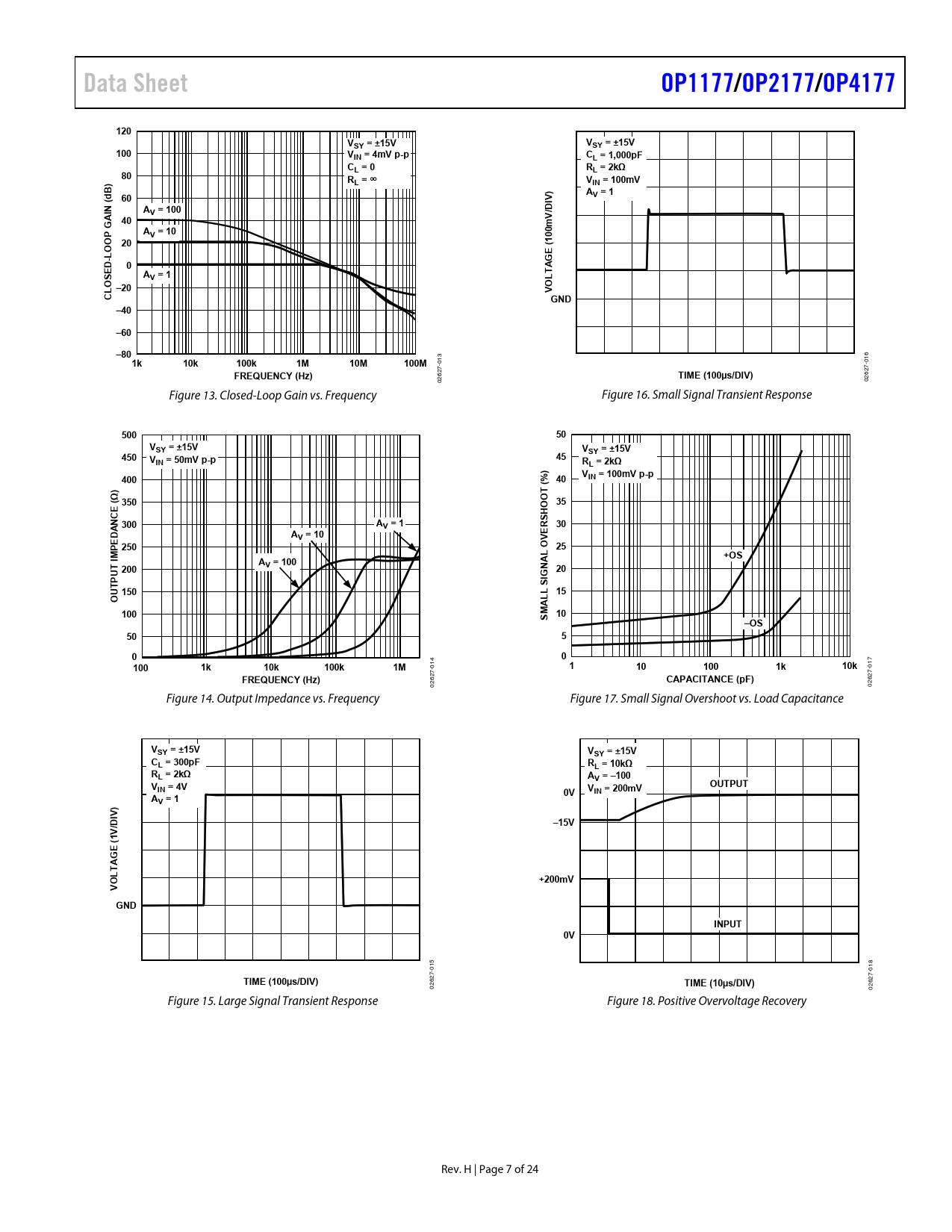

Data Sheet. OP1177. /OP2177. /OP4177. 120. VSY = ±15V. 100. VIN = 4mV p-p. CL = 1,000pF. CL = 0. RL = 2kΩ. RL = ∞. VIN = 100mV. B d. AV = 1. ( 60. IV)
Data Sheet OP1177 /OP2177 /OP4177 120 VSY = ±15V 100 VIN = 4mV p-p CL = 1,000pF CL = 0 RL = 2kΩ RL = ∞ VIN = 100mV B d AV = 1 ( 60 IV)
Data Sheet OP1177 /OP2177 /OP4177 120 VSY = ±15V VSY = ±15V 100 VIN = 4mV p-p CL = 1,000pF CL = 0 RL = 2kΩ 80 ) RL = ∞ VIN = 100mV B d AV = 1 ( 60 IV) IN A D V = 100 V/ 40 GA AV = 10 00m 20 OOP (1 E -L G D A E 0 A T V = 1 OS L –20 VOL C GND –40 –60 –80

02 026 Figure 13. Closed-Loop Gain vs. Frequency Figure 16. Small Signal Transient Response

62 26 0 02 Figure 14. Output Impedance vs. Frequency Figure 17. Small Signal Overshoot vs. Load Capacitance

02 26 0 Figure 15. Large Signal Transient Response Figure 18. Positive Overvoltage Recovery Rev. H | Page 7 of 24 Document Outline Features Applications Pin Configurations General Description Revision History Specifications Electrical Characteristics Electrical Characteristics Absolute Maximum Ratings Thermal Resistance ESD Caution Typical Performance Characteristics Functional Description Total Noise-Including Source Resistors Gain Linearity Input Overvoltage Protection Output Phase Reversal Settling Time Overload Recovery Time THD + Noise Capacitive Load Drive Stray Input Capacitance Compensation Reducing Electromagnetic Interference Proper Board Layout Difference Amplifiers A High Accuracy Thermocouple Amplifier Low Power Linearized RTD Single Operational Amplifier Bridge Realization of Active Filters Band-Pass KRC or Sallen-Key Filter Channel Separation References on Noise Dynamics and Flicker Noise Outline Dimensions Ordering Guide
