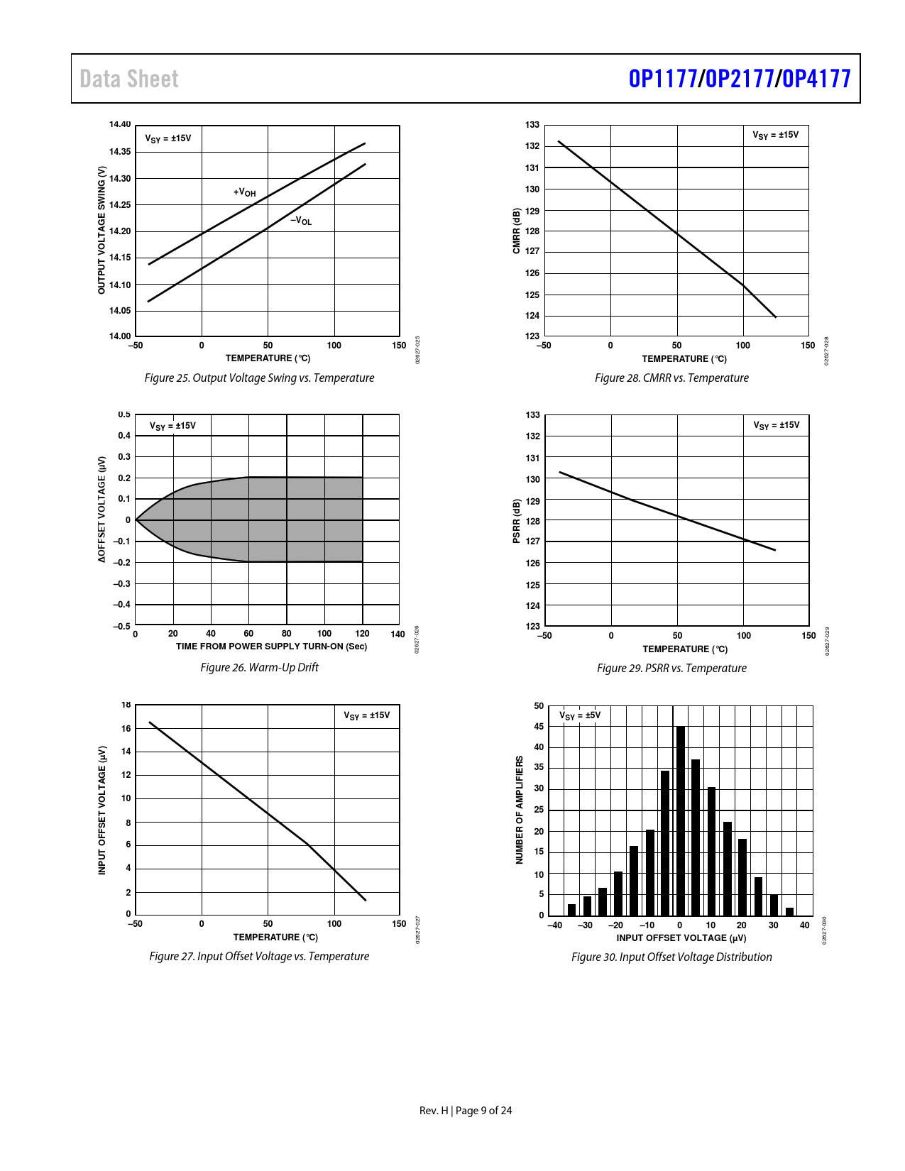

Data Sheet. OP1177. /OP2177. /OP4177. 14.40. 133. VSY = ±15V. SY = ±15V. 132. 14.35. ) V. 131. 14.30. G (. 130. WIN 14.25. B) 129. –VOL. 14.20. 128. RR (. OLTA
Data Sheet OP1177 /OP2177 /OP4177 14.40 133 V VSY = ±15V SY = ±15V 132 14.35 ) V 131 14.30 G ( +V 130 OH WIN 14.25 S B) 129 GE –VOL d 14.20 128 RR ( OLTA CM 127 T V 14.15 U 126 TP 14.10 OU 125 14.05 124 14.00 123 –50 0 50 100 150
025
–50 0 50 100 150
028
TEMPERATURE (°C) TEMPERATURE (°C)
02627- 02627- Figure 25. Output Voltage Swing vs. Temperature Figure 28. CMRR vs. Temperature
0.5 133 VSY = ±15V VSY = ±15V 0.4 132 0.3 131 (µV) 0.2 GE 130 0.1 129 OLTA B) d 0 128 ET V RR ( S –0.1 P 127 OFFS Δ –0.2 126 –0.3 125 –0.4 124 –0.5 123 0 20 40 60 80 100 120 140
026
–50 0 50 100 150
029
TIME FROM POWER SUPPLY TURN-ON (Sec)
02627-
TEMPERATURE (°C)
02627- Figure 26. Warm-Up Drift Figure 29. PSRR vs. Temperature
18 50 VSY = ±15V VSY = ±5V 16 45 ) 40 V 14 µ ( RS 35 GE 12 IE IF L 30 P OLTA 10 AM T V 25 F E 8 R O 20 6 BE T OFFS 15 U P NUM 4 IN 10 2 5 0 0 –50 0 50 100 150
027
–40 –30 –20 –10 0 10 20 30 40
030
TEMPERATURE (°C) INPUT OFFSET VOLTAGE (µV)
02627- 02627- Figure 27. Input Offset Voltage vs. Temperature Figure 30. Input Offset Voltage Distribution Rev. H | Page 9 of 24 Document Outline Features Applications Pin Configurations General Description Revision History Specifications Electrical Characteristics Electrical Characteristics Absolute Maximum Ratings Thermal Resistance ESD Caution Typical Performance Characteristics Functional Description Total Noise-Including Source Resistors Gain Linearity Input Overvoltage Protection Output Phase Reversal Settling Time Overload Recovery Time THD + Noise Capacitive Load Drive Stray Input Capacitance Compensation Reducing Electromagnetic Interference Proper Board Layout Difference Amplifiers A High Accuracy Thermocouple Amplifier Low Power Linearized RTD Single Operational Amplifier Bridge Realization of Active Filters Band-Pass KRC or Sallen-Key Filter Channel Separation References on Noise Dynamics and Flicker Noise Outline Dimensions Ordering Guide
