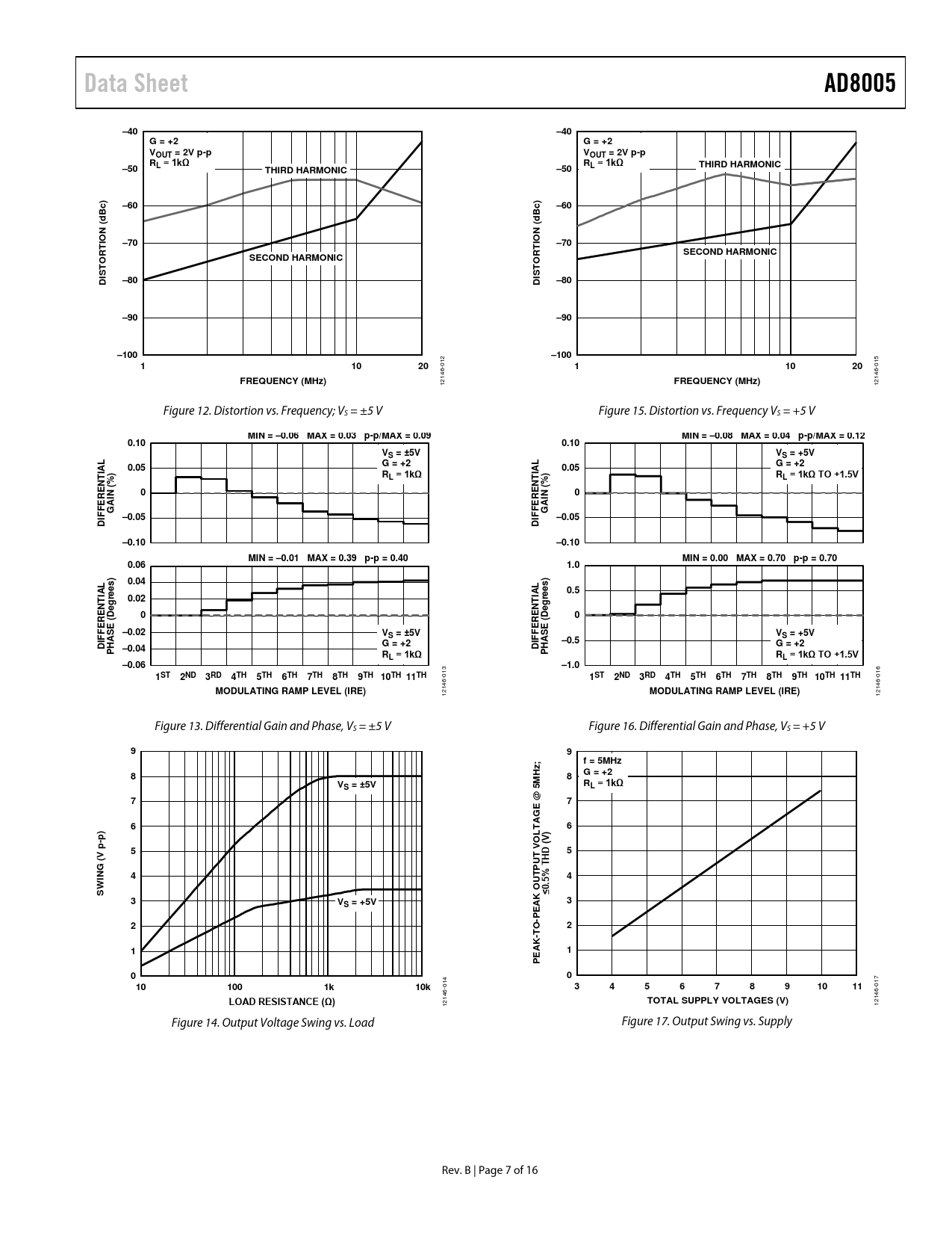

Data Sheet. AD8005. –40. G = +2. VOUT = 2V p-p. RL = 1kΩ. –50. L = 1kΩ. THIRD HARMONIC. –60. TION. –70. SECOND HARMONIC. TOR. –80. –90. –100
Data Sheet AD8005 –40 –40 G = +2 G = +2 VOUT = 2V p-p VOUT = 2V p-p RL = 1kΩ R –50 L = 1kΩ THIRD HARMONIC THIRD HARMONIC –50 ) ) c –60 c –60 dB dB ( ( TION –70 TION –70 SECOND HARMONIC SECOND HARMONIC TOR TOR IS IS D –80 D –80 –90 –90 –100 –100 1 10 20
012
1 10 20
015
FREQUENCY (MHz)
12146-
FREQUENCY (MHz)
12146- Figure 12. Distortion vs. Frequency; VS = ±5 V Figure 15. Distortion vs. Frequency VS = +5 V
MIN = –0.06 MAX = 0.03 p-p/MAX = 0.09 MIN = –0.08 MAX = 0.04 p-p/MAX = 0.12 0.10 0.10 VS = ±5V VS = +5V L L 0.05 G = +2 0.05 G = +2 TIA RL = 1kΩ TIA RL = 1kΩ TO +1.5V N %) N %) E E R N ( 0 R N ( 0 AI AI G G IFFE –0.05 IFFE –0.05 D D –0.10 –0.10 MIN = –0.01 MAX = 0.39 p-p = 0.40 MIN = 0.00 MAX = 0.70 p-p = 0.70 0.06 1.0 L 0.04 L 0.5 TIA rees) 0.02 TIA rees) N N E Deg E Deg R 0 0 ( R ( E E –0.02 VS = ±5V VS = +5V IFFE IFFE –0.5 D HAS G = +2 D HAS G = +2 P –0.04 R P L = 1kΩ RL = 1kΩ TO +1.5V –0.06 –1.0 1ST 2ND 3RD 4TH 5TH 6TH 7TH 8TH 9TH 10TH 11TH
013
016
MODULATING RAMP LEVEL (IRE)
12146-
12146- Figure 13. Differential Gain and Phase, VS = ±5 V Figure 16. Differential Gain and Phase, VS = +5 V
9 9 f = 5MHz z; 8 G = +2 8 V MH R S = ±5V 5 L = 1kΩ 7 7 E @ G A 6 T 6 ) L -p (V) 5 VO T 5 (V p THD G PU IN 4 T U 5% 4 SW O ≤0. K 3 V 3 S = +5V -PEA 2 O 2 -T K 1 1 PEA 0 0 10 100 1k 10k
014
3 4 5 6 7 8 9 10 11
017
LOAD RESISTANCE (Ω) TOTAL SUPPLY VOLTAGES (V)
12146- 12146- Figure 14. Output Voltage Swing vs. Load Figure 17. Output Swing vs. Supply Rev. B | Page 7 of 16 Document Outline Features Applications General Description Functional Block Diagrams Table of Contents Revision History Specifications ±5 V Supplies +5 V Supply Absolute Maximum Ratings Thermal Resistance Maximum Power Dissipation ESD Caution Typical Performance Characteristics Applications Driving Capicative Loads Single-Supply Level Shifter Single-Ended-to-Differential Conversion Layout Considerations Increasing Feedback Resistors Outline Dimensions Ordering Guide
