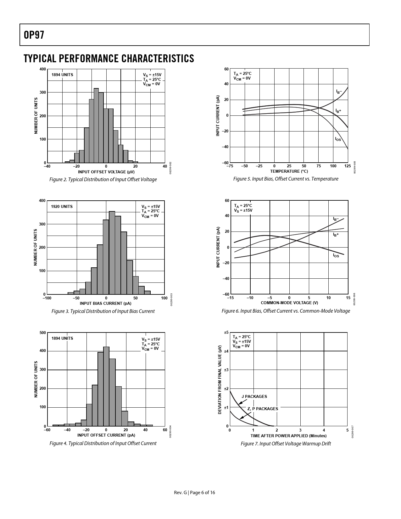

OP97. TYPICAL PERFORMANCE CHARACTERISTICS. 400. 1894 UNITS. S = ±15V. A = 25°C. CM = 0V. VCM = 0V. 300. IB–. NI U. IB+. O 200. R E B. CUR. T U. –20. INP
OP97 TYPICAL PERFORMANCE CHARACTERISTICS 400 1894 UNITS S = ±15V A = 25°C CM = 0V VCM = 0V 300 IB– NI U IB+ O 200 R E B CUR T U –20 INP
OP97 TYPICAL PERFORMANCE CHARACTERISTICS 400 60 1894 UNITS V T S = ±15V A = 25°C T V A = 25°C CM = 0V VCM = 0V 40 300 IB– S A) T p 20 ( NI U NT F IB+ RE O 200 0 R E B CUR M T U NU –20 INP 100 IOS –40 0
2 0
–60
05
–40 –20 0 20 40
0
–75 –50 –25 0 25 50 75 100 125
0 9- 9- 29 29
INPUT OFFSET VOLTAGE (µV) TEMPERATURE (°C)
00 00 Figure 2. Typical Distribution of Input Offset Voltage Figure 5. Input Bias, Offset Current vs. Temperature
400 60 1920 UNITS V T S = ±15V A = 25°C T V A = 25°C S = ±15V VCM = 0V 40 IB– 300 S A) 20 T (p IB+ UNI NT F E O 200 0 R BE CURR IOS T U –20 NUM INP 100 –40
3
0
0
–60
06
–100 –50 0 50 100
0
–15 –10 –5 0 5 10 15
0 9- 9- 29 29
INPUT BIAS CURRENT (pA) COMMON-MODE VOLTAGE (V)
00 00 Figure 3. Typical Distribution of Input Bias Current Figure 6. Input Bias, Offset Current vs. Common-Mode Voltage
500 ±5 T 1894 UNITS A = 25°C VS = ±15V VS = ±15V TA = 25°C ) VCM = 0V V 400 VCM = 0V µ ±4 ( E U S L T A NI 300 LV ±3 U A F IN F R O BE OM 200 R ±2 F NUM J PACKAGES TION 100 IA V ±1 Z, P PACKAGES DE
4
0 0
7
–60 –40 –20 0 20 40 60
009-
0 1 2 3 4 5
-00 29 299
INPUT OFFSET CURRENT (pA) TIME AFTER POWER APPLIED (Minutes)
00 00 Figure 4. Typical Distribution of Input Offset Current Figure 7. Input Offset Voltage Warmup Drift Rev. G | Page 6 of 16 Document Outline FEATURES PIN CONNECTIONS GENERAL DESCRIPTION TABLE OF CONTENTS REVISION HISTORY SPECIFICATIONS ELECTRICAL CHARACTERISTICS ABSOLUTE MAXIMUM RATINGS THERMAL RESISTANCE ESD CAUTION TYPICAL PERFORMANCE CHARACTERISTICS APPLICATION INFORMATION AC PERFORMANCE GUARDING AND SHIELDING OUTLINE DIMENSIONS ORDERING GUIDE
