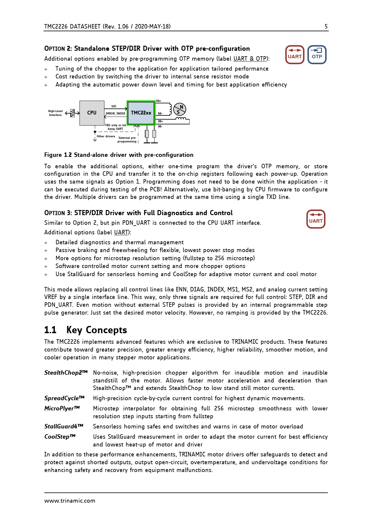

OPTION 2: Standalone STEP/DIR Driver with OTP pre-configuration. UART. OTP. 0A+. S/D. High-Level. CPU. ERROR, INDEX. TMC22xx. 0A-
OPTION 2: Standalone STEP/DIR Driver with OTP pre-configuration UART OTP 0A+ S/D High-Level CPU ERROR, INDEX TMC22xx 0A-
TMC2226 DATASHEET (Rev. 1.06 / 2020-MAY-18) 5
Additional options enabled by pre-programming OTP memory (label UART & OTP):
UART OTP
+ Tuning of the chopper to the application for application tailored performance + Cost reduction by switching the driver to internal sense resistor mode + Adapting the automatic power down level and timing for best application efficiency
0A+ S/D N High-Level CPU ERROR, INDEX TMC22xx 0A- S Interface 0B+ TXD only or bit 0B- bang UART Other drivers External pre- programming Figure 1.2 Stand-alone driver with pre-configuration
To enable the additional options, either one-time program the driver’s OTP memory, or store configuration in the CPU and transfer it to the on-chip registers following each power-up. Operation uses the same signals as Option 1. Programming does not need to be done within the application - it can be executed during testing of the PCB! Alternatively, use bit-banging by CPU firmware to configure the driver. Multiple drivers can be programmed at the same time using a single TXD line.
OPTION 3: STEP/DIR Driver with Full Diagnostics and Control
Similar to Option 2, but pin PDN_UART is connected to the CPU UART interface.
UART
Additional options (label UART): + Detailed diagnostics and thermal management + Passive braking and freewheeling for flexible, lowest power stop modes + More options for microstep resolution setting (fullstep to 256 microstep) + Software controlled motor current setting and more chopper options + Use StallGuard for sensorless homing and CoolStep for adaptive motor current and cool motor This mode allows replacing all control lines like ENN, DIAG, INDEX, MS1, MS2, and analog current setting VREF by a single interface line. This way, only three signals are required for full control: STEP, DIR and PDN_UART. Even motion without external STEP pulses is provided by an internal programmable step pulse generator: Just set the desired motor velocity. However, no ramping is provided by the TMC2226.
