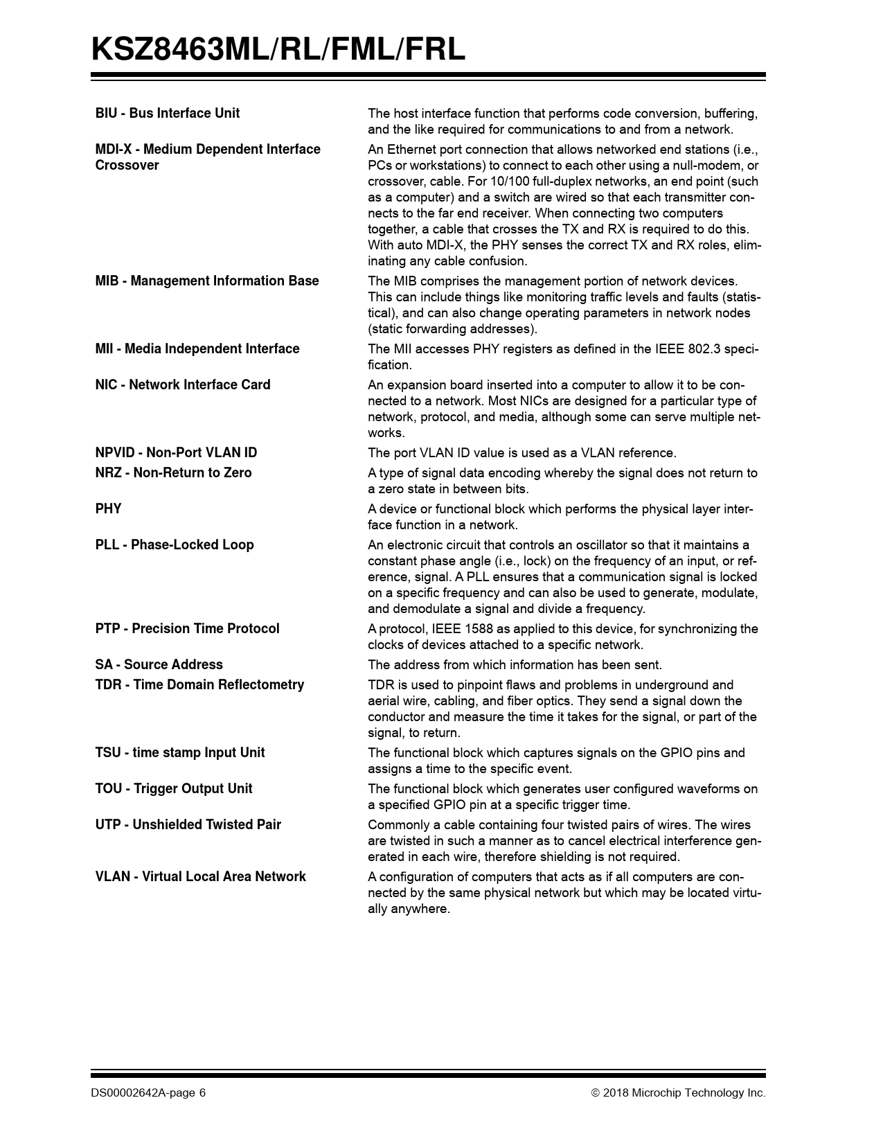

KSZ8463ML/RL/FML/FRL. BIU - Bus Interface Unit. MDI-X - Medium Dependent Interface. Crossover
KSZ8463ML/RL/FML/FRL BIU - Bus Interface Unit MDI-X - Medium Dependent Interface Crossover
The host interface function that performs code conversion, buffering, and the like required for communications to and from a network.
An Ethernet port connection that allows networked end stations (i.e.,
Crossover
PCs or workstations) to connect to each other using a null-modem, or crossover, cable. For 10/100 full-duplex networks, an end point (such as a computer) and a switch are wired so that each transmitter con- nects to the far end receiver. When connecting two computers together, a cable that crosses the TX and RX is required to do this. With auto MDI-X, the PHY senses the correct TX and RX roles, elim- inating any cable confusion.
MIB - Management Information Base
The MIB comprises the management portion of network devices. This can include things like monitoring traffic levels and faults (statis- tical), and can also change operating parameters in network nodes (static forwarding addresses).
MII - Media Independent Interface
The MII accesses PHY registers as defined in the IEEE 802.3 speci- fication.
NIC - Network Interface Card
An expansion board inserted into a computer to allow it to be con- nected to a network. Most NICs are designed for a particular type of network, protocol, and media, although some can serve multiple net- works.
NPVID - Non-Port VLAN ID
The port VLAN ID value is used as a VLAN reference.
NRZ - Non-Return to Zero
A type of signal data encoding whereby the signal does not return to a zero state in between bits.
PHY
A device or functional block which performs the physical layer inter- face function in a network.
PLL - Phase-Locked Loop
An electronic circuit that controls an oscillator so that it maintains a constant phase angle (i.e., lock) on the frequency of an input, or ref- erence, signal. A PLL ensures that a communication signal is locked on a specific frequency and can also be used to generate, modulate, and demodulate a signal and divide a frequency.
PTP - Precision Time Protocol
A protocol, IEEE 1588 as applied to this device, for synchronizing the clocks of devices attached to a specific network.
SA - Source Address
The address from which information has been sent.
TDR - Time Domain Reflectometry
TDR is used to pinpoint flaws and problems in underground and aerial wire, cabling, and fiber optics. They send a signal down the conductor and measure the time it takes for the signal, or part of the signal, to return.
TSU - time stamp Input Unit
The functional block which captures signals on the GPIO pins and assigns a time to the specific event.
TOU - Trigger Output Unit
The functional block which generates user configured waveforms on a specified GPIO pin at a specific trigger time.
UTP - Unshielded Twisted Pair
Commonly a cable containing four twisted pairs of wires. The wires are twisted in such a manner as to cancel electrical interference gen- erated in each wire, therefore shielding is not required.
VLAN - Virtual Local Area Network
A configuration of computers that acts as if all computers are con- nected by the same physical network but which may be located virtu- ally anywhere. DS00002642A-page 6
