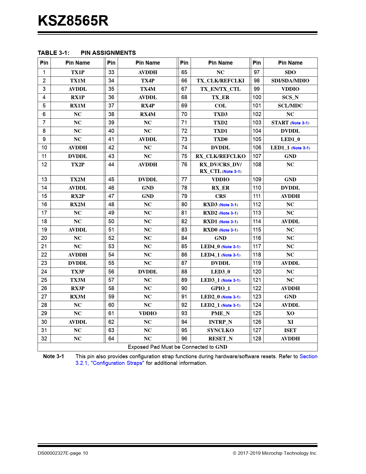

KSZ8565R. TABLE 3-1:. PIN ASSIGNMENTS. Pin. Pin Name. TX1P. AVDDH. SDO. TX1M. TX4P. TX_CLK/REFCLKI. SDI/SDA/MDIO. AVDDL. TX4M. TX_EN/TX_CTL. VDDIO
KSZ8565R TABLE 3-1: PIN ASSIGNMENTS Pin Pin Name TX1P AVDDH SDO TX1M TX4P TX_CLK/REFCLKI SDI/SDA/MDIO AVDDL TX4M TX_EN/TX_CTL VDDIO
link to page 16 link to page 16 link to page 16 link to page 10 link to page 10 link to page 10 link to page 10 link to page 10 link to page 10 link to page 10 link to page 10 link to page 10 link to page 10 link to page 10 link to page 10
KSZ8565R TABLE 3-1: PIN ASSIGNMENTS Pin Pin Name Pin Pin Name Pin Pin Name Pin Pin Name
1
TX1P
33
AVDDH
65
NC
97
SDO
2
TX1M
34
TX4P
66
TX_CLK/REFCLKI
98
SDI/SDA/MDIO
3
AVDDL
35
TX4M
67
TX_EN/TX_CTL
99
VDDIO
4
RX1P
36
AVDDL
68
TX_ER
100
SCS_N
5
RX1M
37
RX4P
69
COL
101
SCL/MDC
6
NC
38
RX4M
70
TXD3
102
NC
7
NC
39
NC
71
TXD2
103
START (Note 3-1)
8
NC
40
NC
72
TXD1
104
DVDDL
9
NC
41
AVDDL
73
TXD0
105
LED1_0
10
AVDDH
42
NC
74
DVDDL
106
LED1_1 (Note 3-1)
11
DVDDL
43
NC
75
RX_CLK/REFCLKO
107
GND
12
TX2P
44
AVDDH
76
RX_DV/CRS_DV/
108
NC RX_CTL (Note 3-1 )
13
TX2M
45
DVDDL
77
VDDIO
109
GND
14
AVDDL
46
GND
78
RX_ER
110
DVDDL
15
RX2P
47
GND
79
CRS
111
AVDDH
16
RX2M
48
NC
80
RXD3 (Note 3-1)
112
NC
17
NC
49
NC
81
RXD2 (Note 3-1)
113
NC
18
NC
50
NC
82
RXD1 (Note 3-1)
114
AVDDL
19
AVDDL
51
NC
83
RXD0 (Note 3-1)
115
NC
20
NC
52
NC
84
GND
116
NC
21
NC
53
NC
85
LED4_0 (Note 3-1)
117
NC
22
AVDDH
54
NC
86
LED4_1 (Note 3-1)
118
NC
23
DVDDL
55
NC
87
DVDDL
119
AVDDL
24
TX3P
56
DVDDL
88
LED3_0
120
NC
25
TX3M
57
NC
89
LED3_1 (Note 3-1)
121
NC
26
RX3P
58
NC
90
GPIO_1
122
AVDDH
27
RX3M
59
NC
91
LED2_0 (Note 3-1)
123
GND
28
NC
60
NC
92
LED2_1 (Note 3-1)
124
AVDDL
29
NC
61
VDDIO
93
PME_N
125
XO
30
AVDDL
62
NC
94
INTRP_N
126
XI
31
NC
63
NC
95
SYNCLKO
127
ISET
32
NC
64
NC
96
RESET_N
128
AVDDH
Exposed Pad Must be Connected to
GND Note 3-1
This pin also provides configuration strap functions during hardware/software resets. Refer to Section 3.2.1, "Configuration Straps" for additional information. DS00002327E-page 10  2017-2019 Microchip Technology Inc. Document Outline 1.0 Preface 1.1 Glossary of Terms TABLE 1-1: General Terms 1.2 Buffer Types TABLE 1-2: Buffer Types 1.3 Register Nomenclature TABLE 1-3: Register Nomenclature 1.4 References 2.0 Introduction 2.1 General Description FIGURE 2-1: Internal Block Diagram 3.0 Pin Descriptions and Configuration 3.1 Pin Assignments FIGURE 3-1: Pin Assignments (Top View) TABLE 3-1: Pin Assignments 3.2 Pin Descriptions TABLE 3-2: Pin Descriptions 3.2.1 Configuration Straps TABLE 3-3: Configuration Strap Descriptions 4.0 Functional Description 4.1 Physical Layer Transceiver (PHY) 4.1.1 100BASE-TX Transceiver 4.1.2 10BASE-T/Te Transceiver 4.1.3 Auto MDI/MDI-X TABLE 4-1: MDI/MDI-X Pin Definitions 4.1.4 Wave Shaping, Slew-Rate Control, and Partial Response 4.1.5 Auto-Negotiation FIGURE 4-1: Auto-Negotiation and Parallel Operation 4.1.6 Quiet-WIRE Filtering TABLE 4-2: Enabling and Disabling Quiet-WIRE 4.1.7 Fast Link-Up 4.1.8 LinkMD®+ Enhanced Diagnostics: Receive Signal Quality Indicator 4.1.9 Remote PHY Loopback FIGURE 4-2: Remote PHY Loopback 4.2 LEDs 4.2.1 Single-LED Mode TABLE 4-3: Single-LED Mode Pin Definition 4.2.2 Tri-Color Dual-LED Mode TABLE 4-4: Tri-Color Dual-LED Mode Pin Definition 4.3 Media Access Controller (MAC) 4.3.1 MAC Operation 4.3.2 Inter-Packet Gap (IPG) 4.3.3 Back-Off Algorithm 4.3.4 Late Collision 4.3.5 Legal Packet Size 4.3.6 Flow Control 4.3.7 Half-Duplex Back Pressure 4.3.8 Flow Control and Back Pressure Registers TABLE 4-5: Flow Control and back Pressure Registers 4.3.9 Broadcast Storm Protection 4.3.10 Self-Address Filtering 4.4 Switch 4.4.1 Switching Engine 4.4.2 Address Lookup TABLE 4-6: Address Lookup Table Hashing Options TABLE 4-7: Reserved Multicast Address Table FIGURE 4-3: Packet Forwarding Process Flowchart TABLE 4-8: Lookup Engine Registers 4.4.3 IEEE 802.1Q VLAN TABLE 4-9: VLAN Forwarding TABLE 4-10: Hashed(DA) + FID Lookup in VLAN Mode TABLE 4-11: Hashed(SA) + FID Lookup in VLAN Mode TABLE 4-12: VLAN Registers 4.4.4 Quality-of-Service (QoS) Priority Support FIGURE 4-4: 802.p Priority Field Format 4.4.5 Traffic Conditioning & Policing 4.4.6 Spanning Tree Support TABLE 4-13: Spanning Tree States 4.4.7 Rapid Spanning Tree Support 4.4.8 Multiple Spanning Tree Support 4.4.9 Tail Tagging Mode FIGURE 4-5: Tail Tag Frame Format TABLE 4-14: Receive Tail Tag Format (from Switch to Host) TABLE 4-15: Transmit Tail Tag Format (from Host to Switch) FIGURE 4-6: PTP Mode Tail Tag Frame Format 4.4.10 IGMP Support 4.4.11 IPv6 MLD Snooping 4.4.12 Port Mirroring 4.4.13 Scheduling and Rate Limiting 4.4.14 Egress Traffic Shaping 4.4.15 Low Latency Cut-Through Mode 4.4.16 Ingress MAC Address Filtering Function 4.4.17 802.1X Access Control 4.4.18 Access Control List (ACL) Filtering TABLE 4-16: ACL Processing Entry Parameters FIGURE 4-7: ACL Structure and Example Rule Values TABLE 4-17: Matching Rule Options TABLE 4-18: ACL Matching Rule Parameters for MD = 01 TABLE 4-19: ACL Matching Rule Parameters for MD = 10 TABLE 4-20: ACL Matching Rule Parameters for MD = 11 TABLE 4-21: ACL Action Rule Parameters for Non-count Modes (MD ≠ 01 or ENB ≠ 00) TABLE 4-22: ACL Action Rule Parameters for count Mode (MD = 01 or ENB = 00) FIGURE 4-8: ACL Table Format TABLE 4-23: ACL Registers 4.5 IEEE 1588 Precision Time Protocol 4.5.1 IEEE 1588 PTP System Time Clock FIGURE 4-9: PTP System Clock Overview 4.5.2 IEEE 1588 PTP Messaging Processing 4.5.3 IEEE 1588 PTP Event Triggering and Timestamping 4.6 Audio Video Bridging and Time Sensitive Networks 4.7 NAND Tree Support TABLE 4-24: NAND Tree Test Pin Order 4.8 Clocking 4.8.1 Primary Clock 4.8.2 MAC Interface Clocks 4.8.3 Serial Management Interface Clock 4.8.4 Synchronous Ethernet and SYNCLKO 4.9 Power FIGURE 4-10: Power Connection Diagram 4.10 Power Management TABLE 4-25: MDI/MDI-X Pin Definitions 4.10.1 Normal Operation Mode 4.10.2 Energy-Detect Mode 4.10.3 Global Soft Power-Down Mode 4.10.4 Port-Based Power Down 4.10.5 Energy Efficient Ethernet (EEE) FIGURE 4-11: Traffic Activity and EEE 4.10.6 Wake on LAN (WoL) 4.11 Management Interface 4.11.1 SPI Slave Bus TABLE 4-26: Register Access using the SPI Interface FIGURE 4-12: SPI Register Read Operation FIGURE 4-13: SPI Register Write Operation 4.11.2 I2C Bus FIGURE 4-14: Single Byte Register Write FIGURE 4-15: Single Byte Register Read FIGURE 4-16: Burst Register Write FIGURE 4-17: Burst Register Read 4.11.3 MII Management (MIIM) Interface TABLE 4-27: MII Management Interface Frame Format TABLE 4-28: Standard MIIM Registers 4.12 In-Band Management FIGURE 4-18: In-Band Management Frame Format 4.13 MAC Interface (RGMII/MII/RMII Port 5) 4.13.1 Media Independent Interface (MII) TABLE 4-29: MII (PHY Mode) Connection to External MAC TABLE 4-30: MII (MAC Mode) Connection to External PHY 4.13.2 Reduced Media Independent Interface (RMII) TABLE 4-31: RMII Signal Descriptions TABLE 4-32: RMII Connection to External MAC TABLE 4-33: RMII Connection to External PHY 4.13.3 Reduced Gigabit Media Independent Interface (RGMII) TABLE 4-34: RGMII Signal Descriptions 5.0 Device Registers FIGURE 5-1: Register Address Mapping FIGURE 5-2: Byte Ordering TABLE 5-1: Global Register Address Map TABLE 5-2: Port N (1-7) Register Address Map 5.1 Global Registers 5.1.1 Global Operation Control Registers (0x0000 - 0x00FF) 5.1.2 Global I/O Control Registers (0x0100 - 0x01FF) 5.1.3 Global PHY Control and Status Registers (0x0200 - 0x02FF) 5.1.4 Global Switch Control Registers (0x0300 - 0x03FF) 5.1.5 Global Switch Look Up Engine (LUE) Control Registers (0x0400 - 0x04FF) 5.1.6 Global Switch PTP Control Registers (0x0500 - 0x05FF) 5.2 Port Registers 5.2.1 Port N: Port Operation Control Registers (0xN000 - 0xN0FF) 5.2.2 Port N: Port Ethernet PHY Registers (0xN100 - 0xN1FF) 5.2.3 Port N: Port RGMII/MII/RMII Control Registers (0xN300 - 0xN3FF) 5.2.4 Port N: Port Switch MAC Control Registers (0xN400 - 0xN4FF) TABLE 5-3: Data Rate Selection Table for Ingress and Egress Rate Limiting 5.2.5 Port N: Port Switch MIB Counters Registers (0xN500 - 0xN5FF) 5.2.6 Port N: Port Switch ACL Control Registers (0xN600 - 0xN6FF) 5.2.7 Port N: Port Switch Ingress Control Registers (0xN800 - 0xN8FF) 5.2.8 Port N: Port Switch Egress Control Registers (0xN900 - 0xN9FF) 5.2.9 Port N: Port Switch Queue Management Control Registers (0xNA00 - 0xNAFF) 5.2.10 Port N: Port Switch Address Lookup Control Registers (0xNB00 - 0xNBFF) 5.2.11 Port N: Port Switch PTP Control Registers (0xNC00 - 0xNCFF) 5.3 Tables and MIB Counters (Access) 5.3.1 Address Lookup (ALU) Table FIGURE 5-3: Address Lookup Table Configuration 5.3.2 Static Address Table 5.3.3 Reserved Multicast Address Table 5.3.4 VLAN Table FIGURE 5-4: VLAN Table Structure TABLE 5-4: VLAN Table Data Fields 5.3.5 Access Control List (ACL) Table TABLE 5-5: ACL Field Register Mapping 5.3.6 Management Information Base (MIB) Counters TABLE 5-6: MIB Counters 5.4 MDIO Manageable Device (MMD) Registers (Indirect) TABLE 5-7: MMD Register Map 5.4.1 MMD Signal Quality Register 5.4.2 MMD LED Mode Register 5.4.3 MMD EEE Advertisement Register 5.4.4 MMD Quiet-WIRE Configuration 0 Register 5.4.5 MMD Quiet-WIRE Configuration 1 Register 5.4.6 MMD Quiet-WIRE Configuration 2 Register 5.4.7 MMD Quiet-WIRE Configuration 3 Register 5.4.8 MMD Quiet-WIRE Configuration 4 Register 5.4.9 MMD Quiet-WIRE Configuration 5 Register 5.4.10 MMD Quiet-WIRE Configuration 6 Register 5.4.11 MMD Quiet-WIRE Configuration 7 Register 5.4.12 MMD Quiet-WIRE Configuration 8 Register 5.4.13 MMD Quiet-WIRE Configuration 9 Register 5.4.14 MMD Quiet-WIRE Configuration 10 Register 5.4.15 MMD Quiet-WIRE Configuration 11 Register 5.4.16 MMD Quiet-WIRE Configuration 12 Register 5.4.17 MMD Quiet-WIRE Configuration 13 Register 5.4.18 MMD Quiet-WIRE Configuration 14 Register 5.4.19 MMD Quiet-WIRE Configuration 15 Register 6.0 Operational Characteristics 6.1 Absolute Maximum Ratings* 6.2 Operating Conditions** 6.3 Electrical Characteristics TABLE 6-1: Electrical Characteristics 6.4 Timing Specifications 6.4.1 RGMII Timing FIGURE 6-1: RGMII Timing TABLE 6-2: RGMII Timing Values 6.4.2 MII Timing FIGURE 6-2: MII Transmit Timing in MAC Mode TABLE 6-3: MII Transmit Timing in MAC Mode Values FIGURE 6-3: MII Receive Timing in MAC Mode TABLE 6-4: MII Receive Timing in MAC Mode Values FIGURE 6-4: MII Receive Timing in PHY Mode TABLE 6-5: MII Receive Timing in PHY Mode Values FIGURE 6-5: MII Transmit Timing in PHY Mode TABLE 6-6: MII Transmit Timing in PHY Mode Values 6.4.3 RMII Timing FIGURE 6-6: RMII Transmit Timing FIGURE 6-7: RMII Receive Timing TABLE 6-7: RMII Timing Values 6.4.4 MIIM Timing FIGURE 6-8: MIIM Timing TABLE 6-8: MIIM Timing Values 6.4.5 SPI Timing FIGURE 6-9: SPI Data Input Timing FIGURE 6-10: SPI Data Output Timing TABLE 6-9: SPI Timing Values 6.4.6 Auto-Negotiation Timing FIGURE 6-11: Auto-Negotiation Timing TABLE 6-10: Auto-Negotiation Timing Values 6.4.7 Trigger Output Unit and Timestamp Input Unit Timing FIGURE 6-12: Trigger Output Unit and Timestamp Input Unit Timing TABLE 6-11: Auto-Negotiation Timing Values 6.4.8 Power-up and Reset Timing FIGURE 6-13: Power-up and Reset Timing TABLE 6-12: Power-up and Reset Timing Values 6.5 Clock Specifications FIGURE 6-14: Input Reference Clock Connection Options TABLE 6-13: Reference Crystal Characteristics 7.0 Design Guidelines 7.1 Reset Circuit Guidelines FIGURE 7-1: Simple Reset Circuit FIGURE 7-2: Reset Circuit for CPU Reset Interface 7.2 Magnetics Connection and Selection Guidelines FIGURE 7-3: Typical Magnetic Interface Circuit TABLE 7-1: Magnetics Selection Criteria 8.0 Package Information 8.1 Package Marking Information 8.2 Package Drawings FIGURE 8-1: Package (Drawing) FIGURE 8-2: Package (Dimensions) FIGURE 8-3: Package (Land Pattern) Appendix A: Data Sheet Revision History The Microchip Web Site Customer Change Notification Service Customer Support Product Identification System Worldwide Sales and Service
