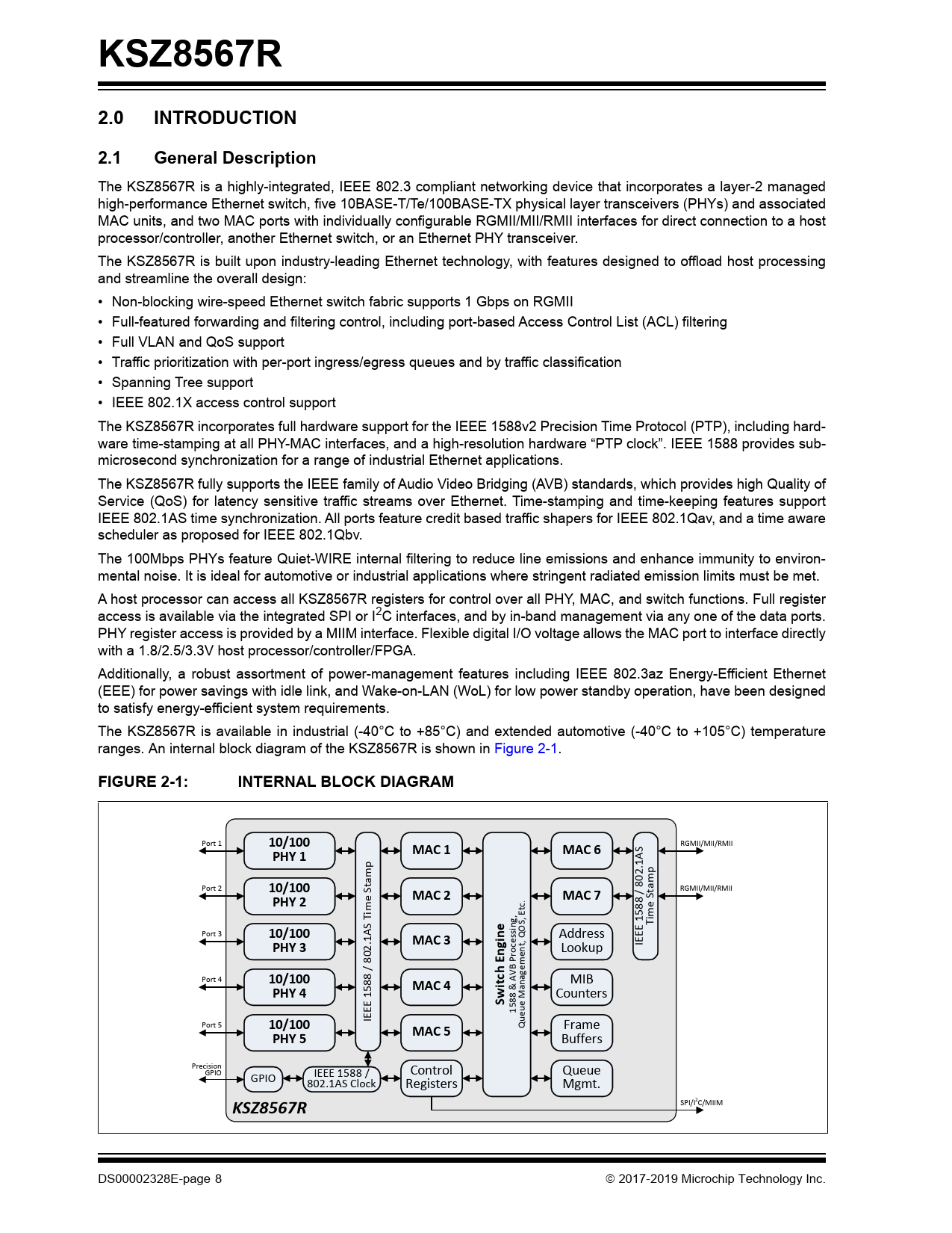

The KSZ8567R is a highly-integrated, IEEE 802.3 compliant networking device that incorporates a layer-2 managed high-performance Ethernet switch, five 10BASE-T/Te/100BASE-TX physical layer transceivers (PHYs) and associated MAC units, and two MAC ports with individually configurable RGMII/MII/RMII interfaces for direct connection to a host processor/controller, another Ethernet switch, or an Ethernet PHY transceiver. The KSZ8567R is built upon industry-leading Ethernet technology, with features designed to offload host processing and streamline the overall design: • Non-blocking wire-speed Ethernet switch fabric supports 1 Gbps on RGMII • Full-featured forwarding and filtering control, including port-based Access Control List (ACL) filtering • Full VLAN and QoS support • Traffic prioritization with per-port ingress/egress queues and by traffic classification • Spanning Tree support • IEEE 802.1X access control support The KSZ8567R incorporates full hardware support for the IEEE 1588v2 Precision Time Protocol (PTP), including hard- ware time-stamping at all PHY-MAC interfaces, and a high-resolution hardware “PTP clock”. IEEE 1588 provides sub- microsecond synchronization for a range of industrial Ethernet applications. The KSZ8567R fully supports the IEEE family of Audio Video Bridging (AVB) standards, which provides high Quality of Service (QoS) for latency sensitive traffic streams over Ethernet. Time-stamping and time-keeping features support IEEE 802.1AS time synchronization. All ports feature credit based traffic shapers for IEEE 802.1Qav, and a time aware scheduler as proposed for IEEE 802.1Qbv. The 100Mbps PHYs feature Quiet-WIRE internal filtering to reduce line emissions and enhance immunity to environ- mental noise. It is ideal for automotive or industrial applications where stringent radiated emission limits must be met. A host processor can access all KSZ8567R registers for control over all PHY, MAC, and switch functions. Full register access is available via the integrated SPI or I2C interfaces, and by in-band management via any one of the data ports. PHY register access is provided by a MIIM interface. Flexible digital I/O voltage allows the MAC port to interface directly with a 1.8/2.5/3.3V host processor/controller/FPGA. Additionally, a robust assortment of power-management features including IEEE 802.3az Energy-Efficient Ethernet (EEE) for power savings with idle link, and Wake-on-LAN (WoL) for low power standby operation, have been designed to satisfy energy-efficient system requirements. The KSZ8567R is available in industrial (-40°C to +85°C) and extended automotive (-40°C to +105°C) temperature ranges. An internal block diagram of the KSZ8567R is shown in Figure 2-1.
FIGURE 2-1: INTERNAL BLOCK DIAGRAM
