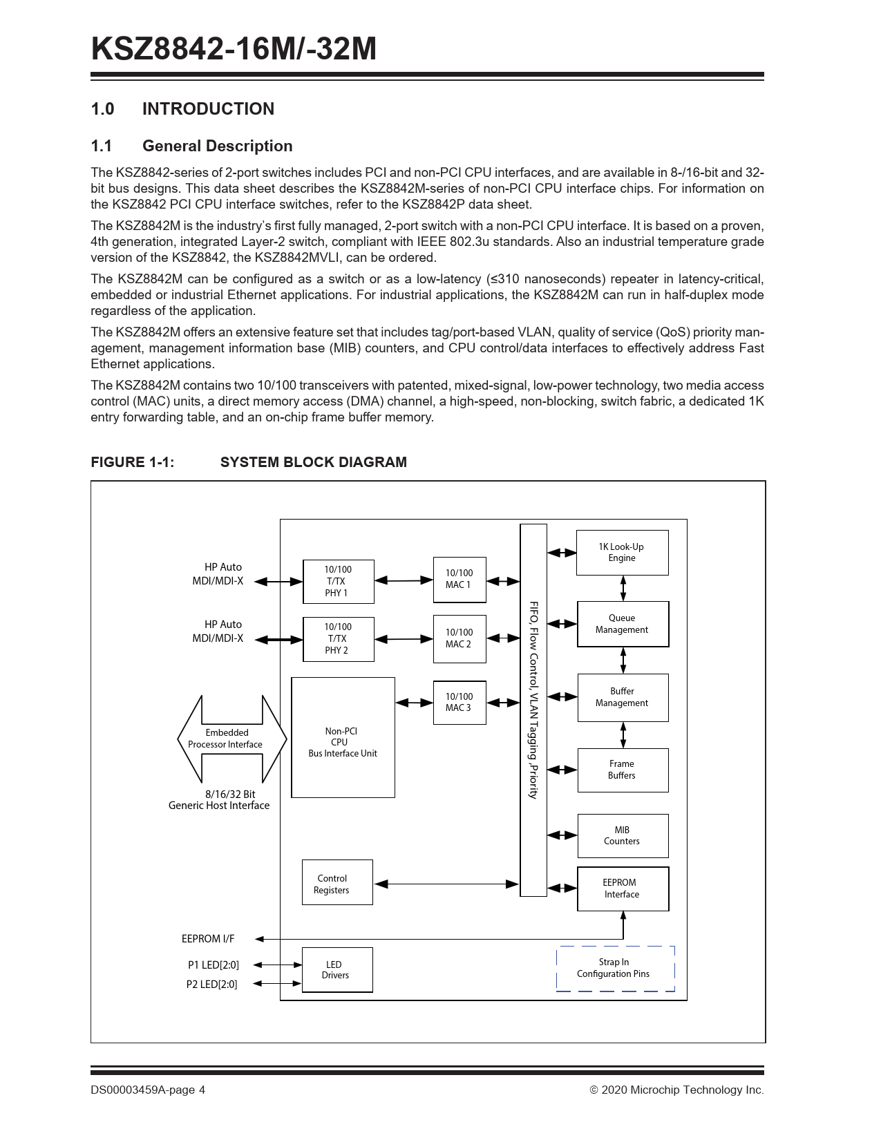

KSZ8842-16M/-32M. 1.0. INTRODUCTION. 1.1. General Description. FIGURE 1-1:. SYSTEM BLOCK DIAGRAM
KSZ8842-16M/-32M 1.0 INTRODUCTION 1.1 General Description FIGURE 1-1: SYSTEM BLOCK DIAGRAM
The KSZ8842-series of 2-port switches includes PCI and non-PCI CPU interfaces, and are available in 8-/16-bit and 32- bit bus designs. This data sheet describes the KSZ8842M-series of non-PCI CPU interface chips. For information on the KSZ8842 PCI CPU interface switches, refer to the KSZ8842P data sheet. The KSZ8842M is the industry’s first fully managed, 2-port switch with a non-PCI CPU interface. It is based on a proven, 4th generation, integrated Layer-2 switch, compliant with IEEE 802.3u standards. Also an industrial temperature grade version of the KSZ8842, the KSZ8842MVLI, can be ordered. The KSZ8842M can be configured as a switch or as a low-latency (≤310 nanoseconds) repeater in latency-critical, embedded or industrial Ethernet applications. For industrial applications, the KSZ8842M can run in half-duplex mode regardless of the application. The KSZ8842M offers an extensive feature set that includes tag/port-based VLAN, quality of service (QoS) priority man- agement, management information base (MIB) counters, and CPU control/data interfaces to effectively address Fast Ethernet applications. The KSZ8842M contains two 10/100 transceivers with patented, mixed-signal, low-power technology, two media access control (MAC) units, a direct memory access (DMA) channel, a high-speed, non-blocking, switch fabric, a dedicated 1K entry forwarding table, and an on-chip frame buffer memory.
1K Look-Up Engine HP Auto 10/100 10/100 MDI/MDI-X T/TX MAC 1 PHY 1 FIFO, Flow Control, Queue HP Auto 10/100 Management 10/100 MDI/MDI-X T/TX MAC 2 PHY 2 VLAN Tagging ,Priority Buffer 10/100 Management MAC 3 Embedded Non-PCI Processor Interface CPU Bus Interface Unit Frame Buffers 8/16/32 Bit Generic Host Interface MIB Counters Control EEPROM Registers Interface EEPROM I/F P1 LED[2:0] Strap In LED Drivers Configuration Pins P2 LED[2:0] DS00003459A-page 4
