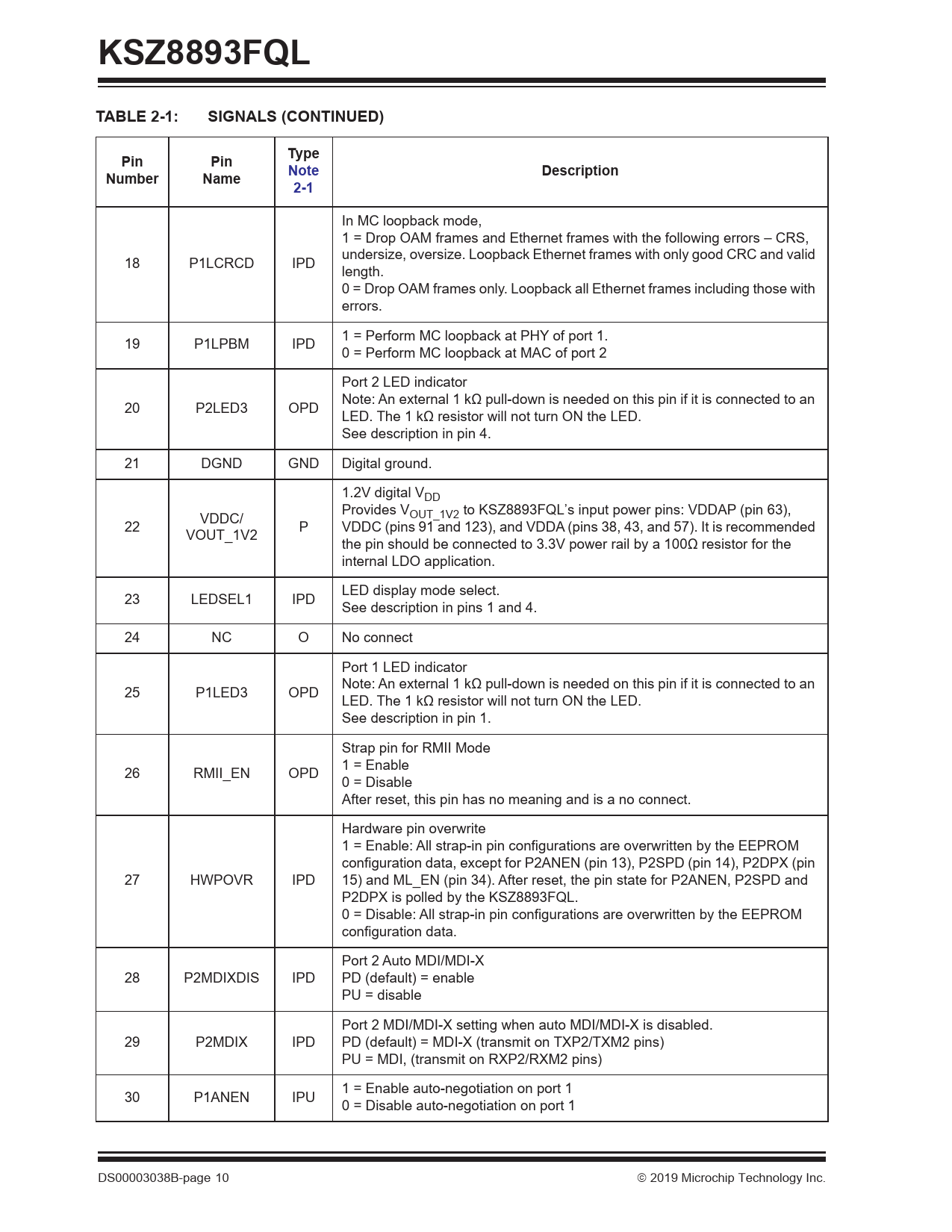

KSZ8893FQL. TABLE 2-1:. SIGNALS (CONTINUED). Type. Pin. Note. Description. Number. Name. 2-1
KSZ8893FQL TABLE 2-1: SIGNALS (CONTINUED) Type Pin Note Description Number Name 2-1
KSZ8893FQL TABLE 2-1: SIGNALS (CONTINUED) Type Pin Pin Note Description Number Name 2-1
In MC loopback mode, 1 = Drop OAM frames and Ethernet frames with the following errors – CRS, undersize, oversize. Loopback Ethernet frames with only good CRC and valid 18 P1LCRCD IPD length. 0 = Drop OAM frames only. Loopback all Ethernet frames including those with errors. 1 = Perform MC loopback at PHY of port 1. 19 P1LPBM IPD 0 = Perform MC loopback at MAC of port 2 Port 2 LED indicator Note: An external 1 kΩ pull-down is needed on this pin if it is connected to an 20 P2LED3 OPD LED. The 1 kΩ resistor will not turn ON the LED. See description in pin 4. 21 DGND GND Digital ground. 1.2V digital VDD Provides V VDDC/ OUT_1V2 to KSZ8893FQL’s input power pins: VDDAP (pin 63), 22 P VDDC (pins 91 and 123), and VDDA (pins 38, 43, and 57). It is recommended VOUT_1V2 the pin should be connected to 3.3V power rail by a 100Ω resistor for the internal LDO application. LED display mode select. 23 LEDSEL1 IPD See description in pins 1 and 4. 24 NC O No connect Port 1 LED indicator Note: An external 1 kΩ pull-down is needed on this pin if it is connected to an 25 P1LED3 OPD LED. The 1 kΩ resistor will not turn ON the LED. See description in pin 1. Strap pin for RMII Mode 1 = Enable 26 RMII_EN OPD 0 = Disable After reset, this pin has no meaning and is a no connect. Hardware pin overwrite 1 = Enable: All strap-in pin configurations are overwritten by the EEPROM configuration data, except for P2ANEN (pin 13), P2SPD (pin 14), P2DPX (pin 27 HWPOVR IPD 15) and ML_EN (pin 34). After reset, the pin state for P2ANEN, P2SPD and P2DPX is polled by the KSZ8893FQL. 0 = Disable: All strap-in pin configurations are overwritten by the EEPROM configuration data. Port 2 Auto MDI/MDI-X 28 P2MDIXDIS IPD PD (default) = enable PU = disable Port 2 MDI/MDI-X setting when auto MDI/MDI-X is disabled. 29 P2MDIX IPD PD (default) = MDI-X (transmit on TXP2/TXM2 pins) PU = MDI, (transmit on RXP2/RXM2 pins) 1 = Enable auto-negotiation on port 1 30 P1ANEN IPU 0 = Disable auto-negotiation on port 1 DS00003038B-page 10
