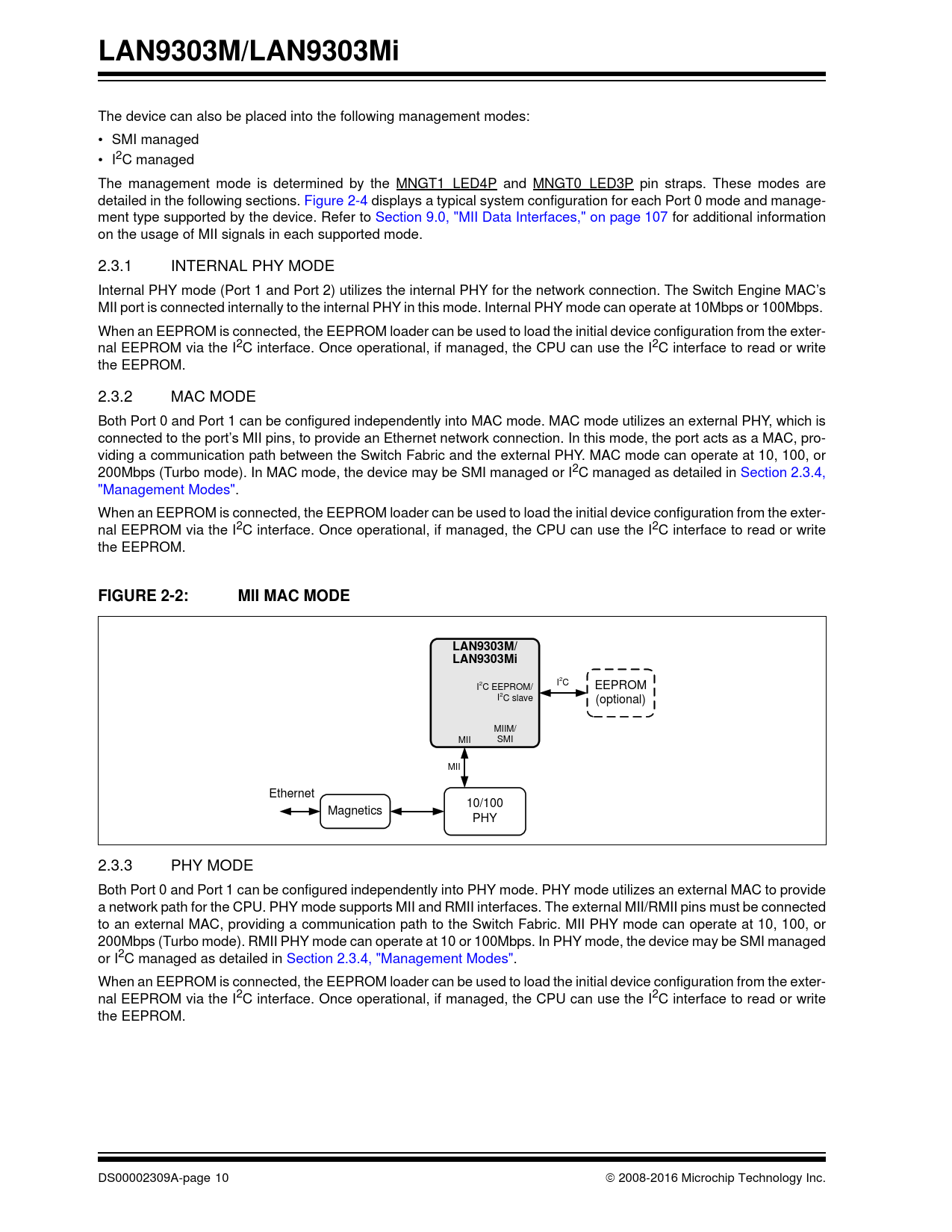

The device can also be placed into the following management modes: • SMI managed • I2C managed The management mode is determined by the MNGT1_LED4P and MNGT0_LED3P pin straps. These modes are detailed in the following sections. Figure 2-4 displays a typical system configuration for each Port 0 mode and manage- ment type supported by the device. Refer to Section 9.0, "MII Data Interfaces," on page 107 for additional information on the usage of MII signals in each supported mode. 2.3.1 INTERNAL PHY MODE Internal PHY mode (Port 1 and Port 2) utilizes the internal PHY for the network connection. The Switch Engine MAC’s MII port is connected internally to the internal PHY in this mode. Internal PHY mode can operate at 10Mbps or 100Mbps. When an EEPROM is connected, the EEPROM loader can be used to load the initial device configuration from the exter- nal EEPROM via the I2C interface. Once operational, if managed, the CPU can use the I2C interface to read or write the EEPROM. 2.3.2 MAC MODE Both Port 0 and Port 1 can be configured independently into MAC mode. MAC mode utilizes an external PHY, which is connected to the port’s MII pins, to provide an Ethernet network connection. In this mode, the port acts as a MAC, pro- viding a communication path between the Switch Fabric and the external PHY. MAC mode can operate at 10, 100, or 200Mbps (Turbo mode). In MAC mode, the device may be SMI managed or I2C managed as detailed in Section 2.3.4, "Management Modes". When an EEPROM is connected, the EEPROM loader can be used to load the initial device configuration from the exter- nal EEPROM via the I2C interface. Once operational, if managed, the CPU can use the I2C interface to read or write the EEPROM.
FIGURE 2-2: MII MAC MODE LAN9303M/ LAN9303Mi
I2C I2C EEPROM/ EEPROM I2C slave (optional) MIIM/ MII SMI MII Ethernet 10/100 Magnetics PHY 2.3.3 PHY MODE Both Port 0 and Port 1 can be configured independently into PHY mode. PHY mode utilizes an external MAC to provide a network path for the CPU. PHY mode supports MII and RMII interfaces. The external MII/RMII pins must be connected to an external MAC, providing a communication path to the Switch Fabric. MII PHY mode can operate at 10, 100, or 200Mbps (Turbo mode). RMII PHY mode can operate at 10 or 100Mbps. In PHY mode, the device may be SMI managed or I2C managed as detailed in Section 2.3.4, "Management Modes". When an EEPROM is connected, the EEPROM loader can be used to load the initial device configuration from the exter- nal EEPROM via the I2C interface. Once operational, if managed, the CPU can use the I2C interface to read or write the EEPROM. DS00002309A-page 10
