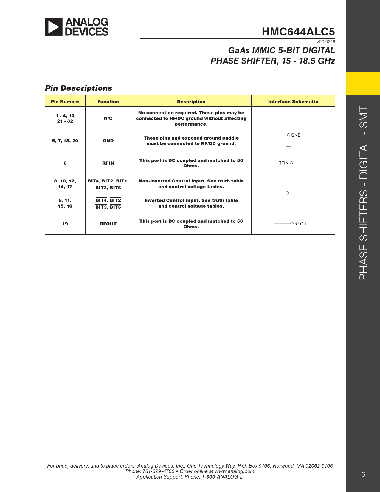

HMC644ALC5. GaAs MMIC 5-BIT DIGITAL. PHASE SHIFTER, 15 - 18.5 GHz. Pin Descriptions. Pin Number. Function. Description
HMC644ALC5 GaAs MMIC 5-BIT DIGITAL PHASE SHIFTER, 15 - 18.5 GHz Pin Descriptions Pin Number Function Description
HMC644ALC5
v00.0216
GaAs MMIC 5-BIT DIGITAL PHASE SHIFTER, 15 - 18.5 GHz Pin Descriptions Pin Number Function Description Interface Schematic No connection required. These pins may be
T
1 - 4, 13 N/C connected to RF/DC ground without affecting 21 - 32
M
performance. These pins and exposed ground paddle 5, 7, 18, 20 GND must be connected to RF/DC ground.
L - S
This port is DC coupled and matched to 50
ITA
6 RFIN Ohms.
IG
8, 10, 12, BIT4, BIT2, BIT1, Non-Inverted Control Input. See truth table 14, 17 BIT3, BIT5 and control voltage tables.
S - D
9, 11, BIT4, BIT2 Inverted Control Input. See truth table 15, 16 BIT3, BIT5 and control voltage tables. This port is DC coupled and matched to 50 19 RFOUT Ohms.
