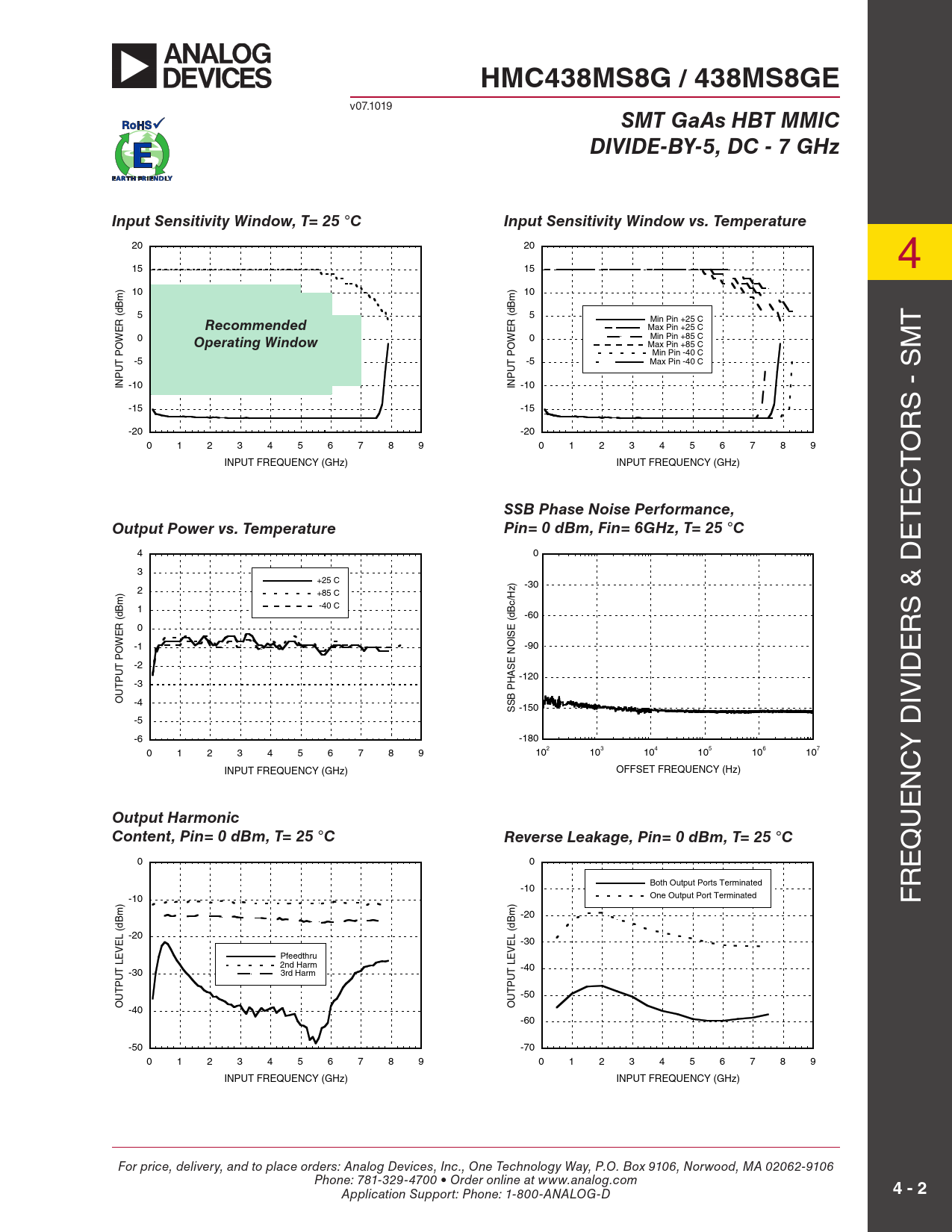

DescriptionSMT GaAs HBT MMIC Divide-by-5, DC - 7 GHz
Pages / Page6 / 2 — HMC438MS8G / 438MS8GE. SMT GaAs HBT MMIC. DIVIDE-BY-5, DC - 7 GHz. Input …
File Format / SizePDF / 460 Kb
HMC438MS8G / 438MS8GE. SMT GaAs HBT MMIC. DIVIDE-BY-5, DC - 7 GHz. Input Sensitivity Window, T= 25 °C
HMC438MS8G / 438MS8GE SMT GaAs HBT MMIC DIVIDE-BY-5, DC - 7 GHz Input Sensitivity Window, T= 25 °C
v07.1019
SMT GaAs HBT MMIC DIVIDE-BY-5, DC - 7 GHz Input Sensitivity Window, T= 25 °C Input Sensitivity Window vs. Temperature
4 20 20 15 15 4 ) 10 ) m 10 m T dB dB ( 5 ( 5 R
Recommended
Min Pin +25 C R Max Pin +25 C T M WE 0
Operating Window
WE 0 Min Pin +85 C Max Pin +85 C M PO Min Pin -40 C PO T -5 T -5 Max Pin -40 C U U P P S - S -10 IN -10 IN -15 -15 S - S R -20 -20 R O 0 1 2 3 4 5 6 7 8 9 0 1 2 3 4 5 6 7 8 9 O T INPUT FREQUENCY (GHz) INPUT FREQUENCY (GHz) T C C E E T
SSB Phase Noise Performance,
T E
Output Power vs. Temperature Pin= 0 dBm, Fin= 6GHz, T= 25 °C
E 4 0 3 +25 C -30 S & D 2 +85 C 1 -40 C -60 S & D R (dBc/Hz) 0 R E -1 -90 NOISE E ID -2 -120 ID IV -3 PHASE OUTPUT POWER (dBm) -4 IV SSB -150 -5 Y D -6 -180 0 1 2 3 4 5 6 7 8 9 102 103 104 105 106 107 Y D C INPUT FREQUENCY (GHz) OFFSET FREQUENCY (Hz) C N N E E U
Output Harmonic
U Q
Content, Pin= 0 dBm, T= 25 °C Reverse Leakage, Pin= 0 dBm, T= 25 °C
Q E 0 0 E R -10 Both Output Ports Terminated R F One Output Port Terminated -10 F -20 -20 -30 Pfeedthru 2nd Harm -40 -30 3rd Harm -50 OUTPUT LEVEL (dBm) OUTPUT LEVEL (dBm) -40 -60 -50 -70 0 1 2 3 4 5 6 7 8 9 0 1 2 3 4 5 6 7 8 9 INPUT FREQUENCY (GHz) INPUT FREQUENCY (GHz) For price, delivery, and to place orders: Analog Devices, Inc., One Technology Way, P.O. Box 9106, Norwood, MA 02062-9106 Phone: 781-329-4700 • Order online at www.analog.com
