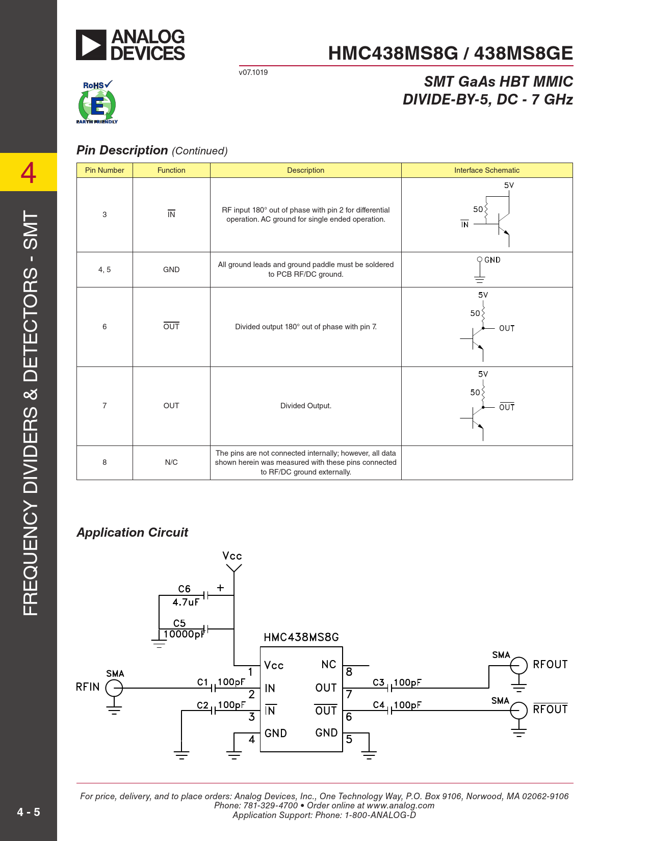

SMT GaAs HBT MMIC DIVIDE-BY-5, DC - 7 GHz Pin Description
(Continued) 4 Pin Number Function Description Interface Schematic 4 T RF input 180° out of phase with pin 2 for differential 3 IN operation. AC ground for single ended operation. T M M S - S All ground leads and ground paddle must be soldered 4, 5 GND to PCB RF/DC ground. S - S R R O O T T C 6 OUT Divided output 180° out of phase with pin 7. C E E T T E E S & D 7 OUT Divided Output. S & D R R E E ID The pins are not connected internally; however, all data 8 N/C shown herein was measured with these pins connected ID IV to RF/DC ground externally. IV Y D Y D C C N
Application Circuit
