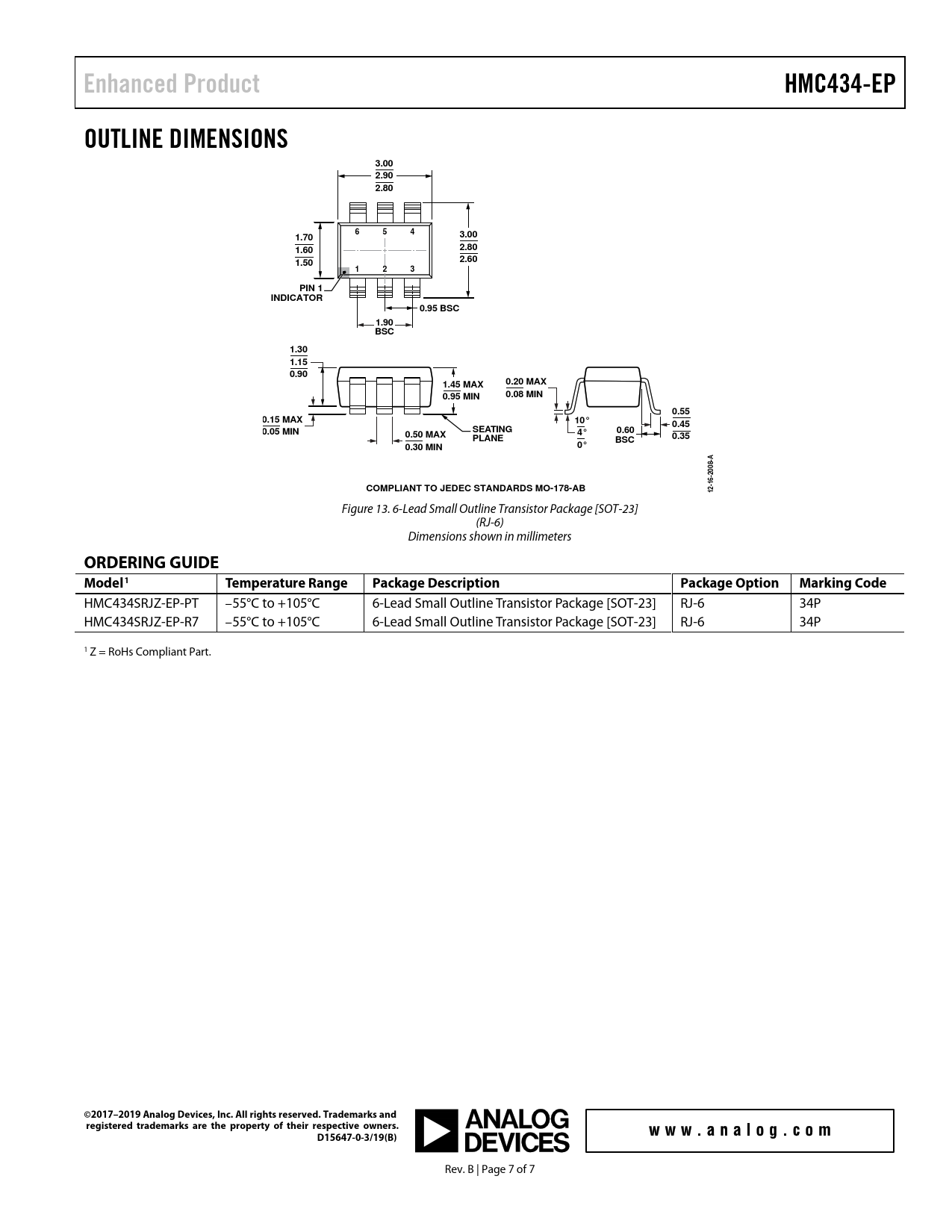

Enhanced Product. HMC434-EP. OUTLINE DIMENSIONS. 3.00 2.90 2.80. 3.00. 1.70. 2.80. 1.60. 2.60. 1.50. PIN 1. INDICATOR. 0.95 BSC. 1.90. BSC
link to page 7
Enhanced Product HMC434-EP OUTLINE DIMENSIONS 3.00 2.90 2.80 6 5 4 3.00 1.70 2.80 1.60 2.60 1.50 1 2 3 PIN 1 INDICATOR 0.95 BSC 1.90 BSC 1.30 1.15 0.90 1.45 MAX 0.20 MAX 0.95 MIN 0.08 MIN 0.55 0.15 MAX 10° 0.45 SEATING 0.05 MIN 4° 0.60 0.50 MAX PLANE BSC 0.35 0° 0.30 MIN -A 8 0 0 -2 6 COMPLIANT TO JEDEC STANDARDS MO-178-AB -1 2 1
Figure 13. 6-Lead Small Outline Transistor Package [SOT-23] (RJ-6) Dimensions shown in millimeters
ORDERING GUIDE Model1 Temperature Range Package Description Package Option Marking Code
HMC434SRJZ-EP-PT –55°C to +105°C 6-Lead Small Outline Transistor Package [SOT-23] RJ-6 34P HMC434SRJZ-EP-R7 –55°C to +105°C 6-Lead Small Outline Transistor Package [SOT-23] RJ-6 34P 1 Z = RoHs Compliant Part.
