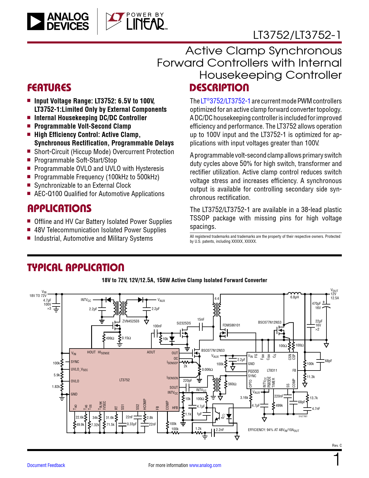

LT3752/LT3752-1 Active Clamp Synchronous Forward Controllers with Internal Housekeeping Controller
FEATURES DESCRIPTION
n
Input Voltage Range: LT3752: 6.5V to 100V,
The LT®3752/LT3752-1 are current mode PWM controllers
LT3752-1:Limited Only by External Components
optimized for an active clamp forward converter topology. n
Internal Housekeeping DC/DC Controller
A DC/DC housekeeping controller is included for improved n
Programmable Volt-Second Clamp
efficiency and performance. The LT3752 allows operation n
High Efficiency Control: Active Clamp,
up to 100V input and the LT3752-1 is optimized for ap-
Synchronous Rectification, Programmable Delays
plications with input voltages greater than 100V. n Short-Circuit (Hiccup Mode) Overcurrent Protection A programmable volt-second clamp allows primary switch n Programmable Soft-Start/Stop duty cycles above 50% for high switch, transformer and n Programmable OVLO and UVLO with Hysteresis rectifier utilization. Active clamp control reduces switch n Programmable Frequency (100kHz to 500kHz) voltage stress and increases efficiency. A synchronous n Synchronizable to an External Clock output is available for controlling secondary side syn- n AEC-Q100 Qualified for Automotive Applications chronous rectification.
APPLICATIONS
The LT3752/LT3752-1 are available in a 38-lead plastic n TSSOP package with missing pins for high voltage Offline and HV Car Battery Isolated Power Supplies n spacings. 48V Telecommunication Isolated Power Supplies n Industrial, Automotive and Military Systems All registered trademarks and trademarks are the property of their respective owners. Protected by U.S. patents, including XXXXX, XXXXX.
TYPICAL APPLICATION 18V to 72V, 12V/12.5A, 150W Active Clamp Isolated Forward Converter
