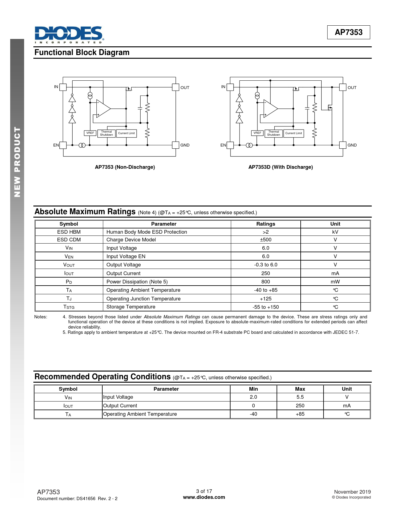

Pages / Page17 / 3 — AP7353. Functional Block Diagram. T C. U D. O R. AP7353 (Non-Discharge). …
AP7353. Functional Block Diagram. T C. U D. O R. AP7353 (Non-Discharge). AP7353D (With Discharge). Absolute Maximum Ratings. Symbol
AP7353 Functional Block Diagram T C U D O R AP7353 (Non-Discharge) AP7353D (With Discharge) Absolute Maximum Ratings Symbol
IN OUT IN OUT
T C
VREF Thermal Current Limit VREF Thermal Current Limit Shutdown Shutdown
U D
EN GND EN GND
O R AP7353 (Non-Discharge) AP7353D (With Discharge) P W E N Absolute Maximum Ratings
(Note 4) (@TA = +25°C, unless otherwise specified.)
Symbol Parameter Ratings Unit
ESD HBM Human Body Mode ESD Protection >2 kV ESD CDM Charge Device Model ±500 V VIN Input Voltage 6.0 V VEN Input Voltage EN 6.0 V VOUT Output Voltage -0.3 to 6.0 V IOUT Output Current 250 mA P D Power Dissipation (Note 5) 800 mW TA Operating Ambient Temperature -40 to +85 °C TJ Operating Junction Temperature +125 °C TSTG Storage Temperature -55 to +150 °C Notes: 4. Stresses beyond those listed under Absolute Maximum Ratings can cause permanent damage to the device. These are stress ratings only and functional operation of the device at these conditions is not implied. Exposure to absolute-maximum-rated conditions for extended periods can affect device reliability. 5. Ratings apply to ambient temperature at +25°C. The device mounted on FR-4 substrate PC board and calculated in accordance with JEDEC 51-7.
Recommended Operating Conditions
Symbol Parameter Min Max Unit
VIN Input Voltage 2.0 5.5 V IOUT Output Current 0 250 mA TA Operating Ambient Temperature -40 +85 °C AP7353 3 of 17 November 2019 Document number: DS41656 Rev. 2 - 2
