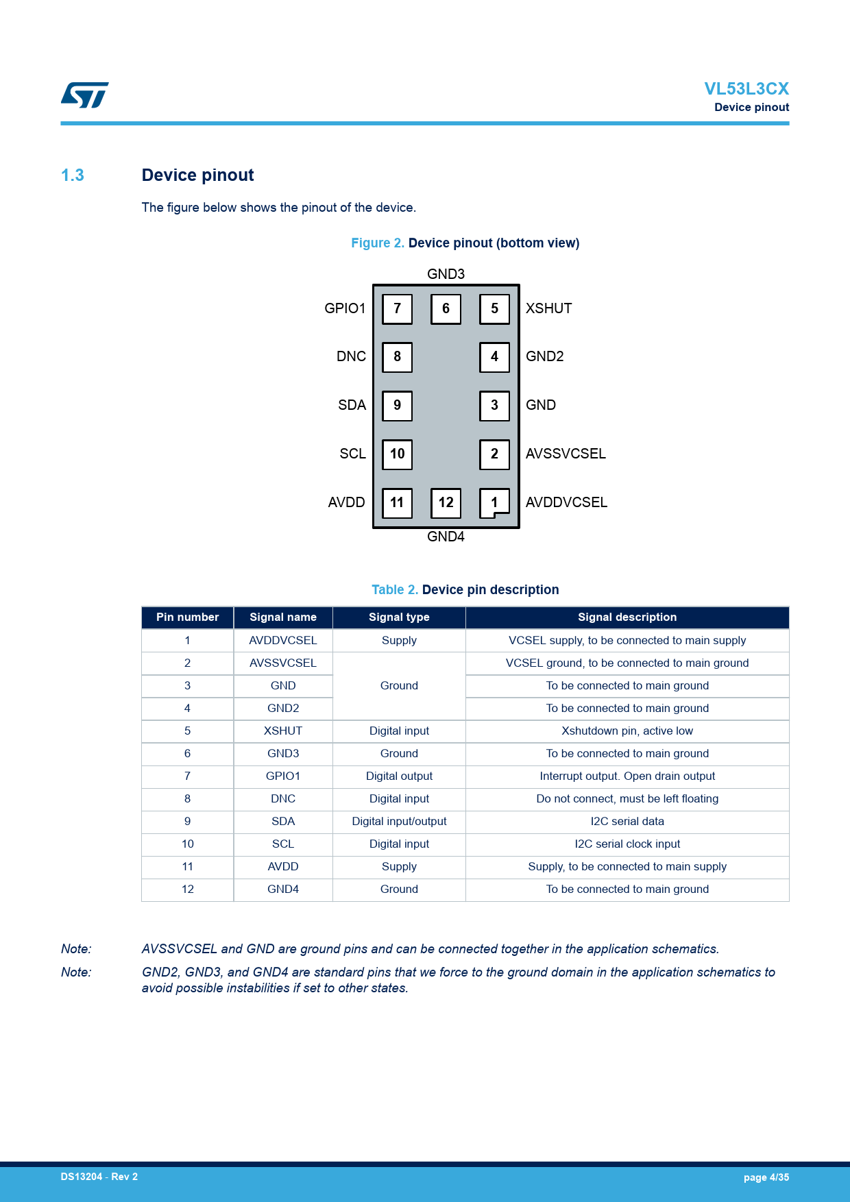

VL53L3CX Device pinout 1.3 Device pinout
The figure below shows the pinout of the device.
Figure 2. Device pinout (bottom view)
GND3 GPIO1
7 6 5
XSHUT DNC
8 4
GND2 SDA
9 3
GND SCL
10 2
AVSSVCSEL AVDD
11 12 1
AVDDVCSEL GND4
Table 2. Device pin description Pin number Signal name Signal type Signal description
1 AVDDVCSEL Supply VCSEL supply, to be connected to main supply 2 AVSSVCSEL VCSEL ground, to be connected to main ground 3 GND Ground To be connected to main ground 4 GND2 To be connected to main ground 5 XSHUT Digital input Xshutdown pin, active low 6 GND3 Ground To be connected to main ground 7 GPIO1 Digital output Interrupt output. Open drain output 8 DNC Digital input Do not connect, must be left floating 9 SDA Digital input/output I2C serial data 10 SCL Digital input I2C serial clock input 11 AVDD Supply Supply, to be connected to main supply 12 GND4 Ground To be connected to main ground Note: AVSSVCSEL and GND are ground pins and can be connected together in the application schematics. Note: GND2, GND3, and GND4 are standard pins that we force to the ground domain in the application schematics to avoid possible instabilities if set to other states.
