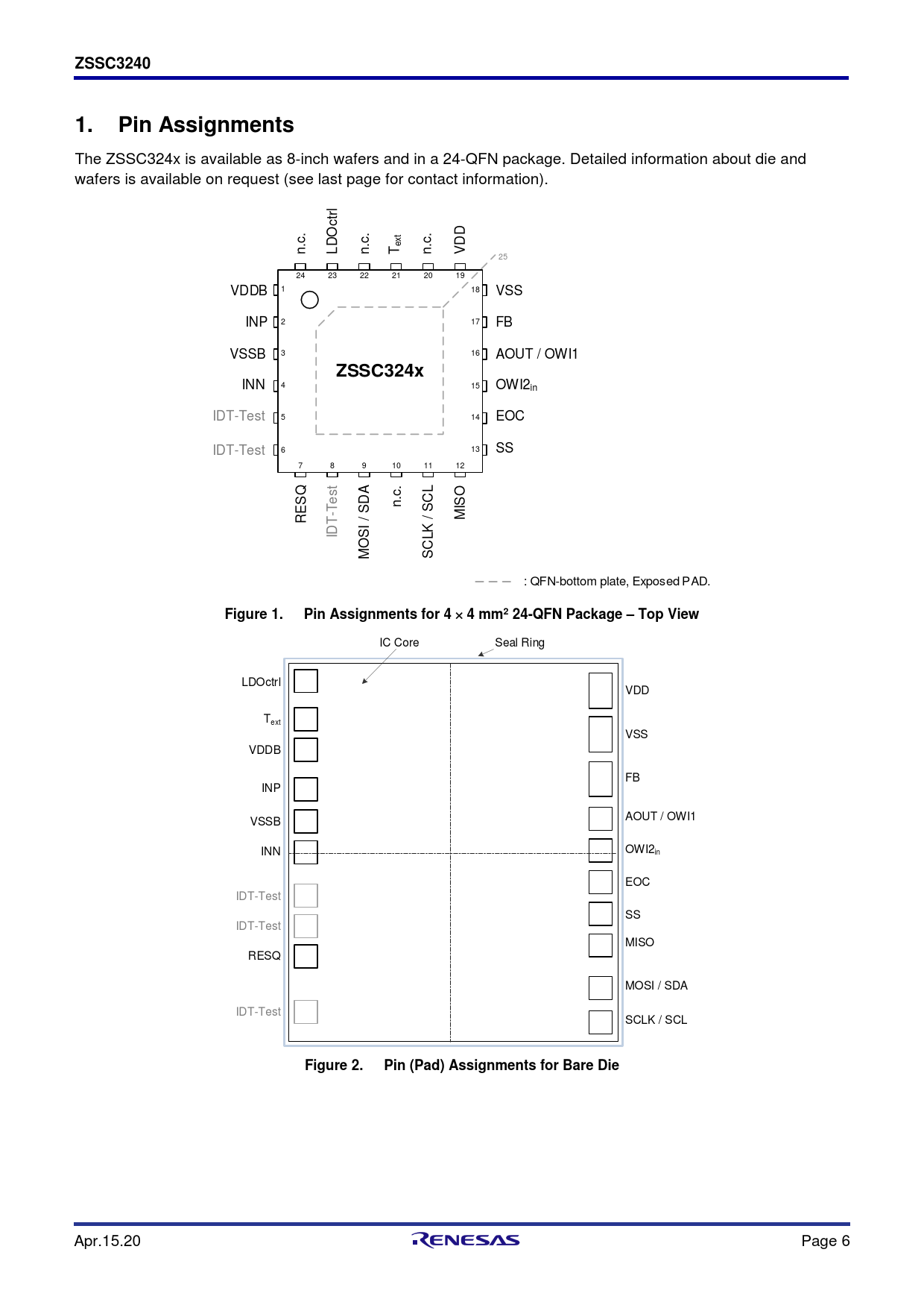

ZSSC3240. 1. Pin Assignments. ZSSC324x. Figure 1. Pin Assignments for 4. 4 mm2 24-QFN Package – Top View. Figure 2
ZSSC3240 1 Pin Assignments ZSSC324x Figure 1 Pin Assignments for 4 4 mm2 24-QFN Package – Top View Figure 2
ZSSC3240 1. Pin Assignments
The ZSSC324x is available as 8-inch wafers and in a 24-QFN package. Detailed information about die and wafers is available on request (see last page for contact information). rl ct . O . t . D .c D .c ex .c n L n T n VD 25 24 23 22 21 20 19 1 18 VDDB VSS INP 2 17 FB VSSB 3 16 AOUT / OWI1
ZSSC324x
INN 4 15 OWI2in IDT-Test 5 14 EOC 6 IDT-Test 13 SS 7 8 9 10 11 12 t . s A L e .c n SO ESQ -T SD SC / MI R T / ID SI K L MO SC : QFN-bottom plate, Exposed PAD.
IC Core Seal Ring LDOctrl VDD Text VSS VDDB FB INP VSSB AOUT / OWI1 INN OWI2in EOC IDT-Test SS IDT-Test MISO RESQ MOSI / SDA IDT-Test SCLK / SCL
Figure 2. Pin (Pad) Assignments for Bare Die
