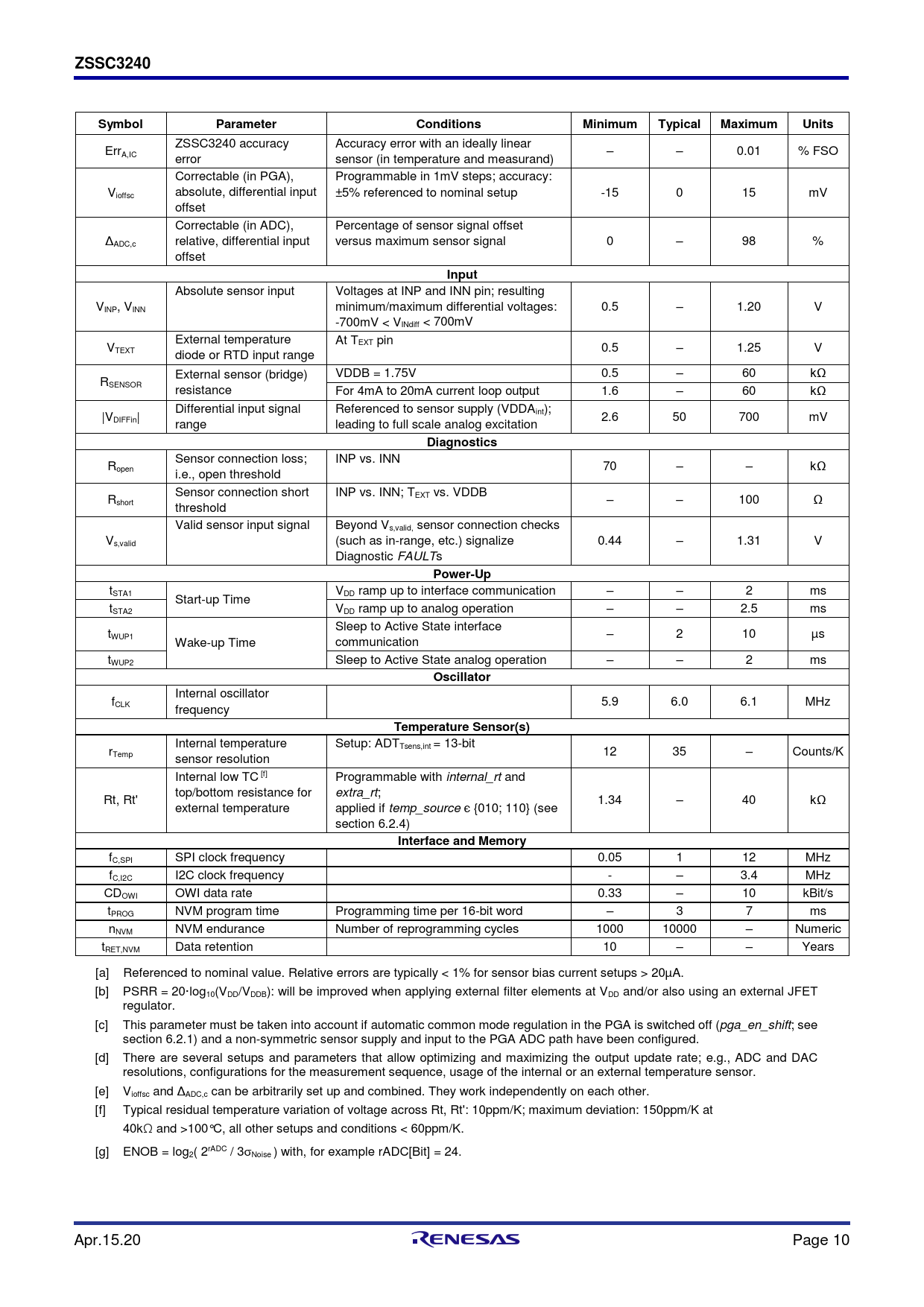

Datasheet ZSSC3240 (Renesas) - 10
ManufacturerRenesas
DescriptionSensor Signal Conditioner IC for Resistive Sensors
Pages / Page64 / 10 — ZSSC3240. Symbol. Parameter. Conditions. Minimum. Typical. Maximum. …
Revision20200414
ZSSC3240. Symbol. Parameter. Conditions. Minimum. Typical. Maximum. Units. Input. Diagnostics. Power-Up. Oscillator. Temperature Sensor(s)
ZSSC3240 Symbol Parameter Conditions Minimum Typical Maximum Units Input Diagnostics Power-Up Oscillator Temperature Sensor(s)
link to page 10 link to page 17 link to page 13
ZSSC3240 accuracy Accuracy error with an ideally linear ErrA,IC – – 0.01 % FSO error sensor (in temperature and measurand) Correctable (in PGA), Programmable in 1mV steps; accuracy: Vioffsc absolute, differential input ±5% referenced to nominal setup -15 0 15 mV offset Correctable (in ADC), Percentage of sensor signal offset ΔADC,c relative, differential input versus maximum sensor signal 0 – 98 % offset
Input
Absolute sensor input Voltages at INP and INN pin; resulting VINP, VINN minimum/maximum differential voltages: 0.5 – 1.20 V -700mV < VINdiff < 700mV External temperature At T V EXT pin TEXT 0.5 – 1.25 V diode or RTD input range External sensor (bridge) VDDB = 1.75V 0.5 – 60 kΩ RSENSOR resistance For 4mA to 20mA current loop output 1.6 – 60 kΩ Differential input signal Referenced to sensor supply (VDDA |V int); DIFFin| 2.6 50 700 mV range leading to full scale analog excitation
Diagnostics
Sensor connection loss; INP vs. INN Ropen 70 – – kΩ i.e., open threshold Sensor connection short INP vs. INN; T R EXT vs. VDDB short – – 100 Ω threshold Valid sensor input signal Beyond Vs,valid, sensor connection checks Vs,valid (such as in-range, etc.) signalize 0.44 – 1.31 V Diagnostic FAULTs
Power-Up
tSTA1 VDD ramp up to interface communication – – 2 ms Start-up Time tSTA2 VDD ramp up to analog operation – – 2.5 ms Sleep to Active State interface tWUP1 – 2 10 µs Wake-up Time communication tWUP2 Sleep to Active State analog operation – – 2 ms
Oscillator
Internal oscillator fCLK 5.9 6.0 6.1 MHz frequency
Internal temperature Setup: ADT r Tsens,int = 13-bit Temp 12 35 – Counts/K sensor resolution Internal low TC [f] Programmable with internal_rt and top/bottom resistance for extra_rt; Rt, Rt' 1.34 – 40 kΩ external temperature applied if temp_source є {010; 110} (see section 6.2.4)
