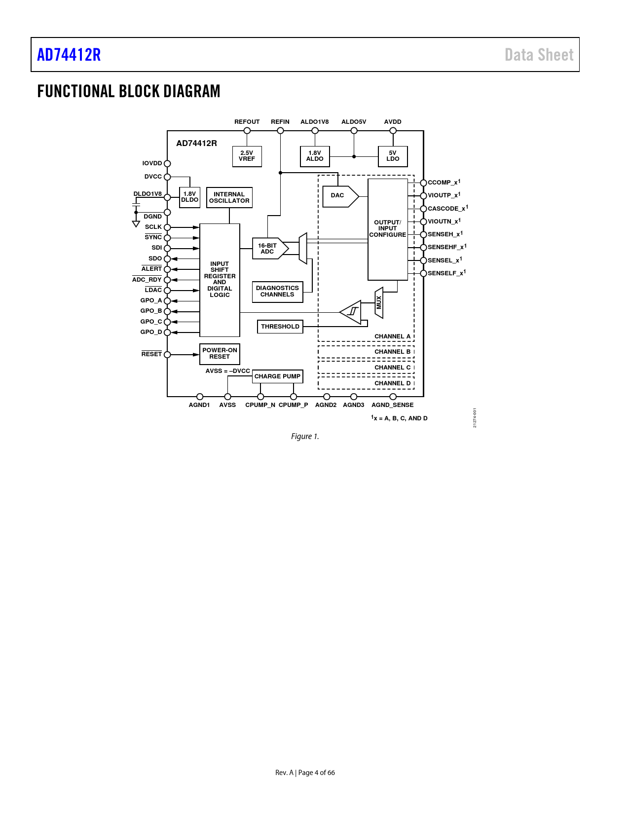

AD74412R. Data Sheet. FUNCTIONAL BLOCK DIAGRAM. REFOUT. REFIN. ALDO1V8. ALDO5V. AVDD. 2.5V. 1.8V. VREF. ALDO. LDO. IOVDD. DVCC. CCOMP_x1. DLDO1V8
AD74412R Data Sheet FUNCTIONAL BLOCK DIAGRAM REFOUT REFIN ALDO1V8 ALDO5V AVDD 2.5V 1.8V VREF ALDO LDO IOVDD DVCC CCOMP_x1 DLDO1V8
AD74412R Data Sheet FUNCTIONAL BLOCK DIAGRAM REFOUT REFIN ALDO1V8 ALDO5V AVDD AD74412R 2.5V 1.8V 5V VREF ALDO LDO IOVDD DVCC CCOMP_x1 DLDO1V8 1.8V INTERNAL DAC VIOUTP_x1 DLDO OSCILLATOR CASCODE_x1 DGND OUTPUT/ VIOUTN_x1 SCLK INPUT SYNC CONFIGURE SENSEH_x1 SDI 16-BIT SENSEHF_x1 ADC SDO SENSEL_x1 INPUT ALERT SHIFT SENSELF_x1 REGISTER ADC_RDY AND DIGITAL LDAC DIAGNOSTICS LOGIC CHANNELS GPO_A UX M GPO_B GPO_C THRESHOLD GPO_D CHANNEL A POWER-ON CHANNEL B RESET RESET CHANNEL C AVSS = –DVCC CHARGE PUMP CHANNEL D AGND1 AVSS CPUMP_N CPUMP_P AGND2 AGND3 AGND_SENSE
