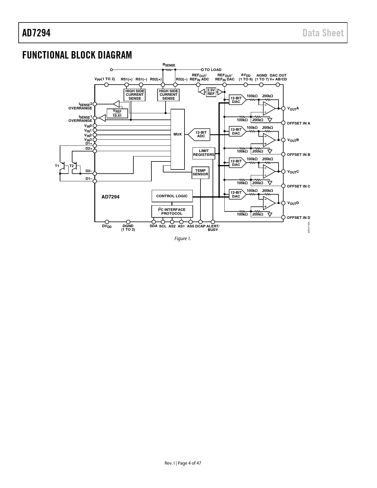

AD7294. Data Sheet. FUNCTIONAL BLOCK DIAGRAM. RSENSE. TO LOAD. REF. OUT/. AVDD. AGND DAC OUT. VPP(1 TO 2). RS1(+) RS1(–) RS2(+). RS2(–) REF
AD7294 Data Sheet FUNCTIONAL BLOCK DIAGRAM RSENSE TO LOAD REF OUT/ AVDD AGND DAC OUT VPP(1 TO 2) RS1(+) RS1(–) RS2(+) RS2(–) REF
AD7294 Data Sheet FUNCTIONAL BLOCK DIAGRAM RSENSE TO LOAD REF REF OUT/ OUT/ AVDD AGND DAC OUT VPP(1 TO 2) RS1(+) RS1(–) RS2(+) RS2(–) REF REF IN ADC IN DAC (1 TO 6) (1 TO 7) V+ AB/CD HIGH SIDE HIGH SIDE 2.5V CURRENT CURRENT REF 100kΩ 200kΩ SENSE SENSE 12-BIT DAC ISENSE2 OVERRANGE V V OUTA REF 10.41 ISENSE1 OVERRANGE 100kΩ 200kΩ OFFSET IN A VIN0 100kΩ 200kΩ V 12-BIT IN1 12-BIT DAC V MUX IN2 ADC VIN3 VOUTB D1+ D2+ LIMIT 100kΩ 200kΩ REGISTERS OFFSET IN B 100kΩ 200kΩ 12-BIT T1 T2 DAC D2– TEMP V SENSOR OUTC D1– 100kΩ 200kΩ OFFSET IN C 100kΩ 200kΩ 12-BIT CONTROL LOGIC AD7294 DAC VOUTD I2C INTERFACE PROTOCOL 100kΩ 200kΩ OFFSET IN D
