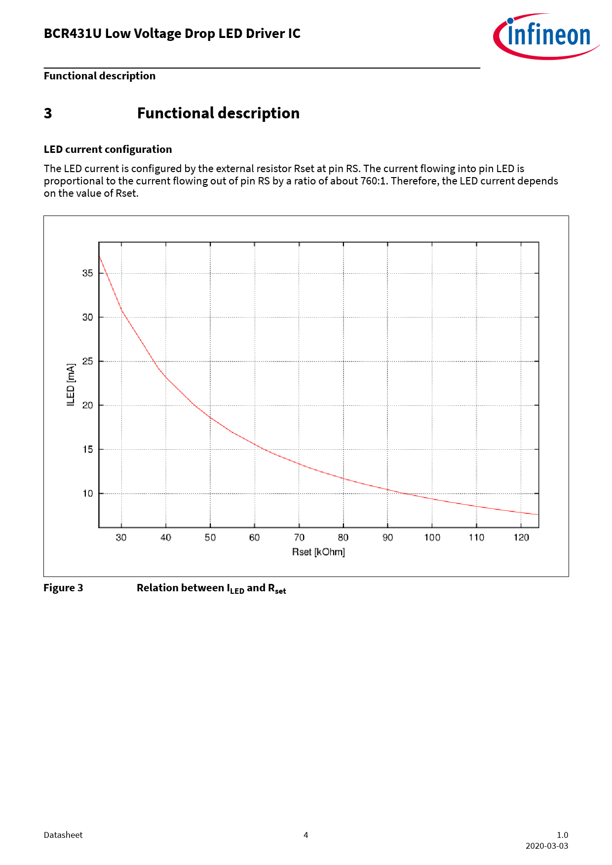

BCR431U Low Voltage Drop LED Driver IC Functional description 3 Functional description LED current configuration
The LED current is configured by the external resistor Rset at pin RS. The current flowing into pin LED is proportional to the current flowing out of pin RS by a ratio of about 760:1. Therefore, the LED current depends on the value of Rset.
Figure 3 Relation between ILED and Rset
