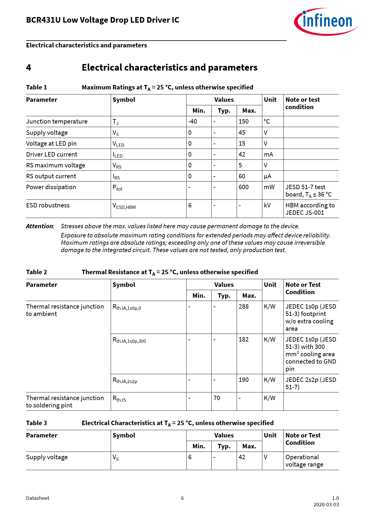

BCR431U Low Voltage Drop LED Driver IC. Electrical characteristics and parameters. Table 1
BCR431U Low Voltage Drop LED Driver IC Electrical characteristics and parameters Table 1
BCR431U Low Voltage Drop LED Driver IC Electrical characteristics and parameters 4 Electrical characteristics and parameters Table 1 Maximum Ratings at TA = 25 °C, unless otherwise specified Parameter Symbol Values Unit Note or test condition Min. Typ. Max.
Junction temperature TJ -40 - 150 °C Supply voltage VS 0 - 45 V Voltage at LED pin VLED 0 - 15 V Driver LED current ILED 0 - 42 mA RS maximum voltage VRS 0 - 5 V RS output current IRS 0 - 60 µA Power dissipation Ptot - - 600 mW JESD 51-7 test board, TA ≤ 36 °C ESD robustness VESD,HBM 6 - - kV HBM according to JEDEC JS-001
Attention
: Stresses above the max. values listed here may cause permanent damage to the device. Exposure to absolute maximum rating conditions for extended periods may affect device reliability. Maximum ratings are absolute ratings; exceeding only one of these values may cause irreversible damage to the integrated circuit. These values are not tested, only production test.
Table 2 Thermal Resistance at TA = 25 °C, unless otherwise specified Parameter Symbol Values Unit Note or Test Condition Min. Typ. Max.
Thermal resistance junction RthJA,1s0p,0 - - 288 K/W JEDEC 1s0p (JESD to ambient 51-3) footprint w/o extra cooling area RthJA,1s0p,300 - - 182 K/W JEDEC 1s0p (JESD 51-3) with 300 mm² cooling area connected to GND pin RthJA,2s2p - - 190 K/W JEDEC 2s2p (JESD 51-7) Thermal resistance junction RthJS - 70 - K/W to soldering pint
Table 3 Electrical Characteristics at TA = 25 °C, unless otherwise specified Parameter Symbol Values Unit Note or Test Condition Min. Typ. Max.
Supply voltage VS 6 - 42 V Operational voltage range Datasheet 6 1.0 2020-03-03 Document Outline Features Advantages with respect to discrete solutions Potential Applications Description Table of contents 1 Application circuit 2 Pin configuration 3 Functional description 4 Electrical characteristics and parameters 5 Package dimensions 6 References Revision history Disclaimer
