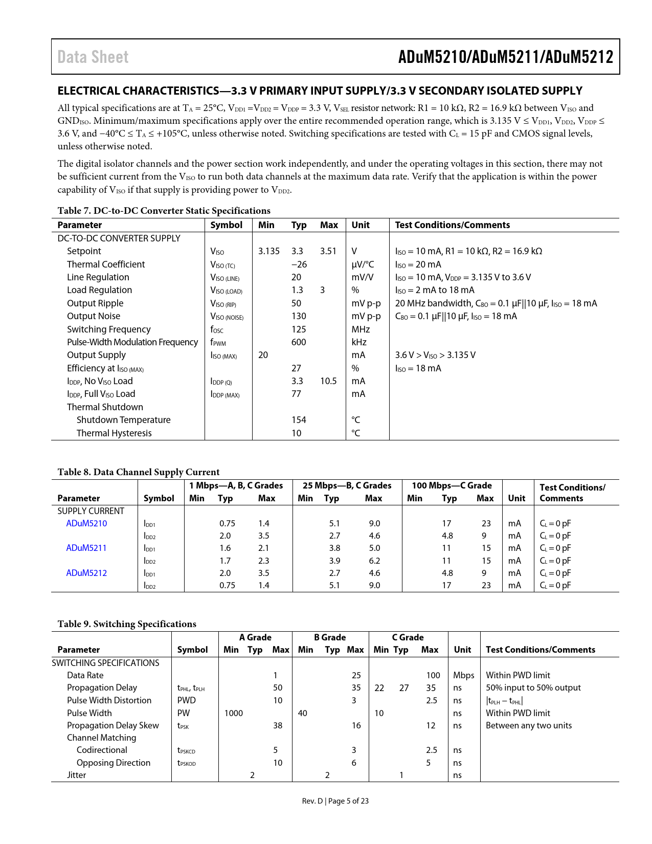

Data Sheet ADuM5210/ADuM5211/ADuM5212 ELECTRICAL CHARACTERISTICS—3.3 V PRIMARY INPUT SUPPLY/3.3 V SECONDARY ISOLATED SUPPLY
All typical specifications are at TA = 25°C, VDD1 =VDD2 = VDDP = 3.3 V, VSEL resistor network: R1 = 10 kΩ, R2 = 16.9 kΩ between VISO and GNDISO. Minimum/maximum specifications apply over the entire recommended operation range, which is 3.135 V ≤ VDD1, VDD2, VDDP ≤ 3.6 V, and −40°C ≤ TA ≤ +105°C, unless otherwise noted. Switching specifications are tested with CL = 15 pF and CMOS signal levels, unless otherwise noted. The digital isolator channels and the power section work independently, and under the operating voltages in this section, there may not be sufficient current from the VISO to run both data channels at the maximum data rate. Verify that the application is within the power capability of VISO if that supply is providing power to VDD2.
Table 7. DC-to-DC Converter Static Specifications Parameter Symbol Min Typ Max Unit Test Conditions/Comments
DC-TO-DC CONVERTER SUPPLY Setpoint VISO 3.135 3.3 3.51 V IISO = 10 mA, R1 = 10 kΩ, R2 = 16.9 kΩ Thermal Coefficient VISO (TC) −26 μV/°C IISO = 20 mA Line Regulation VISO (LINE) 20 mV/V IISO = 10 mA, VDDP = 3.135 V to 3.6 V Load Regulation VISO (LOAD) 1.3 3 % IISO = 2 mA to 18 mA Output Ripple VISO (RIP) 50 mV p-p 20 MHz bandwidth, CBO = 0.1 μF||10 μF, IISO = 18 mA Output Noise VISO (NOISE) 130 mV p-p CBO = 0.1 μF||10 μF, IISO = 18 mA Switching Frequency fOSC 125 MHz Pulse-Width Modulation Frequency fPWM 600 kHz Output Supply IISO (MAX) 20 mA 3.6 V > VISO > 3.135 V Efficiency at IISO (MAX) 27 % IISO = 18 mA IDDP, No VISO Load IDDP (Q) 3.3 10.5 mA IDDP, Full VISO Load IDDP (MAX) 77 mA Thermal Shutdown Shutdown Temperature 154 °C Thermal Hysteresis 10 °C
Table 8. Data Channel Supply Current 1 Mbps—A, B, C Grades 25 Mbps—B, C Grades 100 Mbps—C Grade Test Conditions/ Parameter Symbol Min Typ Max Min Typ Max Min Typ Max Unit Comments
SUPPLY CURRENT ADuM5210 IDD1 0.75 1.4 5.1 9.0 17 23 mA CL = 0 pF IDD2 2.0 3.5 2.7 4.6 4.8 9 mA CL = 0 pF ADuM5211 IDD1 1.6 2.1 3.8 5.0 11 15 mA CL = 0 pF IDD2 1.7 2.3 3.9 6.2 11 15 mA CL = 0 pF ADuM5212 IDD1 2.0 3.5 2.7 4.6 4.8 9 mA CL = 0 pF IDD2 0.75 1.4 5.1 9.0 17 23 mA CL = 0 pF
Table 9. Switching Specifications A Grade B Grade C Grade Parameter Symbol Min Typ Max Min Typ Max Min Typ Max Unit Test Conditions/Comments
SWITCHING SPECIFICATIONS Data Rate 1 25 100 Mbps Within PWD limit Propagation Delay tPHL, tPLH 50 35 22 27 35 ns 50% input to 50% output Pulse Width Distortion PWD 10 3 2.5 ns |tPLH − tPHL| Pulse Width PW 1000 40 10 ns Within PWD limit Propagation Delay Skew tPSK 38 16 12 ns Between any two units Channel Matching Codirectional tPSKCD 5 3 2.5 ns Opposing Direction tPSKOD 10 6 5 ns Jitter 2 2 1 ns Rev. D | Page 5 of 23 Document Outline FEATURES APPLICATIONS FUNCTIONAL BLOCK DIAGRAM GENERAL DESCRIPTION TABLE OF CONTENTS REVISION HISTORY SPECIFICATIONS ELECTRICAL CHARACTERISTICS—5 V PRIMARY INPUT SUPPLY/5 V SECONDARY ISOLATED SUPPLY ELECTRICAL CHARACTERISTICS—3.3 V PRIMARY INPUT SUPPLY/3.3 V SECONDARY ISOLATED SUPPLY ELECTRICAL CHARACTERISTICS—5 V PRIMARY INPUT SUPPLY/3.3 V SECONDARY ISOLATED SUPPLY PACKAGE CHARACTERISTICS REGULATORY APPROVALS INSULATION AND SAFETY-RELATED SPECIFICATIONS DIN V VDE V 0884-10 (VDE V 0884-10) INSULATION CHARACTERISTICS RECOMMENDED OPERATING CONDITIONS ABSOLUTE MAXIMUM RATINGS ESD CAUTION PIN CONFIGURATIONS AND FUNCTION DESCRIPTIONS TRUTH TABLE TYPICAL PERFORMANCE CHARACTERISTICS APPLICATIONS INFORMATION PCB LAYOUT THERMAL ANALYSIS PROPAGATION DELAY PARAMETERS EMI CONSIDERATIONS DC CORRECTNESS AND MAGNETIC FIELD IMMUNITY POWER CONSUMPTION INSULATION LIFETIME OUTLINE DIMENSIONS ORDERING GUIDE
