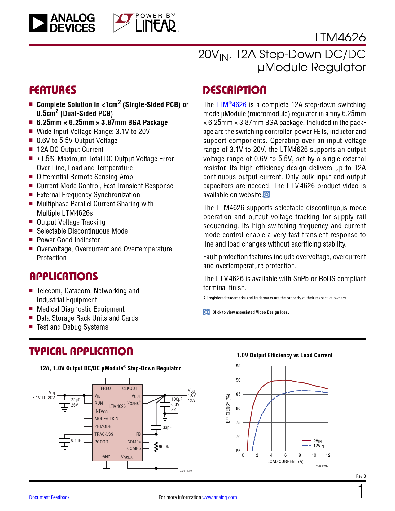

LTM4626 20VIN, 12A Step-Down DC/DC µModule Regulator
FEATURES DESCRIPTION
n
Complete Solution in <1cm2 (Single-Sided PCB) or
The LTM®4626 is a complete 12A step-down switching
0.5cm2 (Dual-Sided PCB)
mode µModule (micromodule) regulator in a tiny 6.25mm n
6.25mm × 6.25mm × 3.87mm BGA Package
× 6.25mm × 3.87mm BGA package. Included in the pack- n Wide Input Voltage Range: 3.1V to 20V age are the switching controller, power FETs, inductor and n 0.6V to 5.5V Output Voltage support components. Operating over an input voltage n 12A DC Output Current range of 3.1V to 20V, the LTM4626 supports an output n ±1.5% Maximum Total DC Output Voltage Error voltage range of 0.6V to 5.5V, set by a single external Over Line, Load and Temperature resistor. Its high efficiency design delivers up to 12A n Differential Remote Sensing Amp continuous output current. Only bulk input and output n Current Mode Control, Fast Transient Response capacitors are needed. The LTM4626 product video is n External Frequency Synchronization available on website. n Multiphase Parallel Current Sharing with The LTM4626 supports selectable discontinuous mode Multiple LTM4626s operation and output voltage tracking for supply rail n Output Voltage Tracking sequencing. Its high switching frequency and current n Selectable Discontinuous Mode mode control enable a very fast transient response to n Power Good Indicator line and load changes without sacrificing stability. n Overvoltage, Overcurrent and Overtemperature Protection Fault protection features include overvoltage, overcurrent and overtemperature protection.
APPLICATIONS
The LTM4626 is available with SnPb or RoHS compliant n terminal finish. Telecom, Datacom, Networking and Industrial Equipment All registered trademarks and trademarks are the property of their respective owners. n Medical Diagnostic Equipment
Click to view associated Video Design Idea.
n Data Storage Rack Units and Cards n Test and Debug Systems
TYPICAL APPLICATION 1.0V Output Efficiency vs Load Current 12A, 1.0V Output DC/DC µModule
Step-Down Regulator
95 90 FREQ CLKOUT V VOUT IN V 85 IN VOUT 3.1V TO 20V 1.0V 22µF 100µF 12A RUN V + 25V LTM4626 OSNS 6.3V INTV ×2 80 CC MODE/CLKIN EFFICIENCY (%) 75 PHMODE 33pF TRACK/SS FB 70 0.1µF PGOOD COMPa 5VIN 12V COMPb 90.9k IN 65 GND V – 0 2 4 6 8 10 12 OSNS LOAD CURRENT (A) 4626 TA01b 4626 TA01a Rev B Document Feedback For more information www.analog.com 1 Document Outline Features Applications Typical Application Description Absolute Maximum Ratings Order Information Electrical Characteristics Pin Configuration Typical Performance Characteristics Pin Functions Block Diagram Decoupling Requirements Operation Applications Information Package Description Revision History Package Photo Design Resources Related Parts
