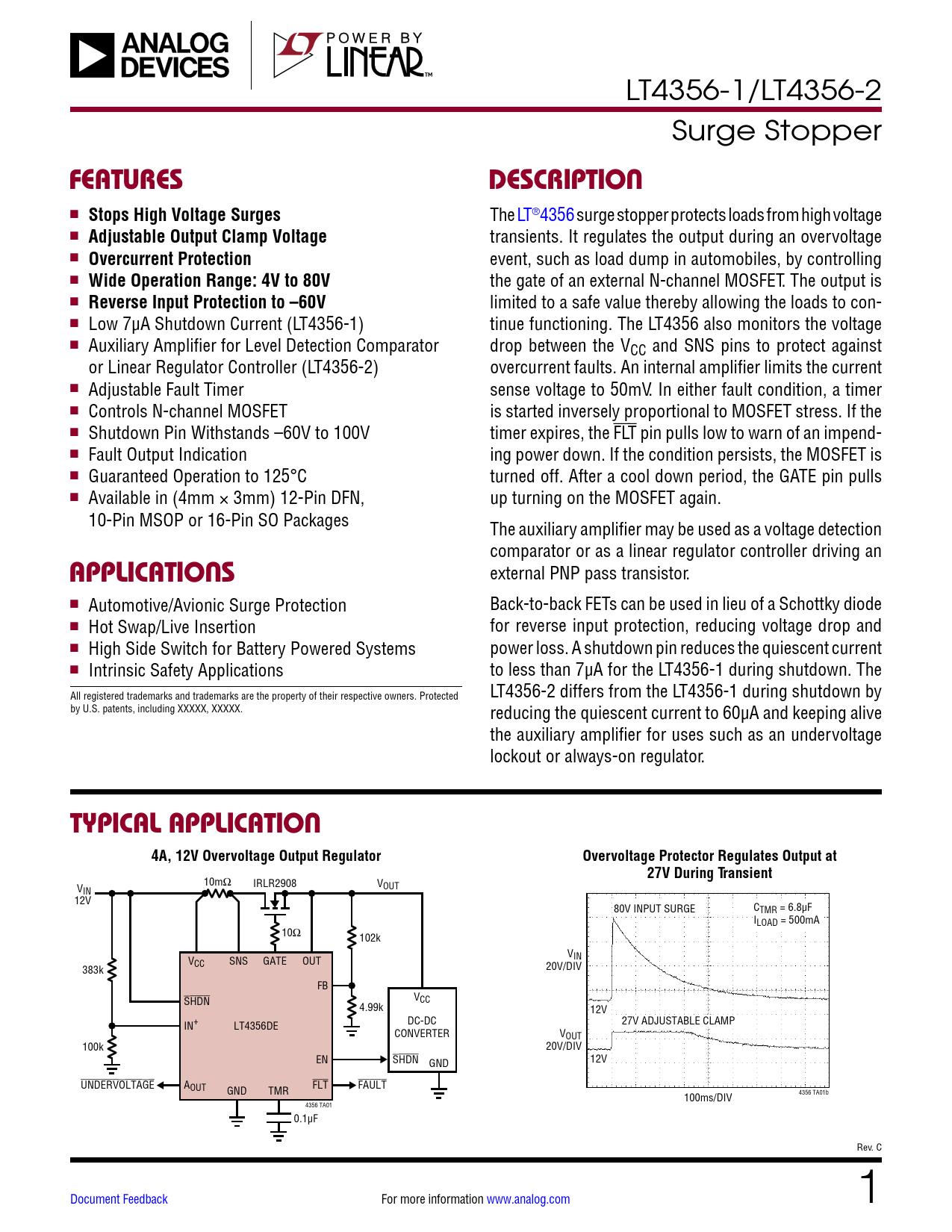

TYPICAL APPLICATION 4A, 12V Overvoltage Output Regulator Overvoltage Protector Regulates Output at 27V During Transient
10mΩ IRLR2908 V V IN OUT 12V 80V INPUT SURGE CTMR = 6.8µF ILOAD = 500mA 10Ω 102k V V IN CC SNS GATE OUT 383k 20V/DIV FB SHDN VCC 4.99k 12V IN+ LT4356DE DC-DC 27V ADJUSTABLE CLAMP CONVERTER VOUT 100k 20V/DIV EN SHDN GND 12V UNDERVOLTAGE AOUT GND TMR FLT FAULT 100ms/DIV 4356 TA01b 4356 TA01 0.1µF Rev. C Document Feedback For more information www.analog.com 1 Document Outline Features Applications Typical Application Description Absolute Maximum Ratings Pin Configuration Order Information Electrical Characteristics Typical Performance Characteristics Pin Functions Block Diagram Operation Applications Information Typical Applications Package Description Revision History Typical Application Related Parts
