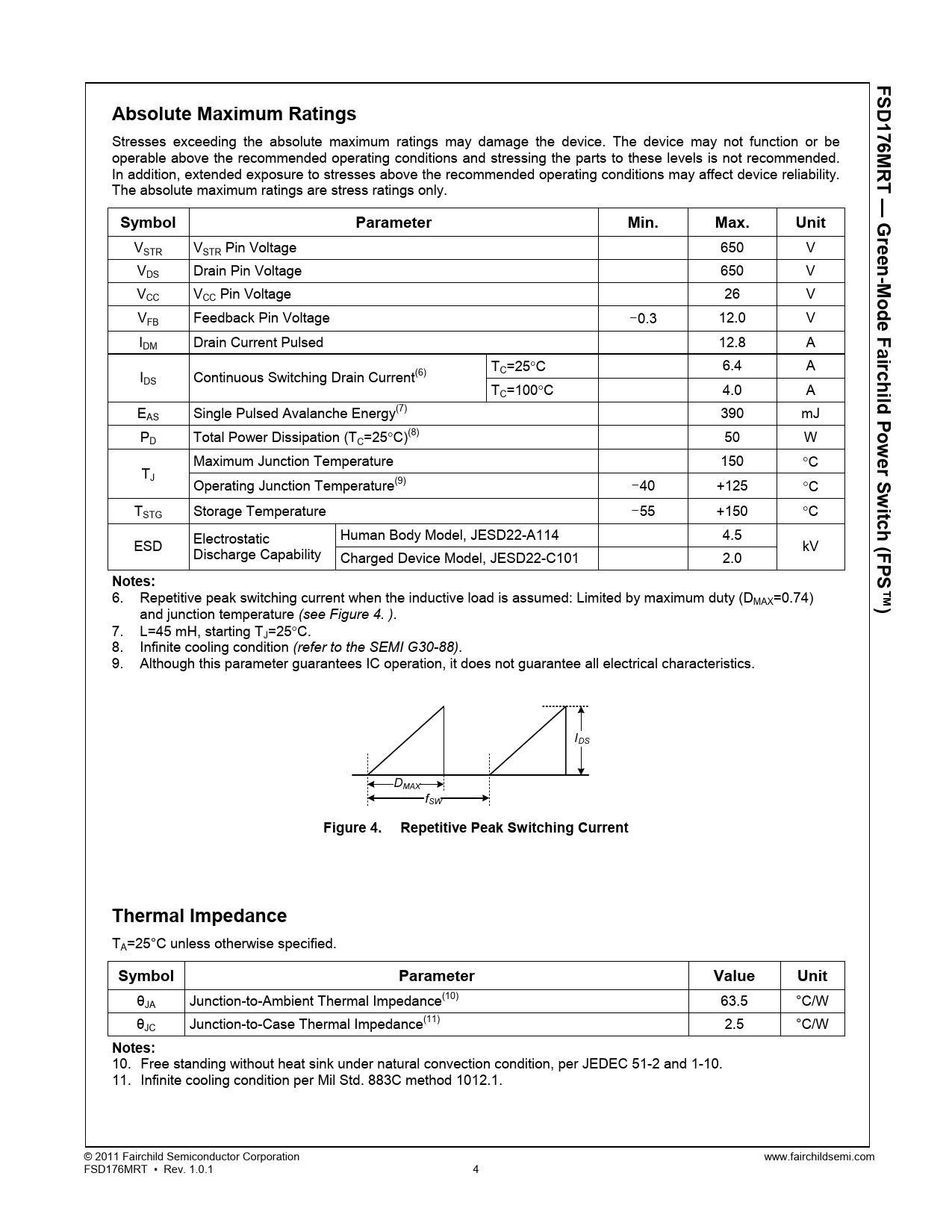

Stresses exceeding the absolute maximum ratings may damage the device. The device may not function or be
Stresses exceeding the absolute maximum ratings may damage the device The device may not function or be
operable above the recommended operating conditions and stressing the parts to these levels is not recommended.
In addition, extended exposure to stresses above the recommended operating conditions may affect device reliability.
The absolute maximum ratings are stress ratings only. Symbol Parameter Min. Max. Unit VSTR VSTR Pin Voltage 650 V VDS Drain Pin Voltage 650 V VCC VCC Pin Voltage VFB Feedback Pin Voltage IDM Drain Current Pulsed IDS Continuous Switching Drain Current(6) EAS
PD
TJ
TSTG
ESD 26 V 12.0 V 12.8 A TC=25°C 6.4 A TC=100°C 4.0 A 390 mJ -0.3 (7) Single Pulsed Avalanche Energy Total Power Dissipation (TC=25°C) (8) Maximum Junction Temperature 50 W 150 °C Operating Junction Temperature(9) -40 +125 °C Storage Temperature -55 +150 °C Electrostatic
Discharge Capability Human Body Model, JESD22-A114 4.5 Charged Device Model, JESD22-C101 2.0 kV Notes:
6. Repetitive peak switching current when the inductive load is assumed: Limited by maximum duty (DMAX=0.74)
and junction temperature (see Figure 4. ).
7. L=45 mH, starting TJ=25°C.
8. Infinite cooling condition (refer to the SEMI G30-88).
9. Although this parameter guarantees IC operation, it does not guarantee all electrical characteristics. Figure 4. FSD176MRT — Green-Mode Fairchild Power Switch (FPS™) Absolute Maximum Ratings Repetitive Peak Switching Current Thermal Impedance
TA=25°C unless otherwise specified. Symbol Parameter
(10) θJA Junction-to-Ambient Thermal Impedance θJC (11) Junction-to-Case Thermal Impedance Value Unit 63.5 °C/W 2.5 °C/W Notes:
10. Free standing without heat sink under natural convection condition, per JEDEC 51-2 and 1-10.
11. Infinite cooling condition per Mil Std. 883C method 1012.1. © 2011 Fairchild Semiconductor Corporation
