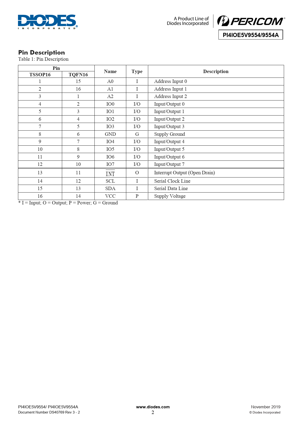

PI4IOE5V9554/9554A Pin Description
Table 1: Pin Description
Pin Name Type Description TSSOP16 TQFN16
1 15 A0 I Address Input 0 2 16 A1 I Address Input 1 3 1 A2 I Address Input 2 4 2 IO0 I/O Input/Output 0 5 3 IO1 I/O Input/Output 1 6 4 IO2 I/O Input/Output 2 7 5 IO3 I/O Input/Output 3 8 6 GND G Supply Ground 9 7 IO4 I/O Input/Output 4 10 8 IO5 I/O Input/Output 5 11 9 IO6 I/O Input/Output 6 12 10 IO7 I/O Input/Output 7 13 11 INT O Interrupt Output (Open Drain) 14 12 SCL I Serial Clock Line 15 13 SDA I Serial Data Line 16 14 VCC P Supply Voltage * I = Input; O = Output; P = Power; G = Ground PI4IOE5V9554/ PI4IOE5V9554A
